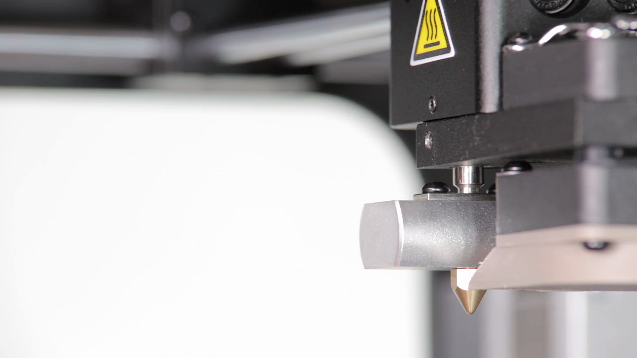

Hotend Requirements
Use a separate hotend that will be dedicated only for printing with Z-PLA Pro. The hotend should be new and not used with other materials during different projects.
Unload Z-PLA Pro from the hotend immediately after the printing process. Do not keep the overheated material loaded in the extruder to avoid material degradation in the nozzle.
