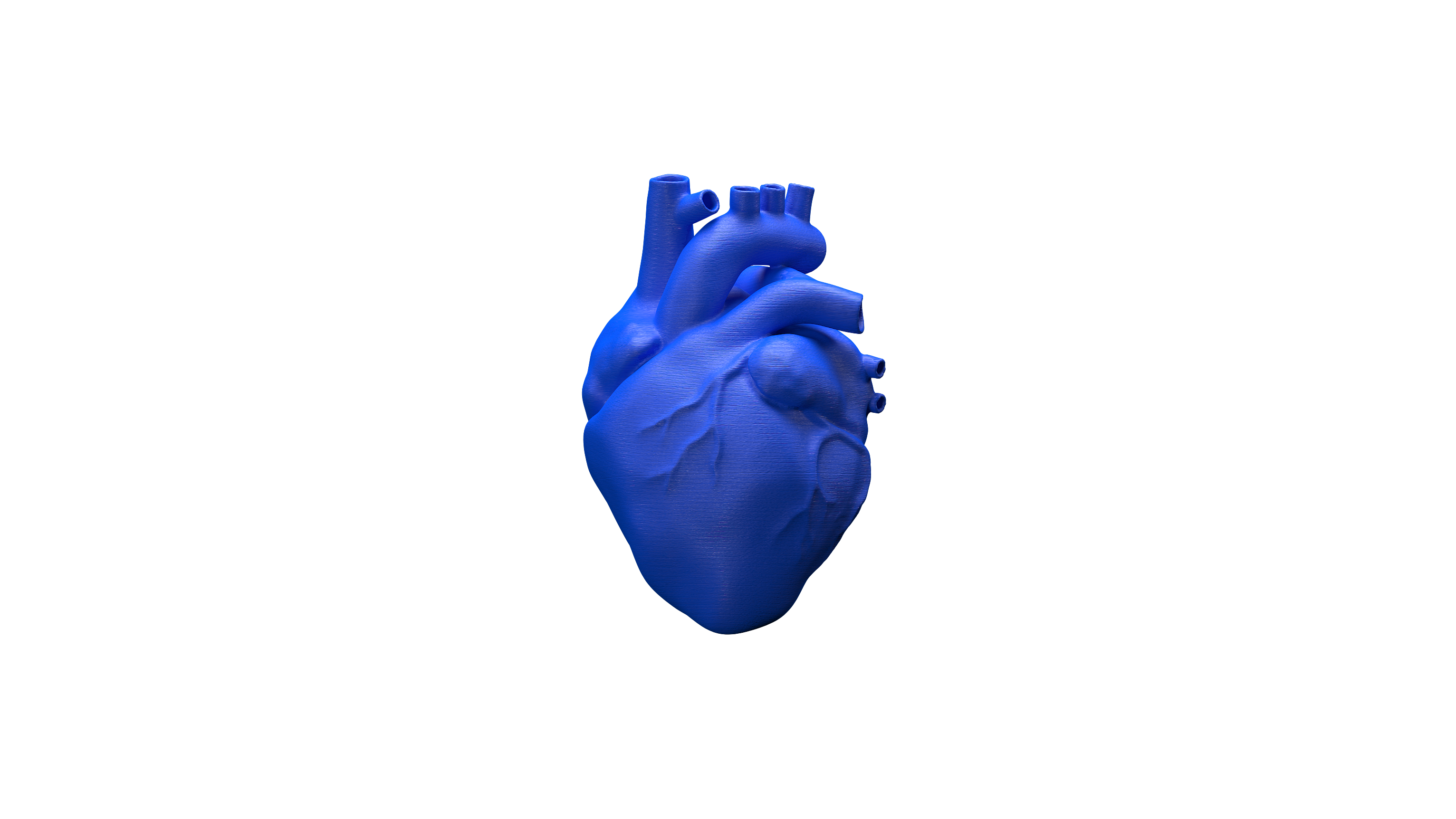

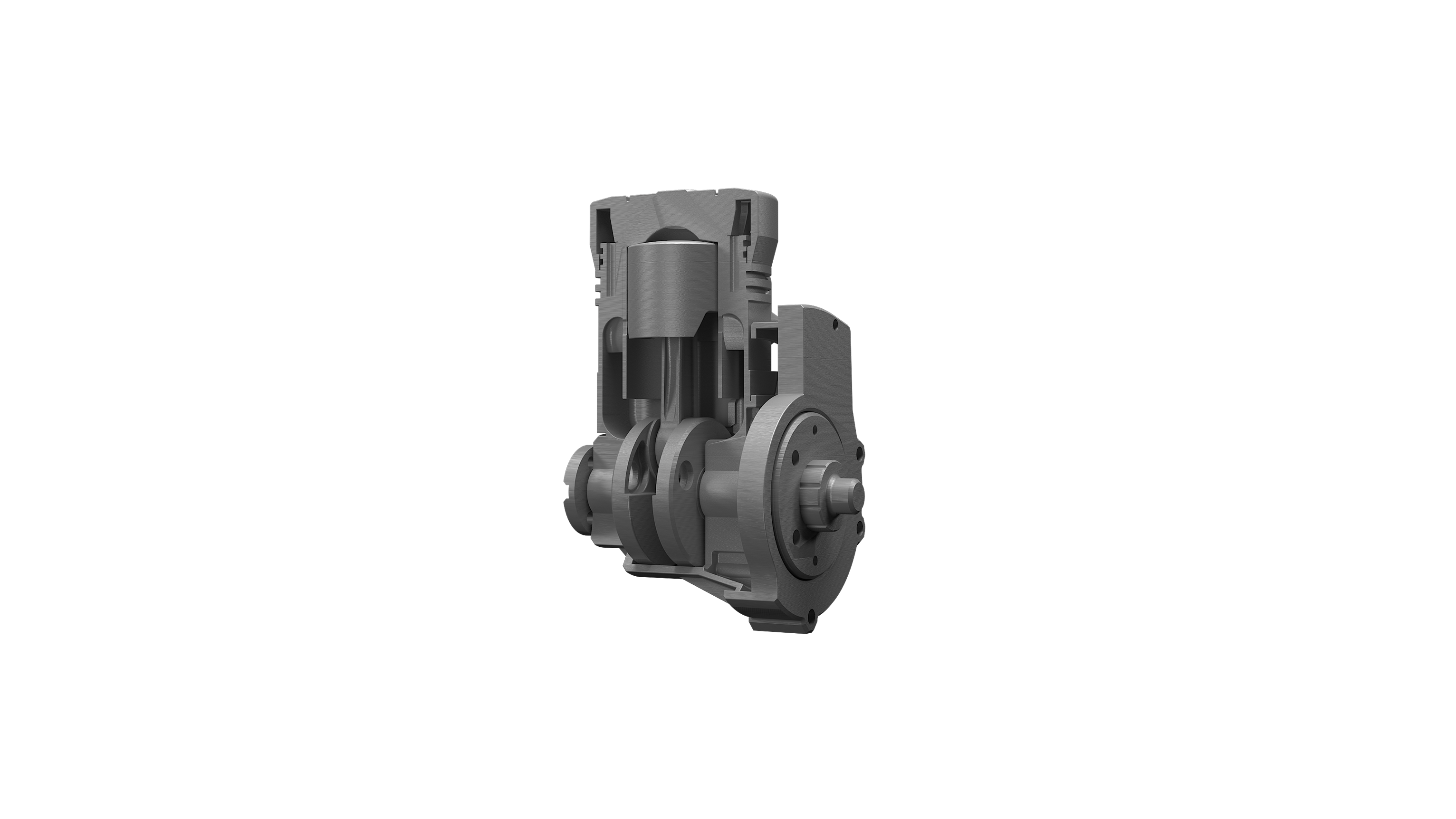

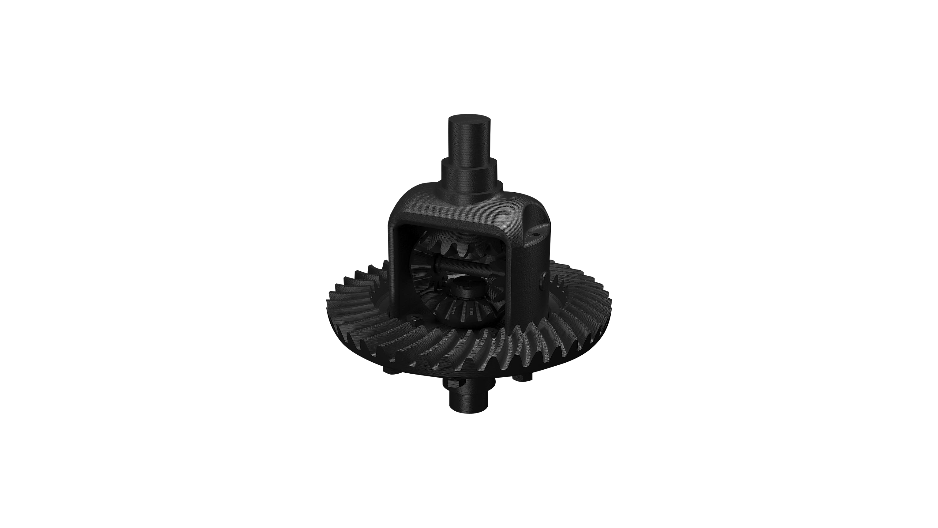

Inventure Models
The Inventure’s design, which includes the dual-extrusion system and a closed chamber, gives you a possibility to 3D print complex, movable objects in high quality which show the finest details. Even the most complicated projects can be turned into items that can be easily adapted in many industries – from heat-resistant automotive parts, conceptual models and elements that can be exposed to many external factors to decorative elements.
You can obtain models with the most intricate designs. Since the support structures are dissolvable in heated water, you won’t have any problems with removing the remains.
This gallery shows what types of models are achievable with the Inventure.
