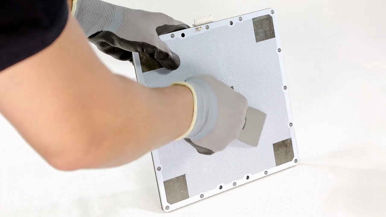

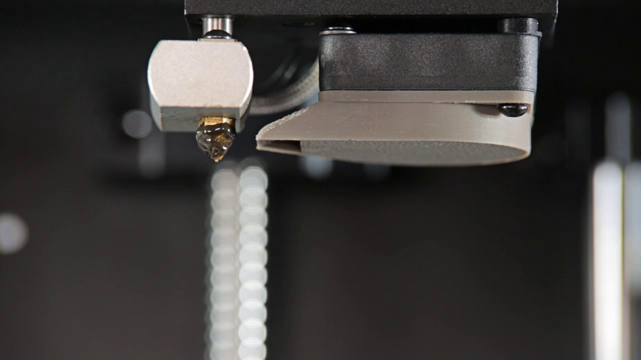

Sometimes the electrical circuit in the printer cannot be completed due to material remains on the nozzle or the perforated plate.
In this case, clean both parts with a spatula. See the manuals: nozzle cleaning, platform maintenance [M200 Plus], platform maintenance [M200].
