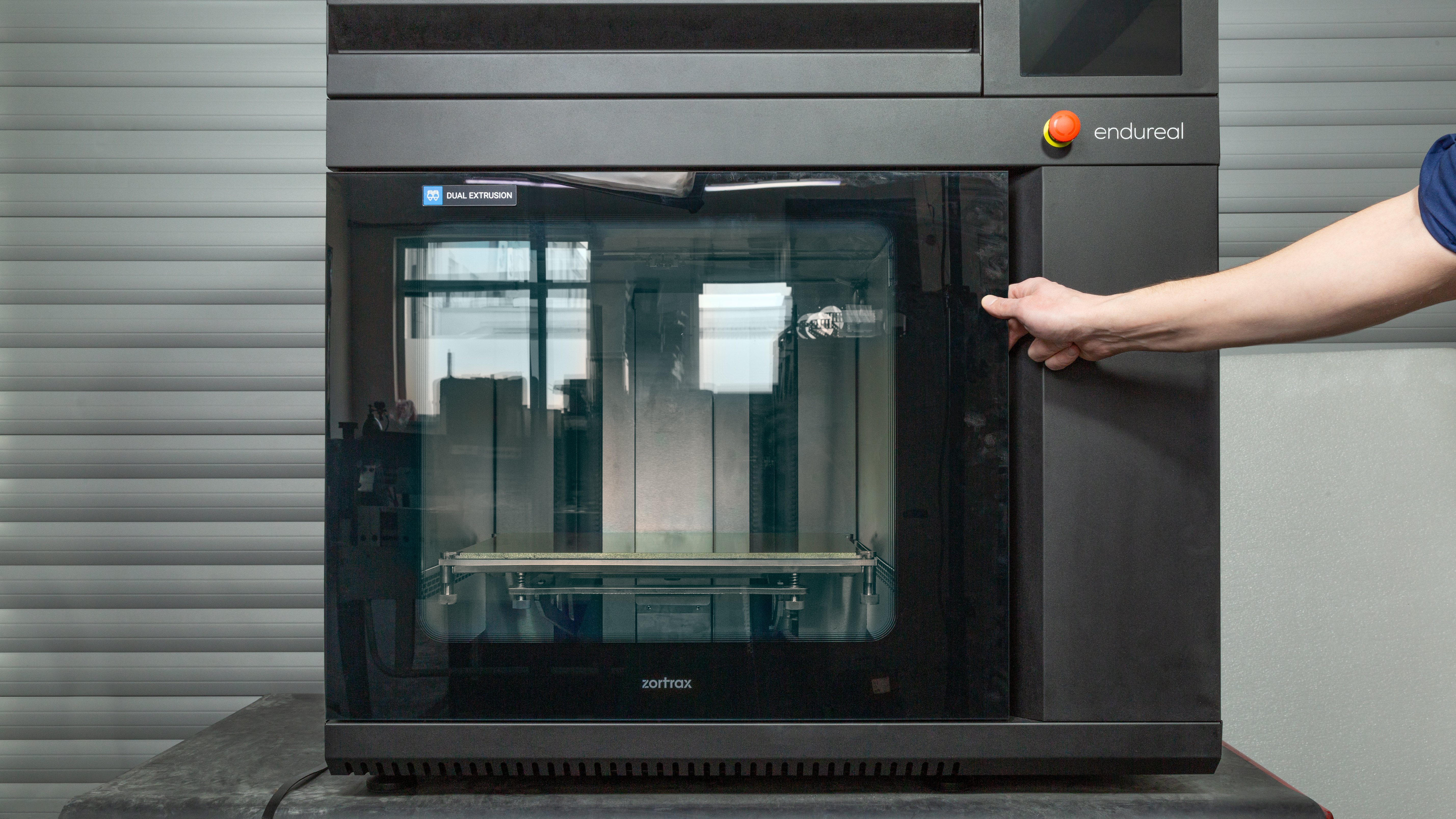

– Open the front door.

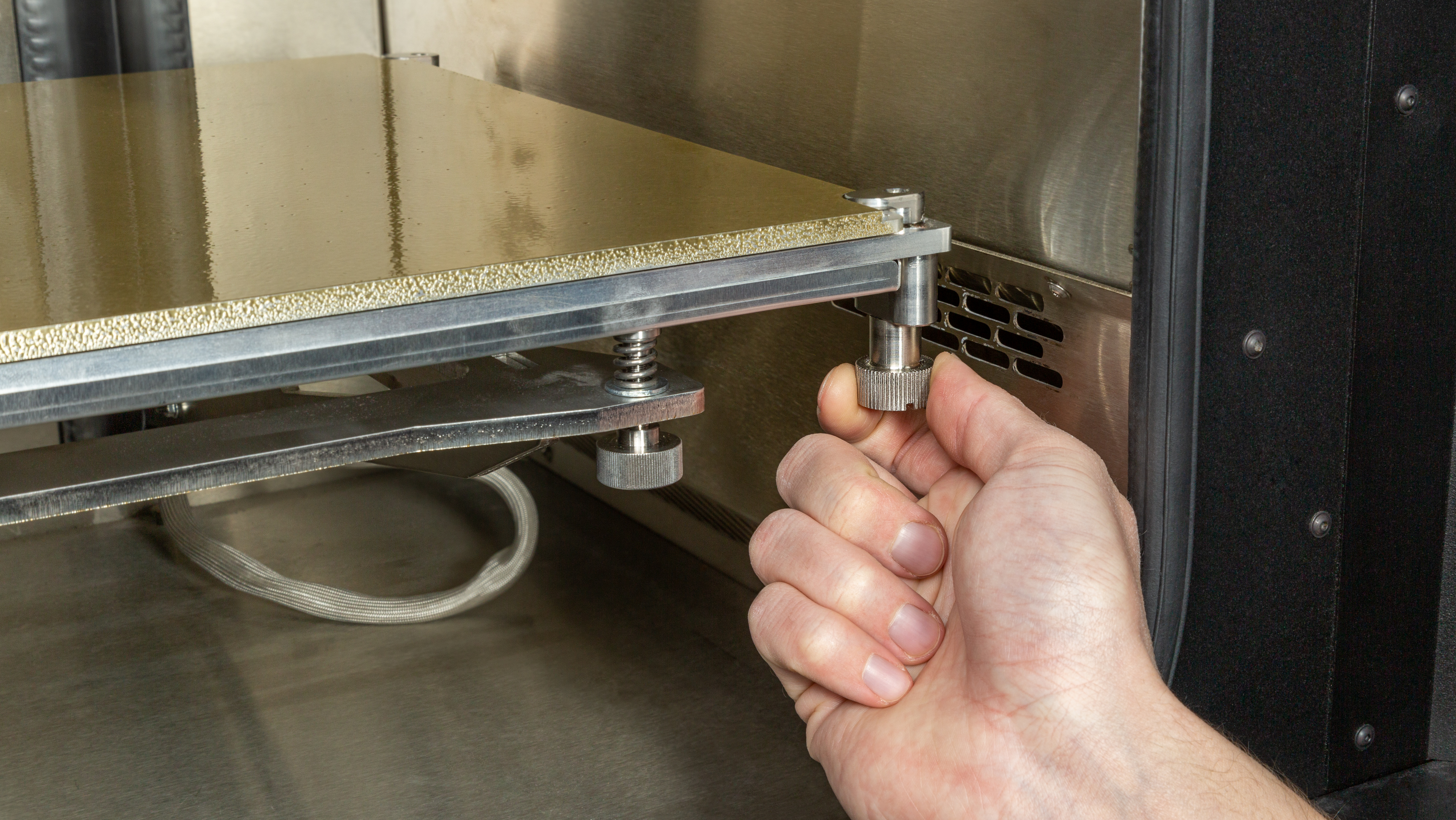

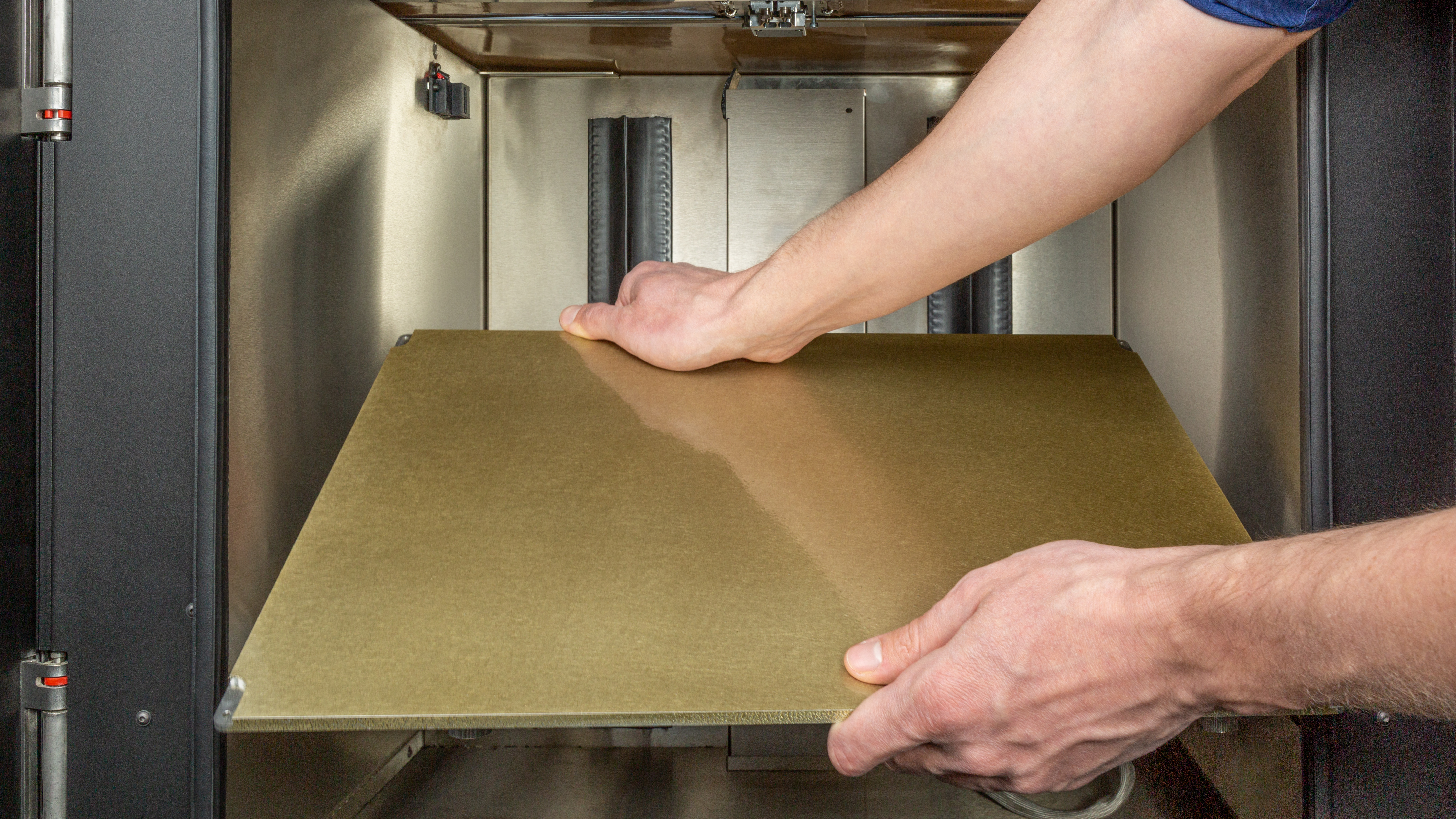

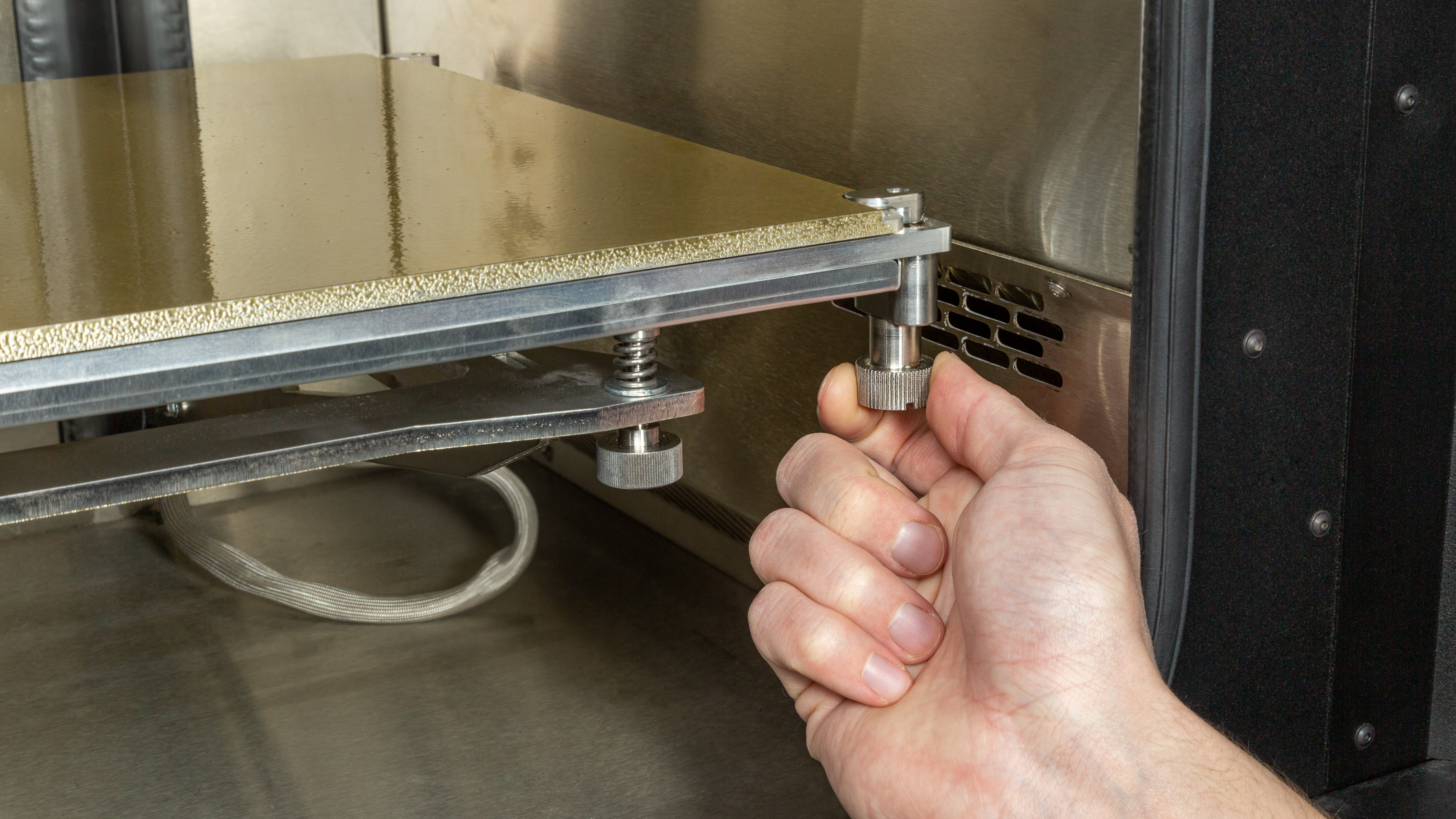

Plate removal
Loosen the four screws that secure the PEI plate, and turn the corner locks by 90°. Next, remove the plate.

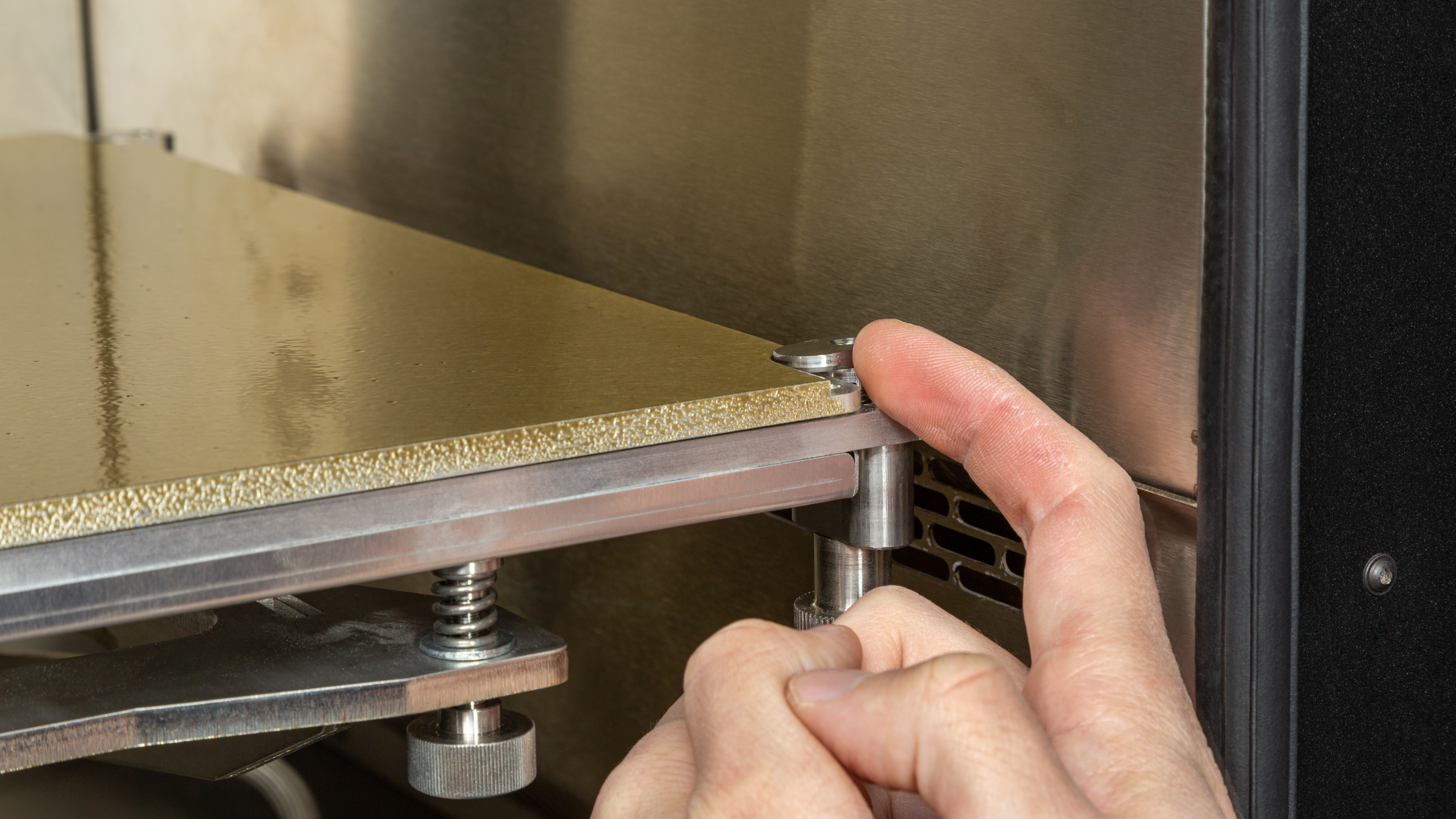

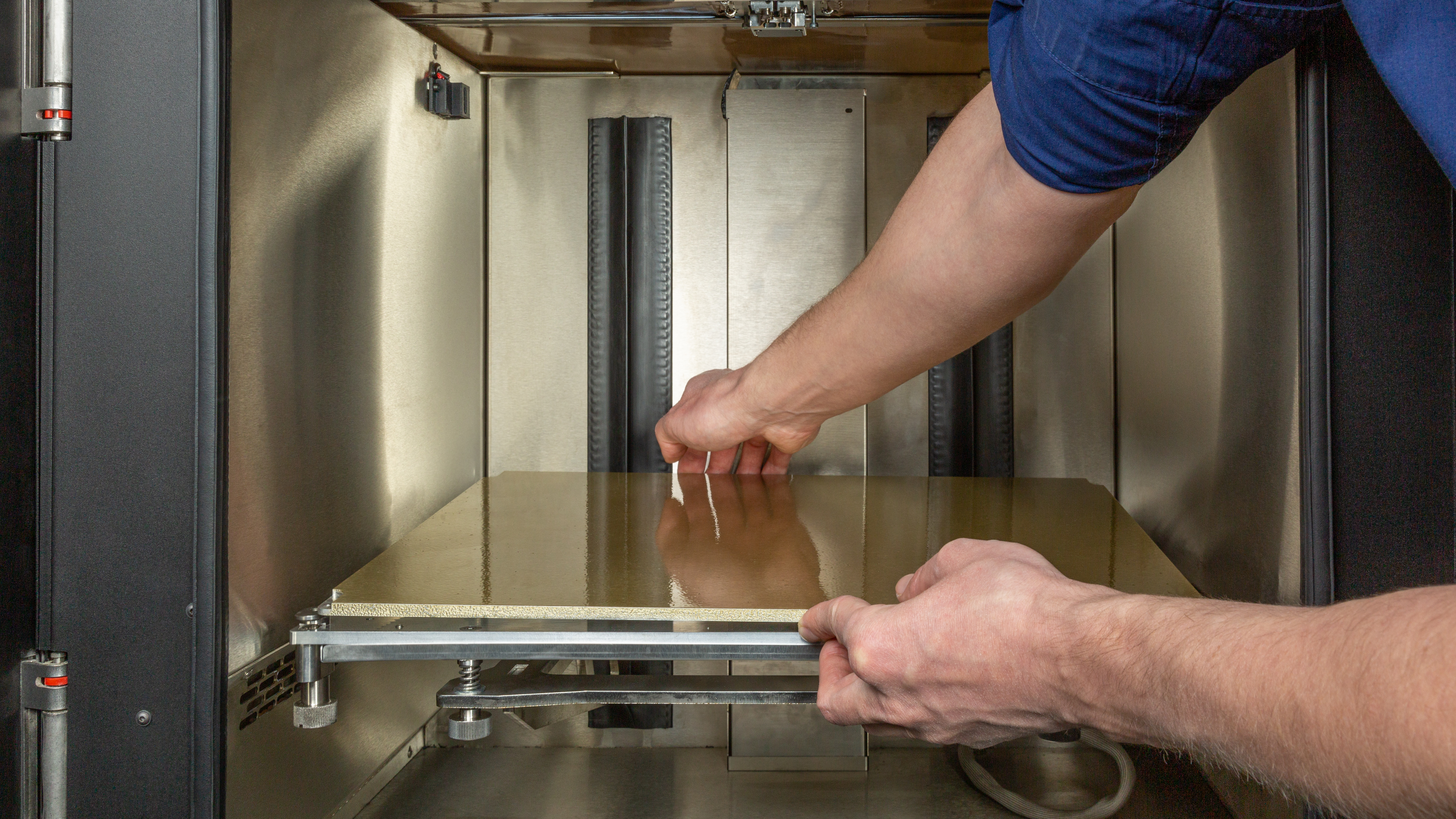

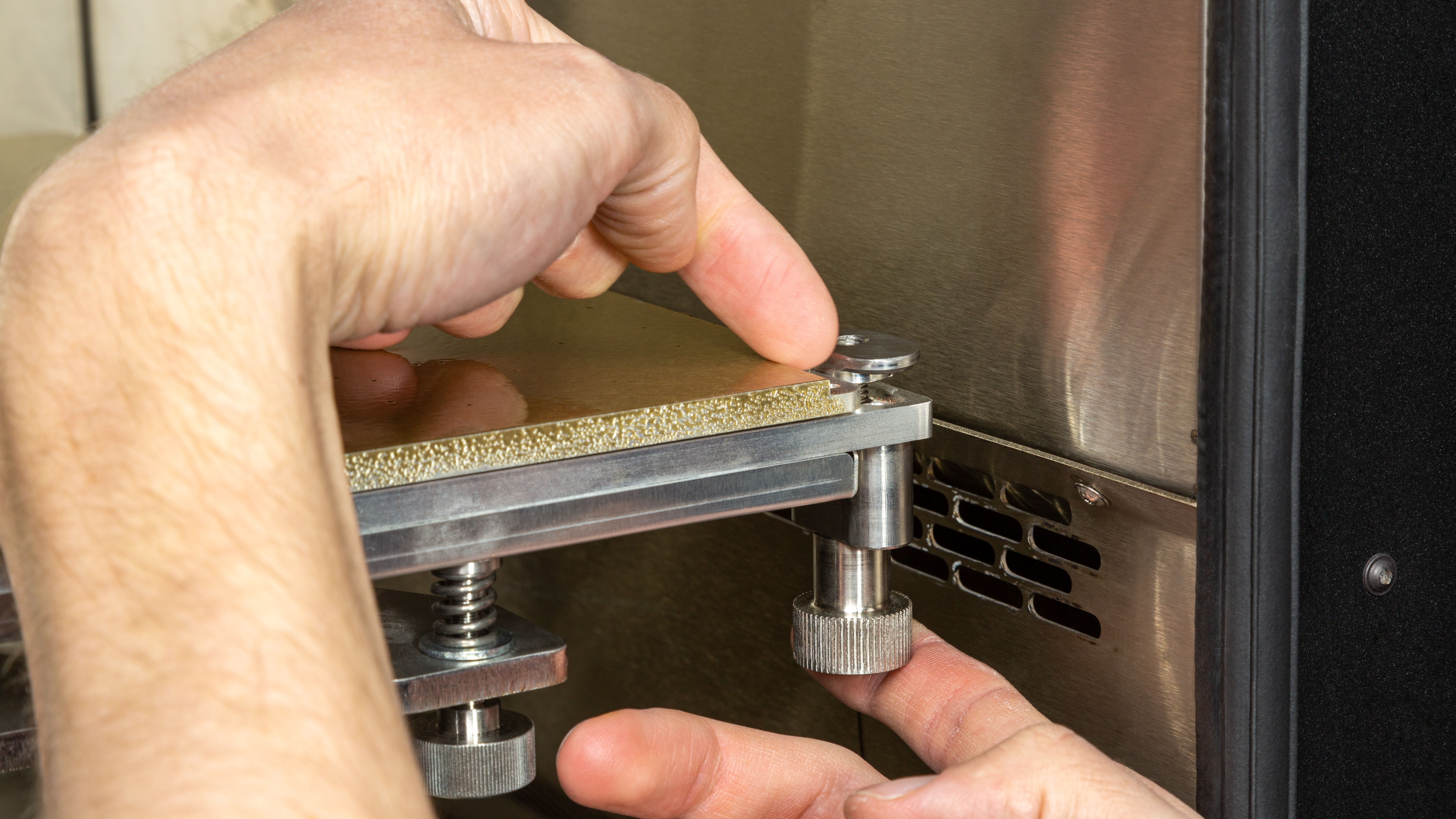

Plate Installation
Place the new plate on the heatbed. Turn the corner locks by 90°, and tighten the four screws.

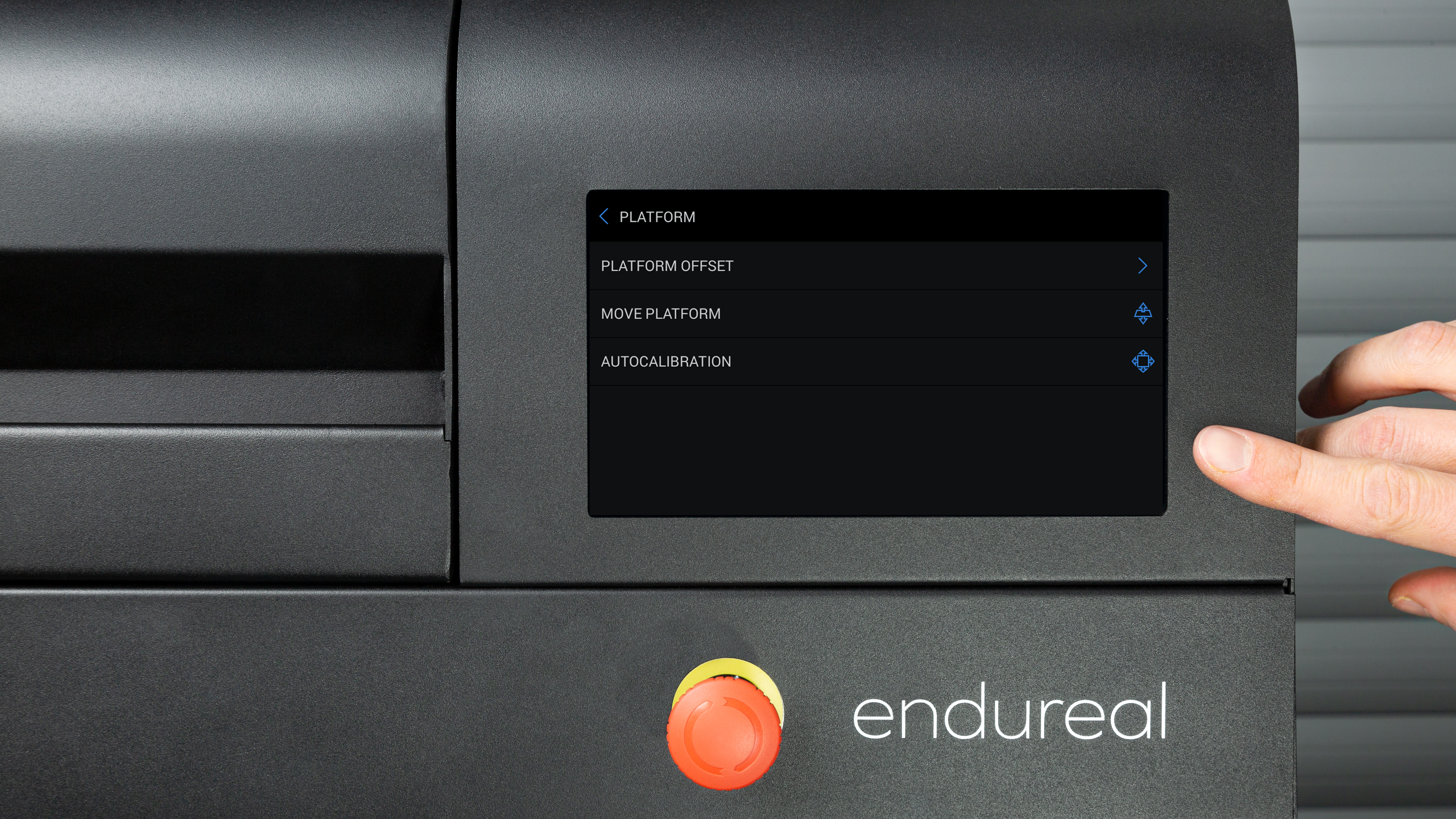

Platform Calibration
Calibrate the platform. Open the Tools menu and select Platform, and Autocalibration. Follow the instructions displayed on the screen.

Closing the Front Door
Close the front door.
