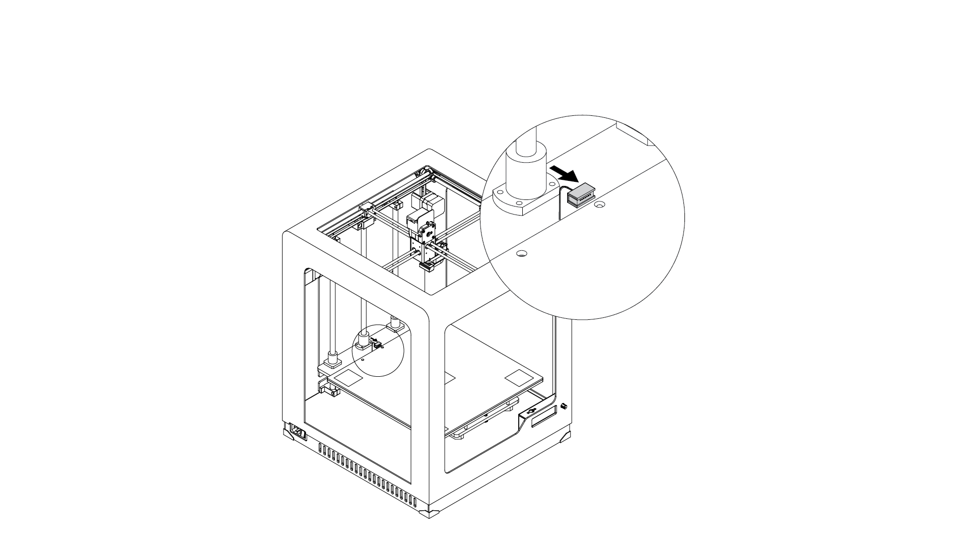

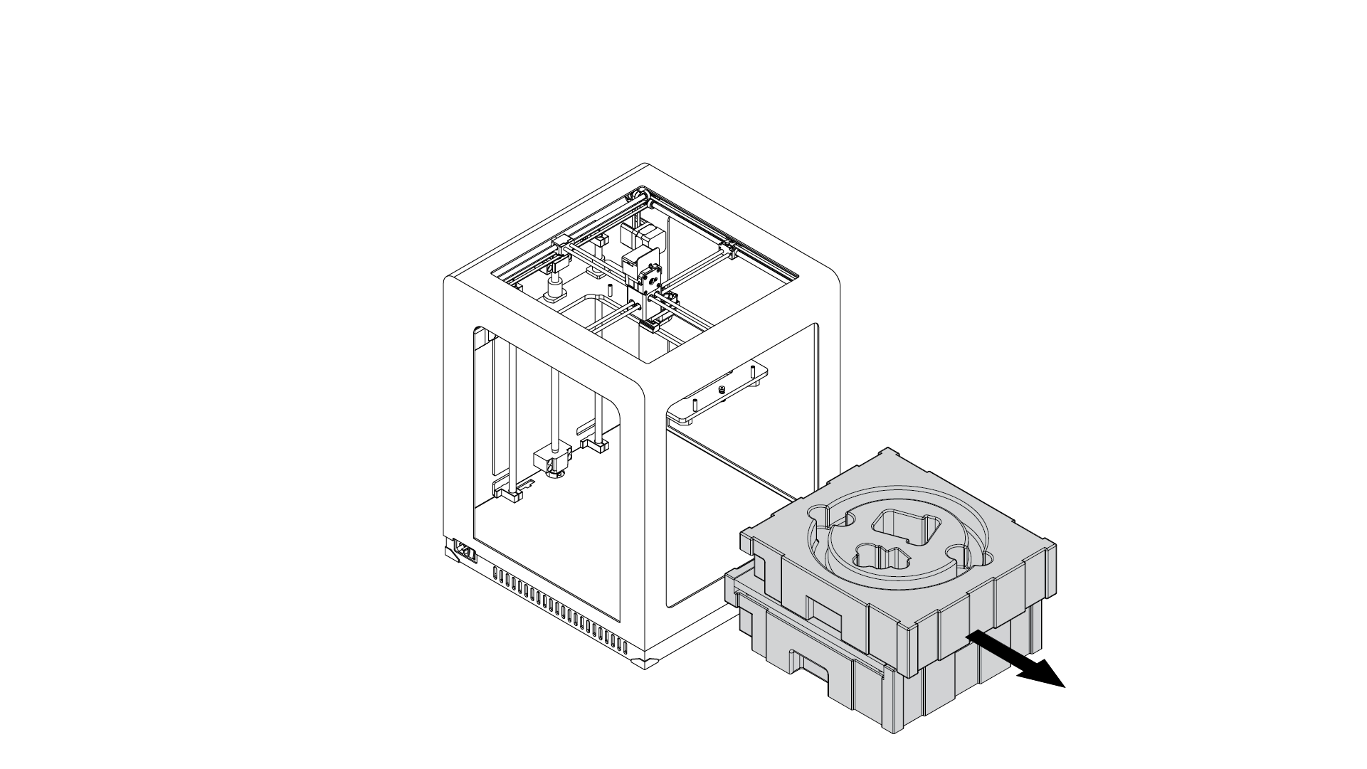

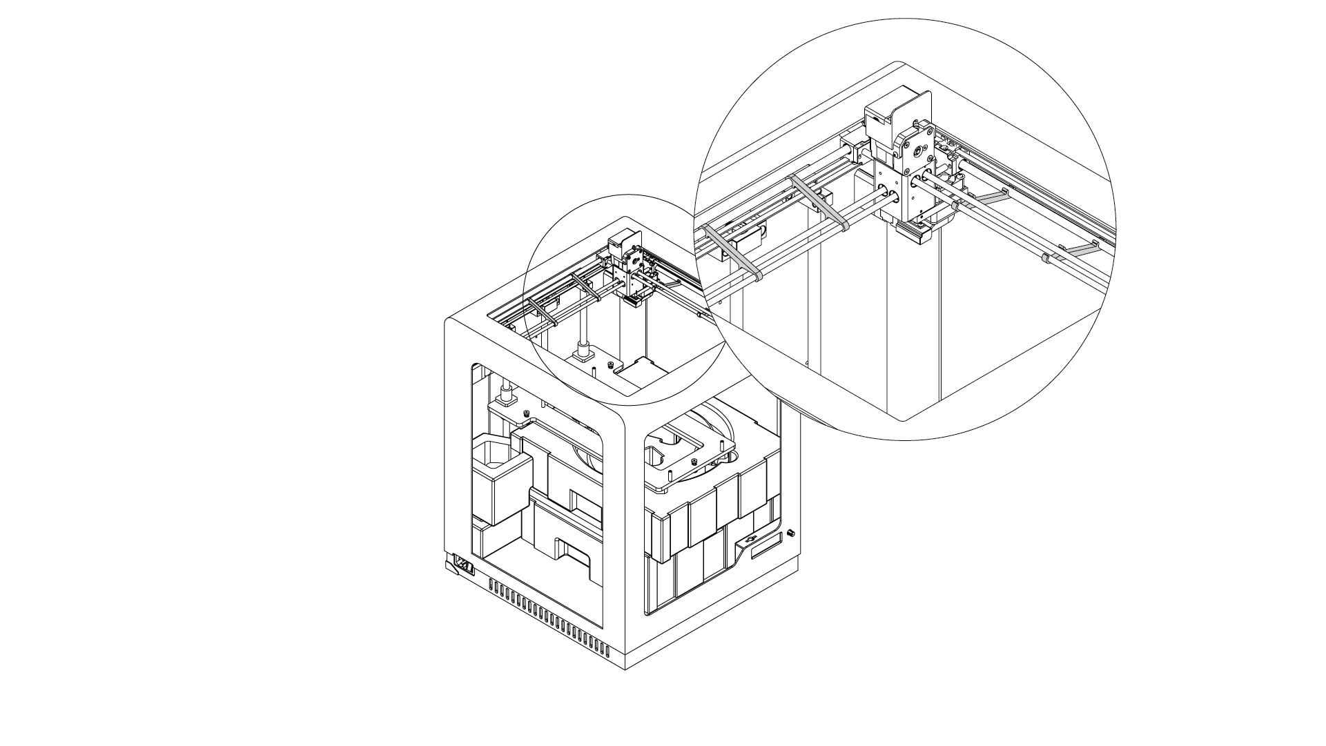

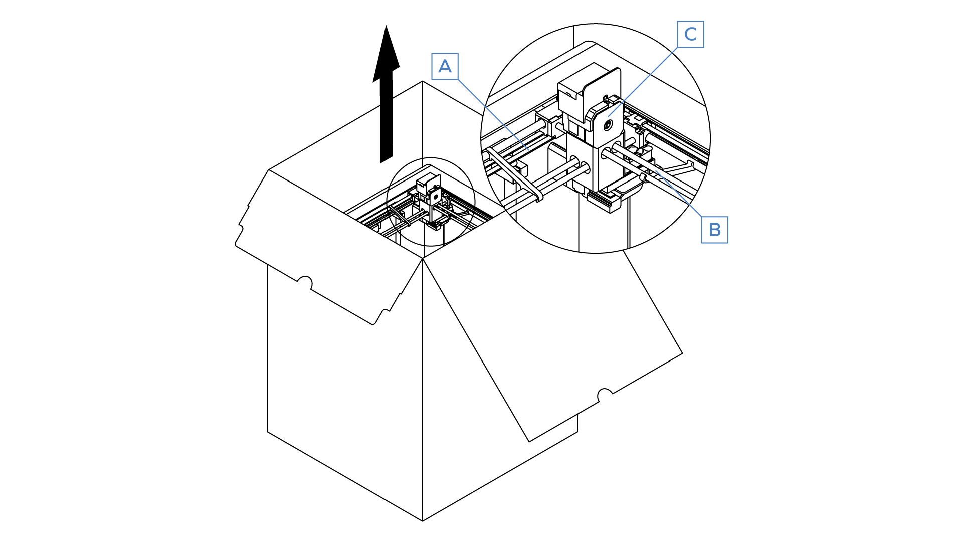

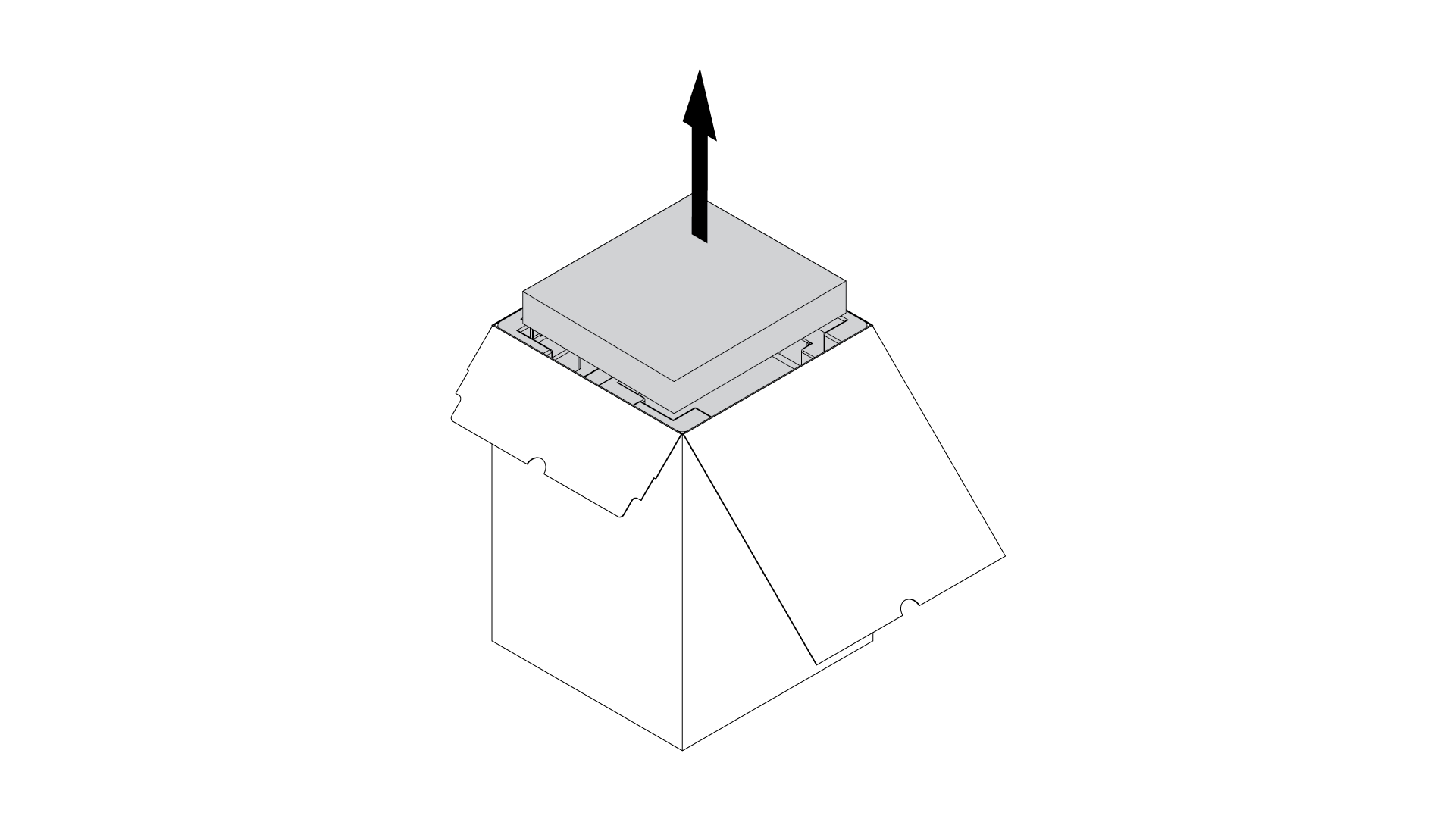

Take the 3D printer out of the box. Bearing in mind the printer’s weight (30kg), the M300 should be taken out of the box by two people.
When lifting or moving the printer, do not grab:
- the belts
- the shipping clips
- the extruder

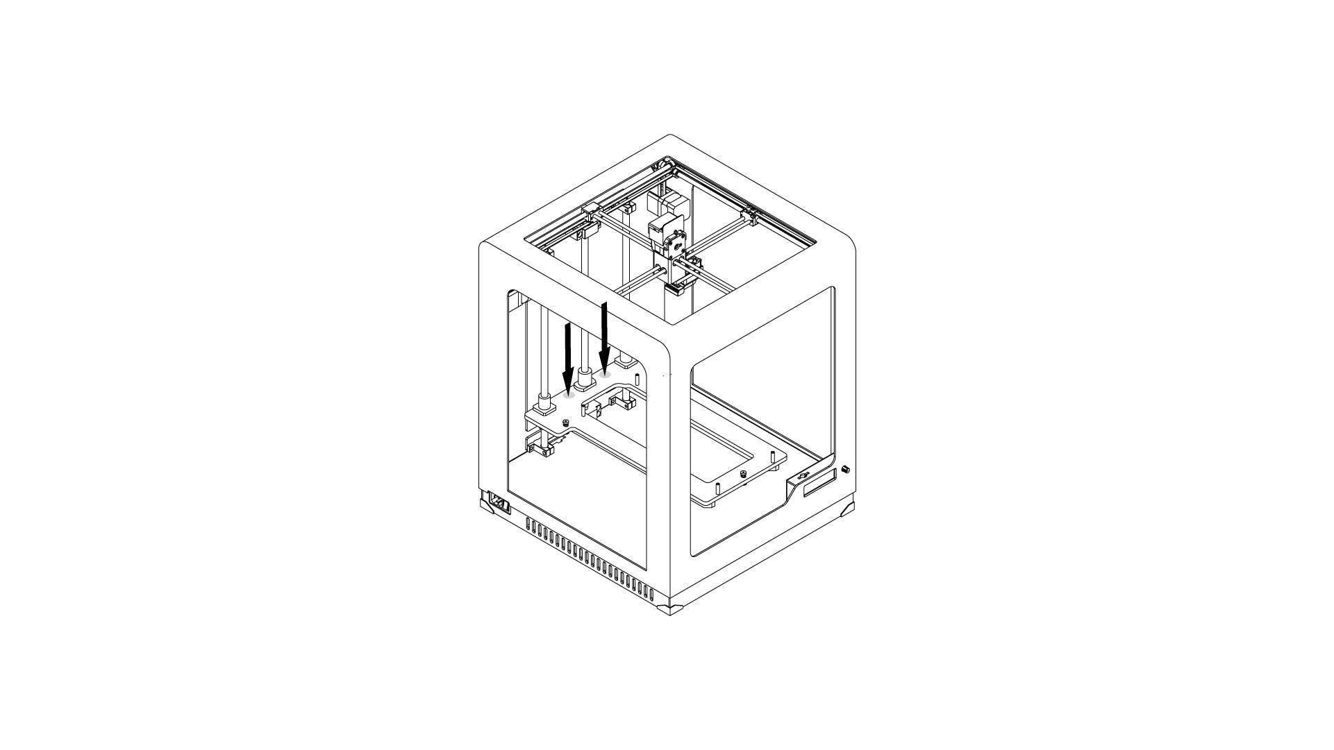

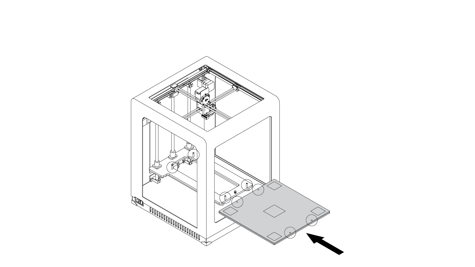

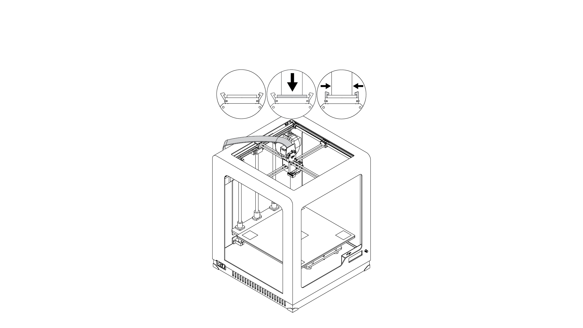

Install the build platform onto the bolts marked in the picture.

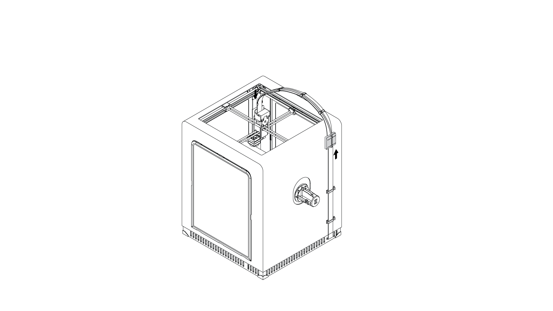

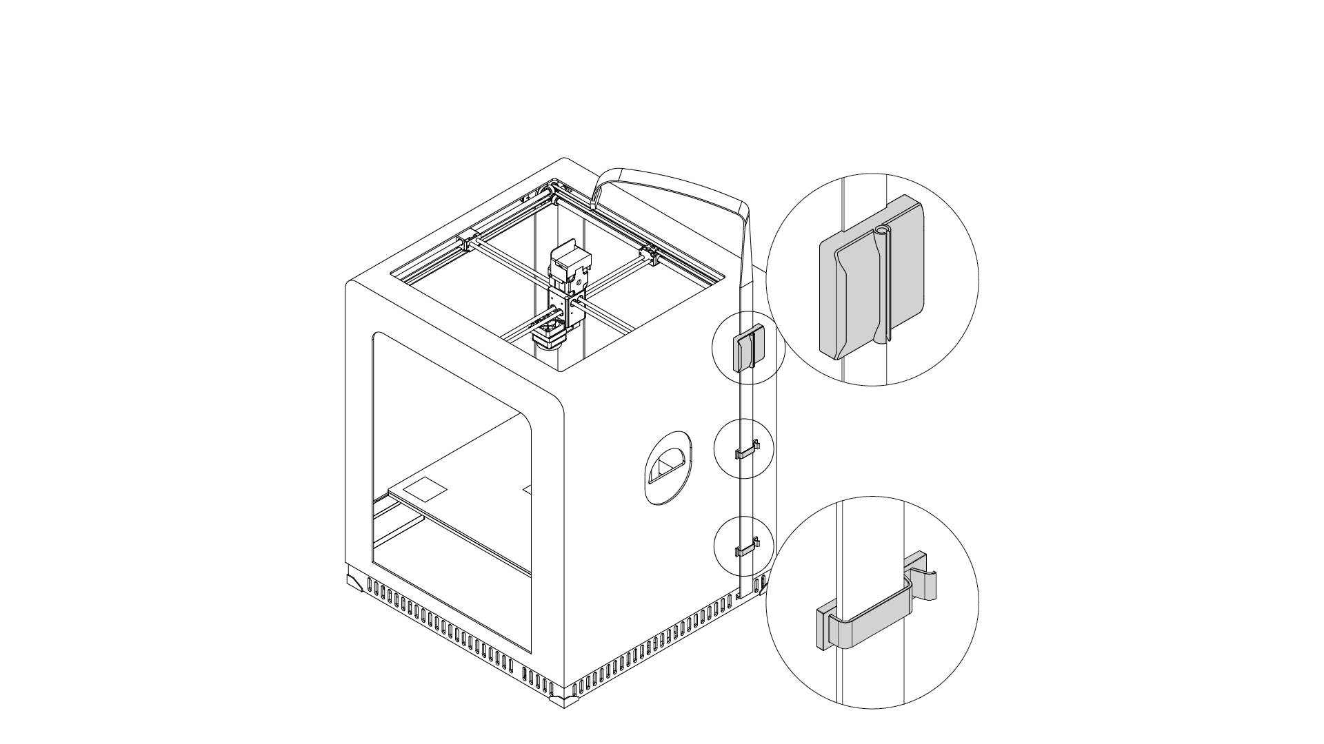

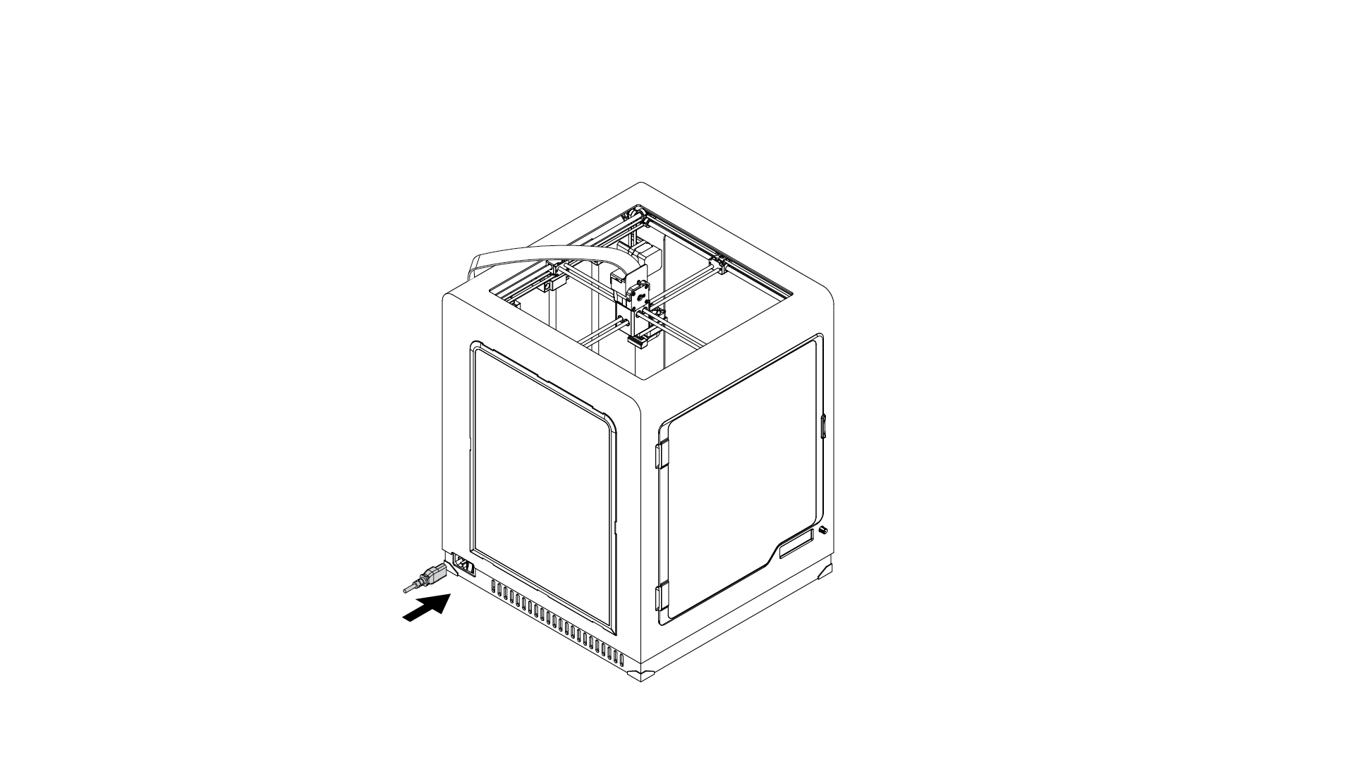

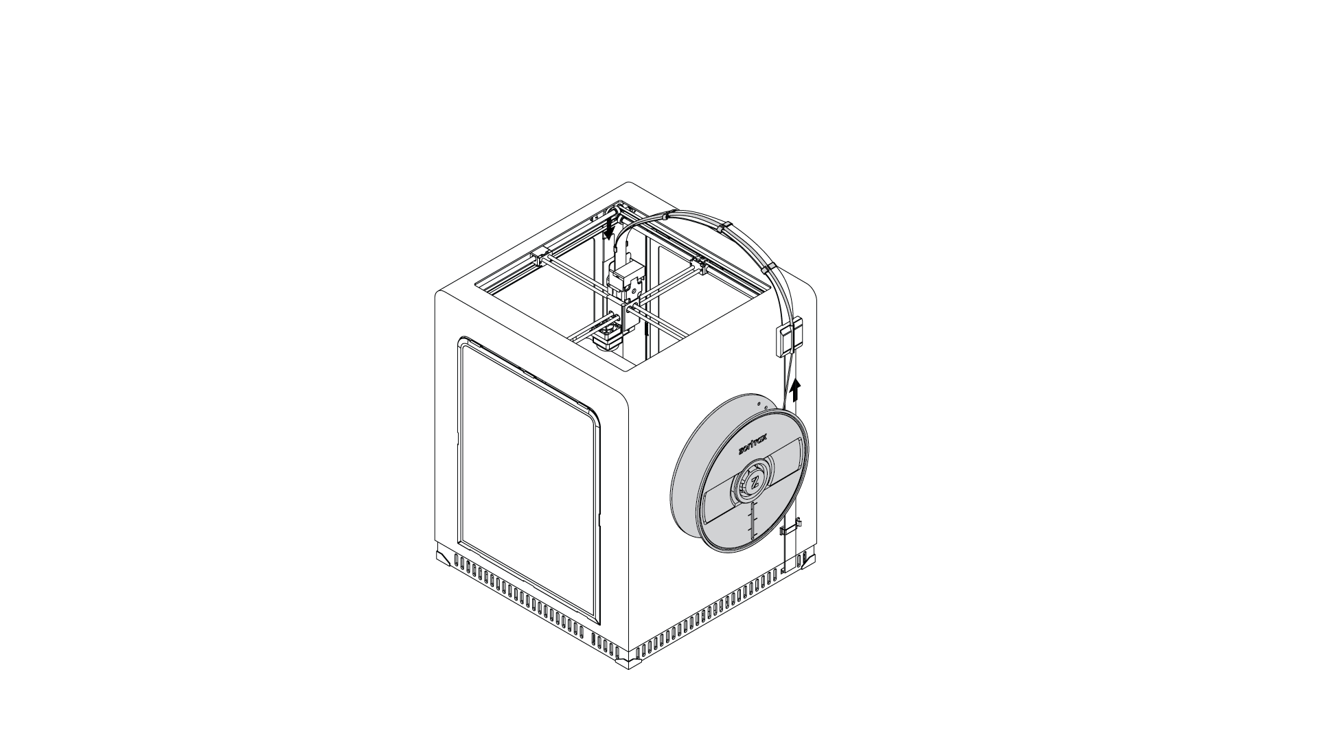

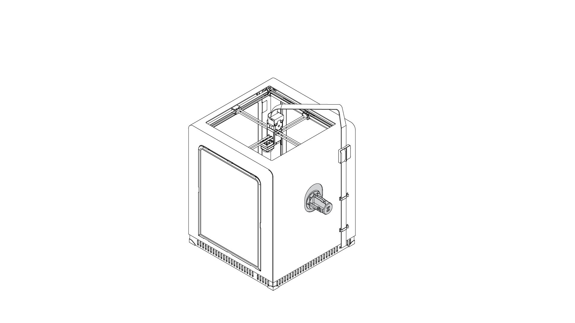

Attach the extruder cable clamps on the back of the printer. The upper clamp also holds the material guide. Place the extruder cable in the lower clamps.

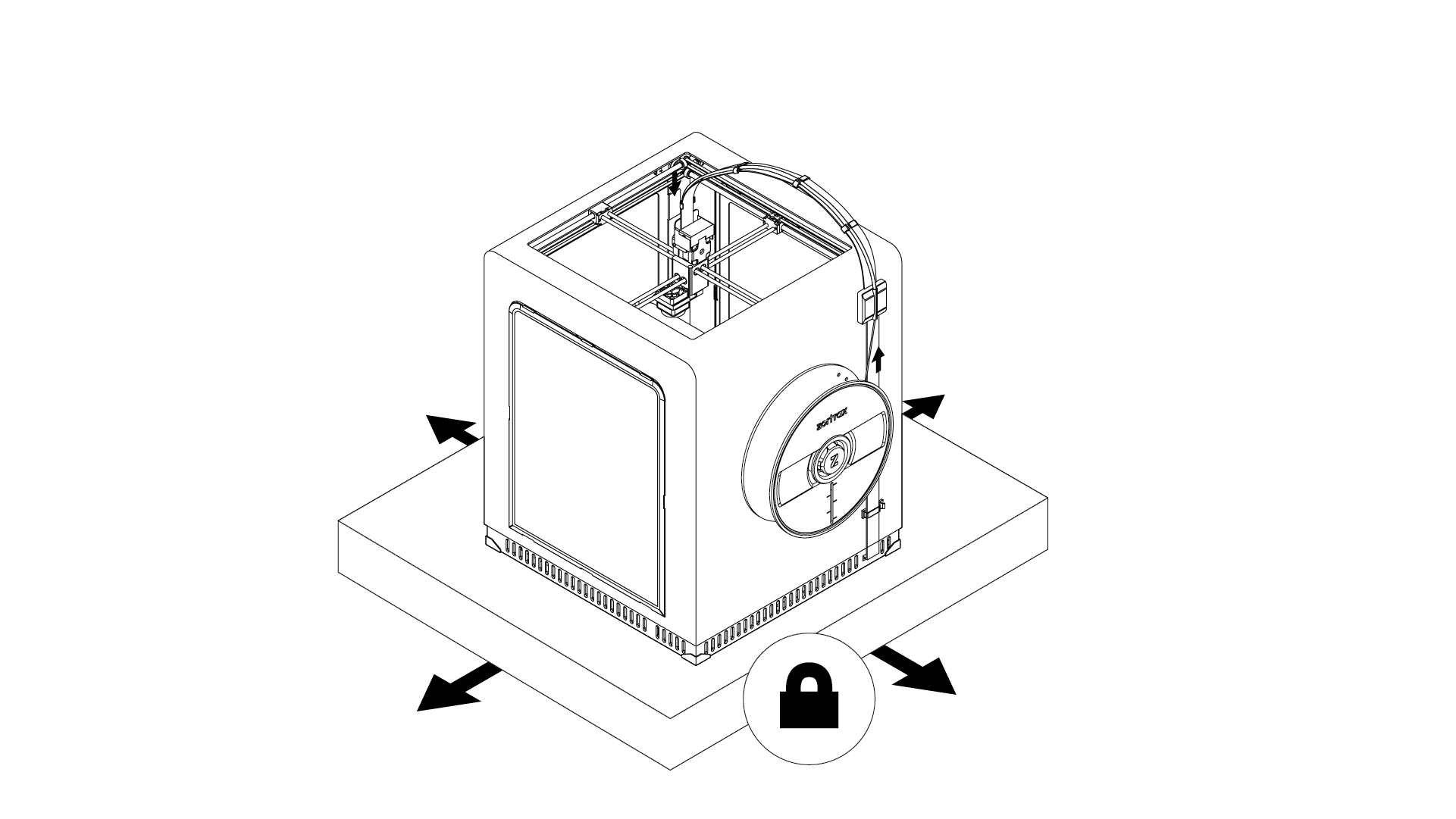

Place the material spool onto the spool holder. The spool should rotate anti-clockwise. Feed the material into the extruder through the material guide.

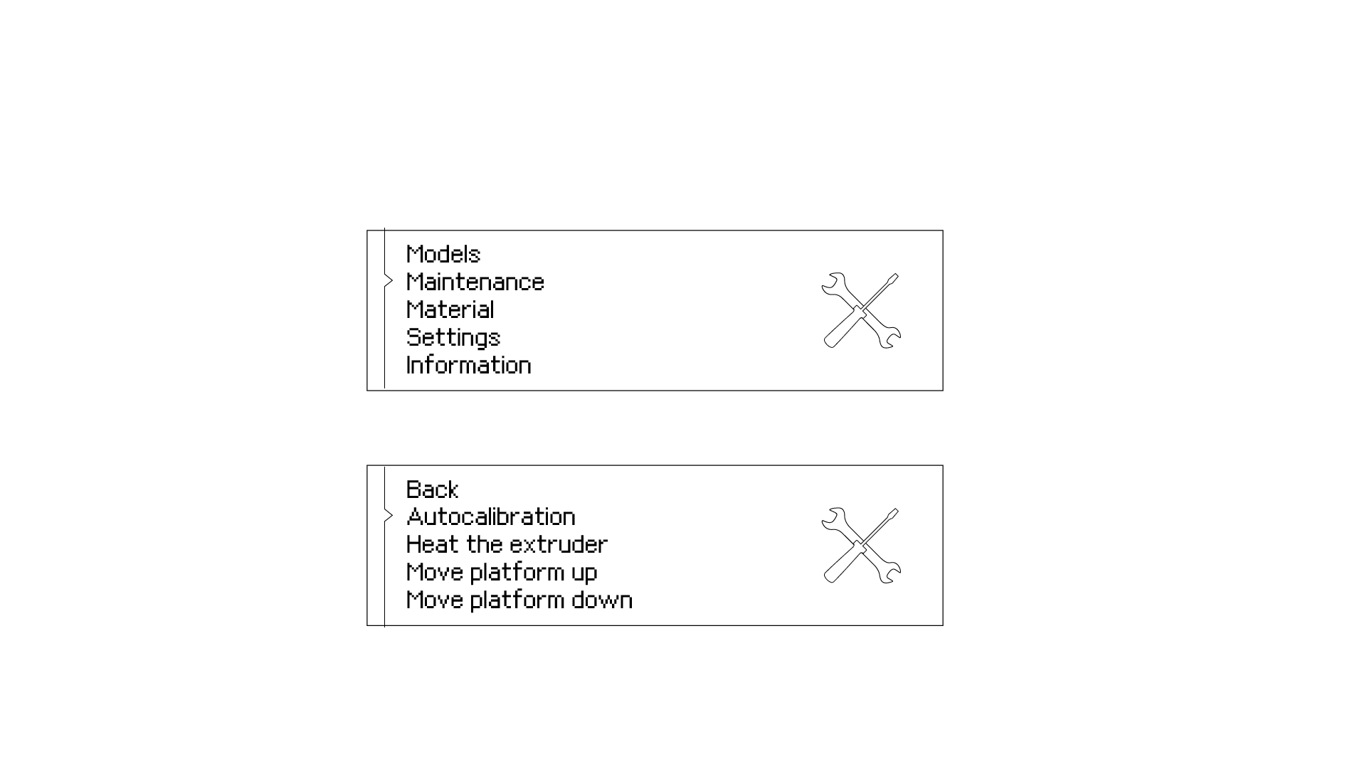

Select the “Material” option from the menu. To load the material, select the “Load the material” option.
When the display shows the message “Insert new material,” insert the end of the material into the extruder and push the knob.
