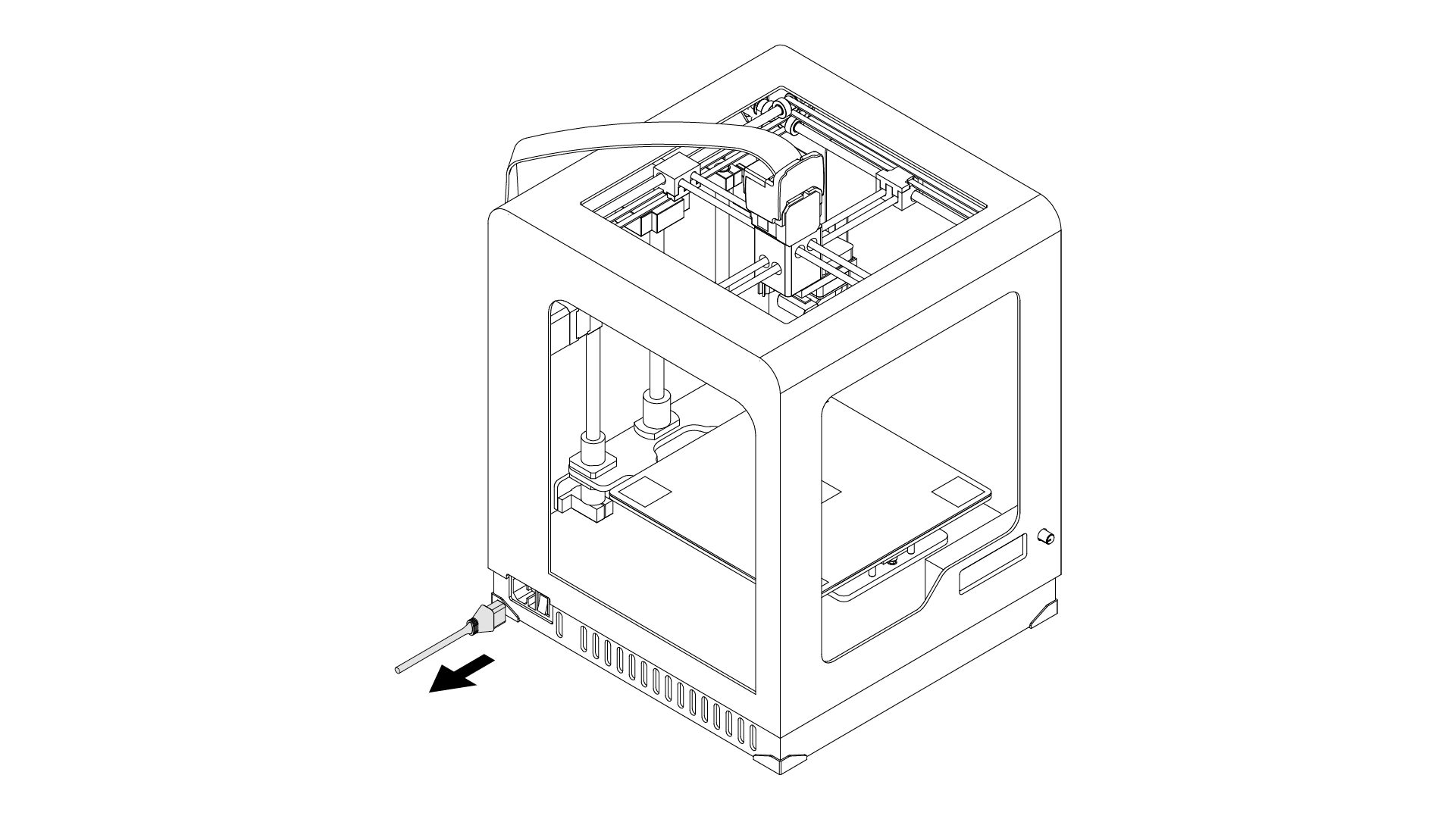

Unplugging the Power Cable
Turn off the printer, unplug the power cable and wait until the printer cools down.
Unplugging the Extruder Cable
Unplug the extruder cable.

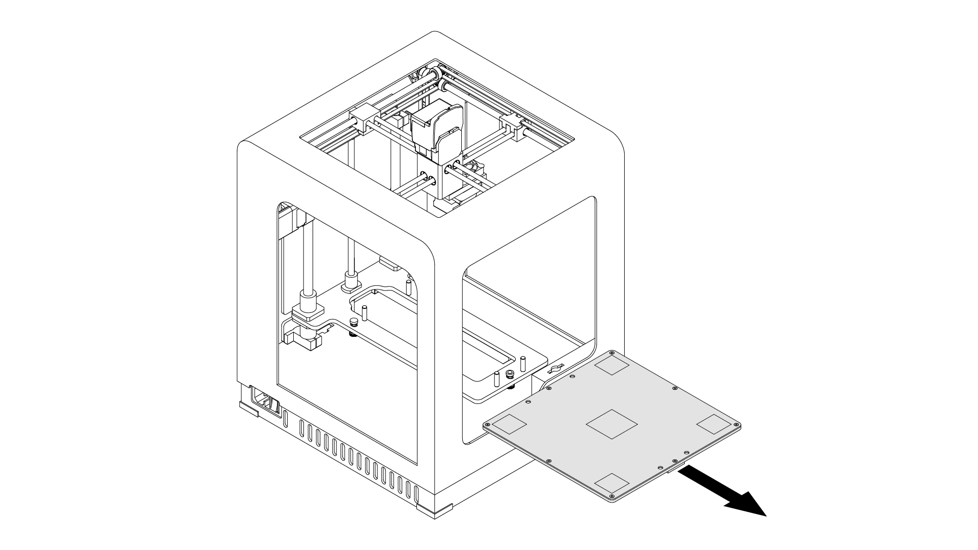

Removing the Platform
Unplug the heatbed cable. Both big and small connectors need to be unplugged. Remove the platform from the printer.

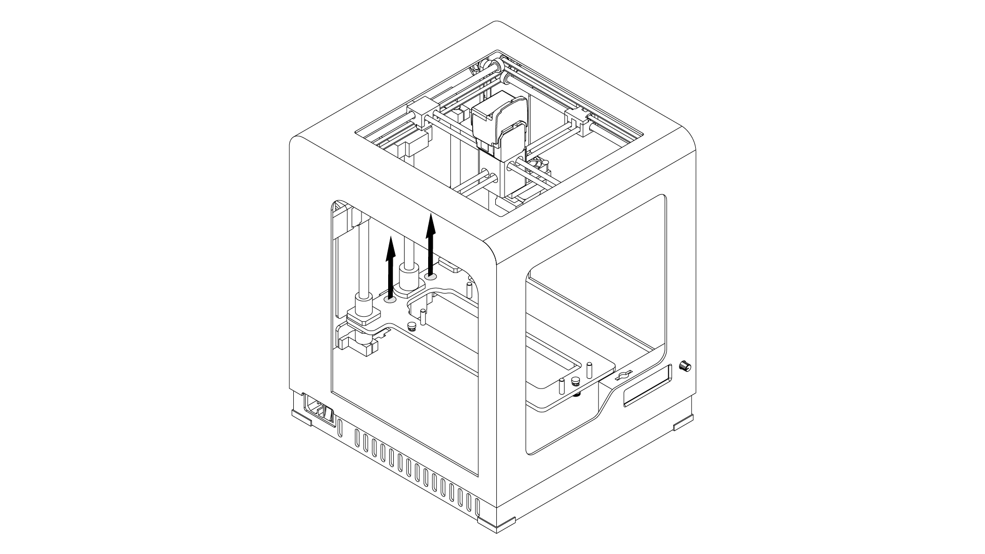

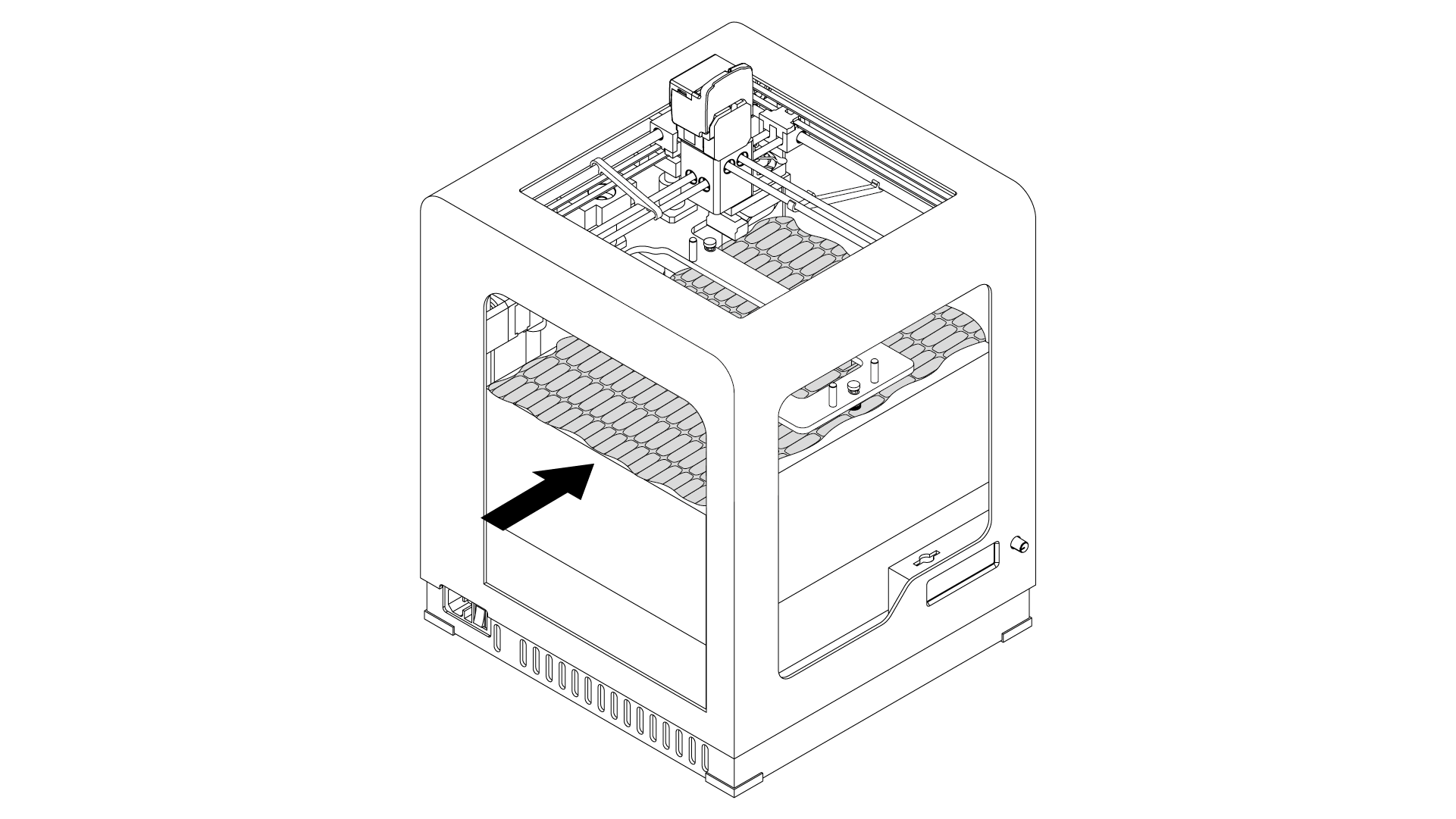

Lifting the Heatbed Mount
Lift the heatbed mount.

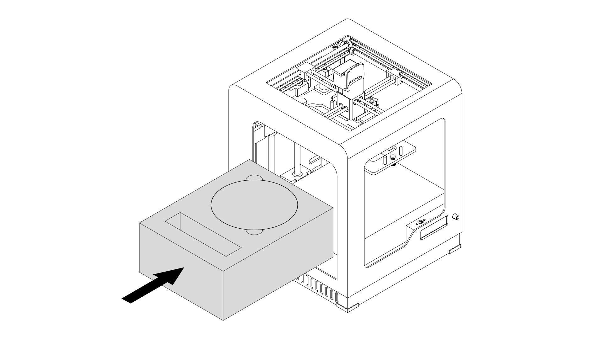

Placing the Starter Kit Box
Put the platform into the Starter Kit box and place the box on the bottom of the printer.

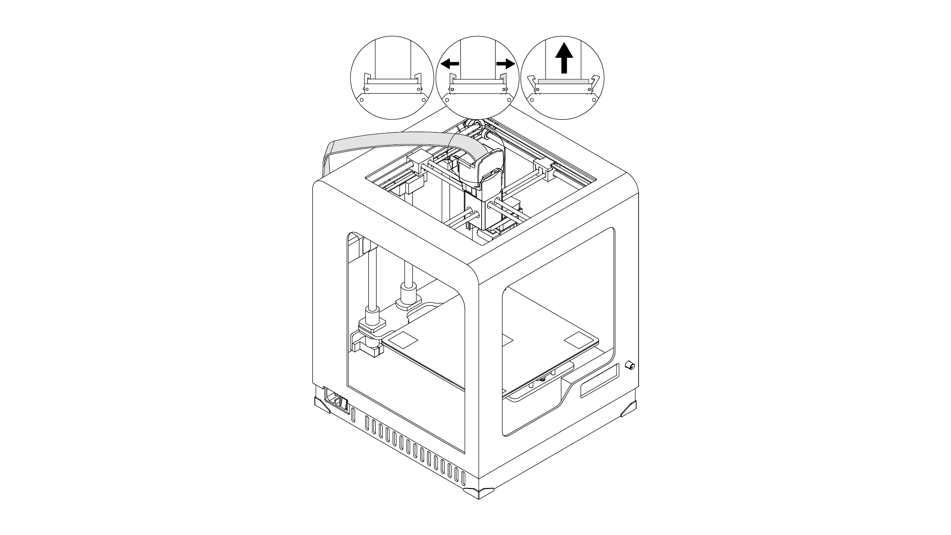

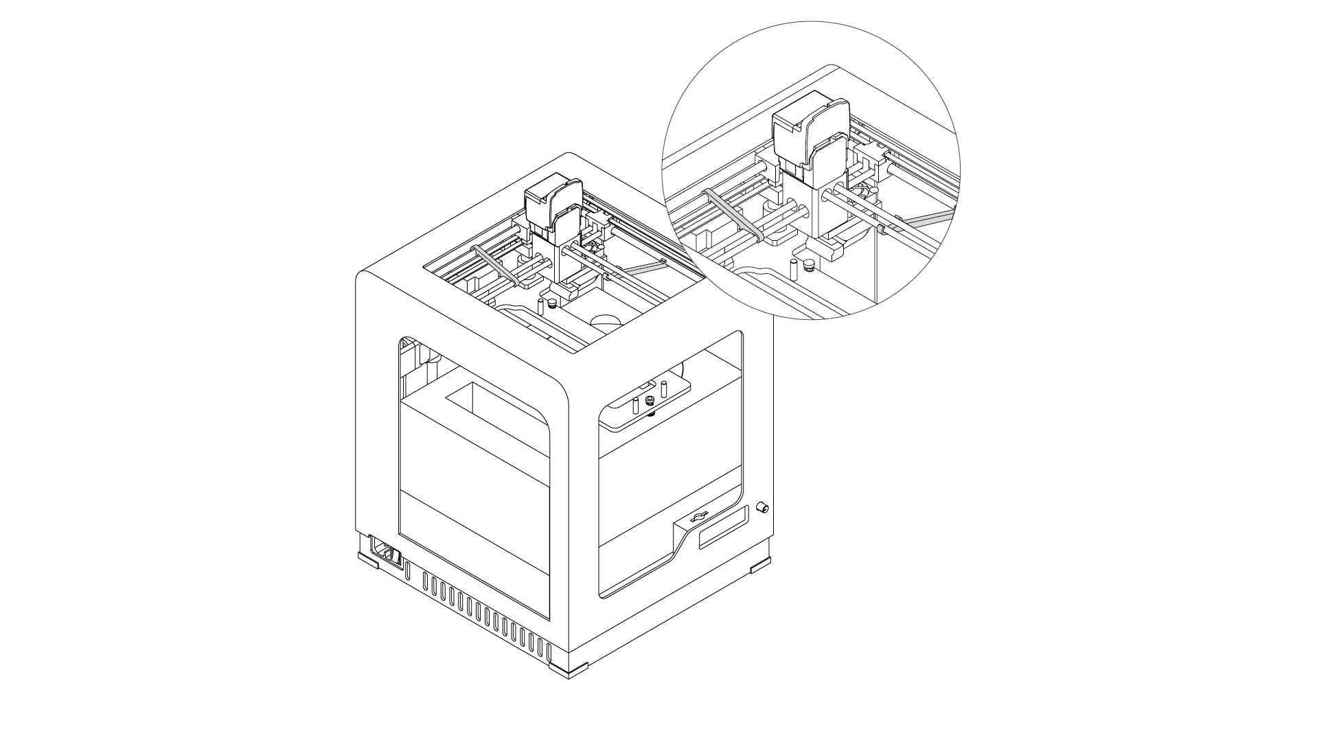

Setting the Extruder in the Right Position
Move the extruder manually to the end of X axis and then to the end of Y axis so the extruder is placed at the top right corner of the printer. Put the shipping clips on both axes.

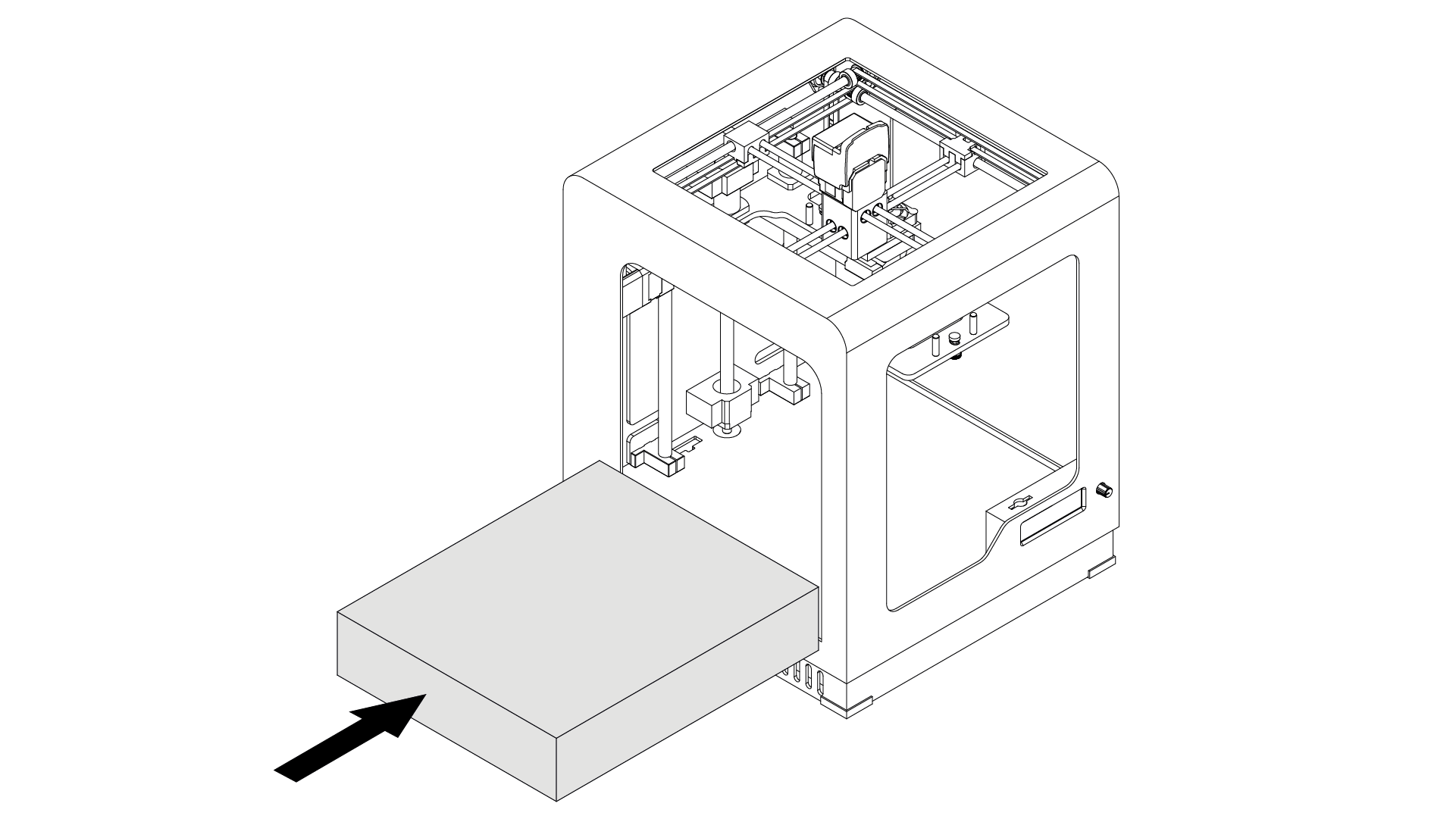

Placing the Fillers
Place the fillers on the boxes.

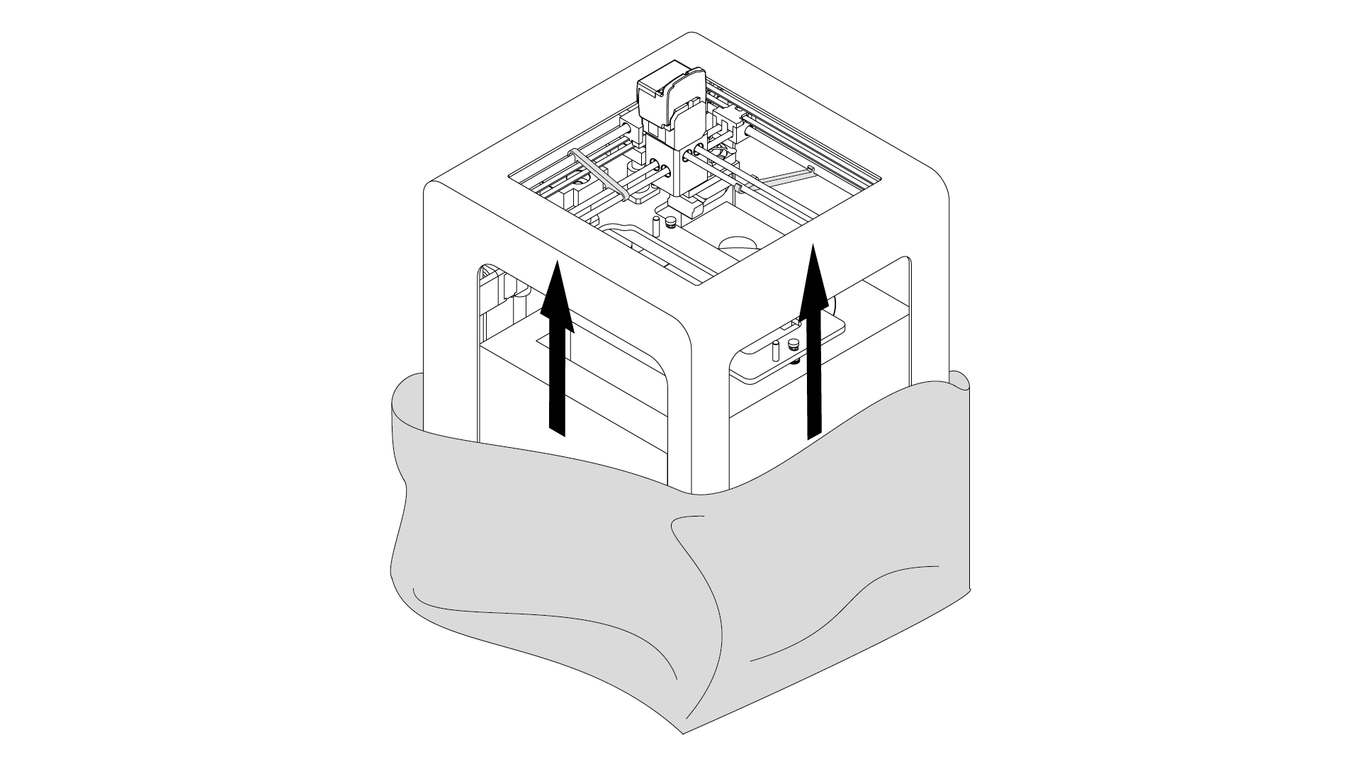

Wrapping the Printer
Wrap the printer in foil.

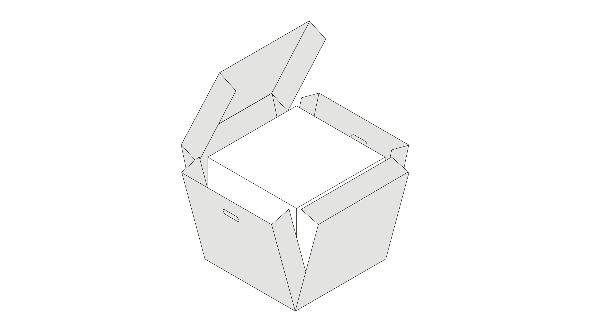

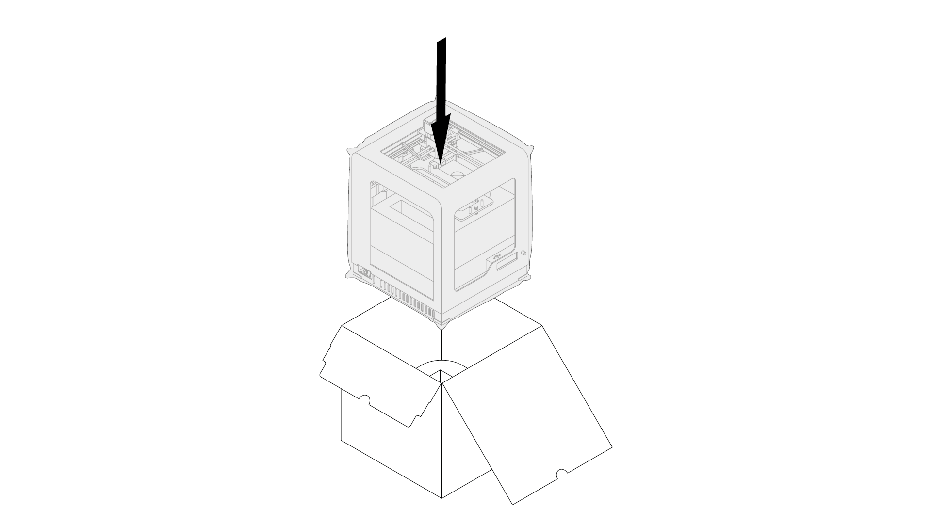

Putting the Printer into the Box
Place the printer on the bottom cushioning inside the box. Be careful not to damage the knob next to the display.

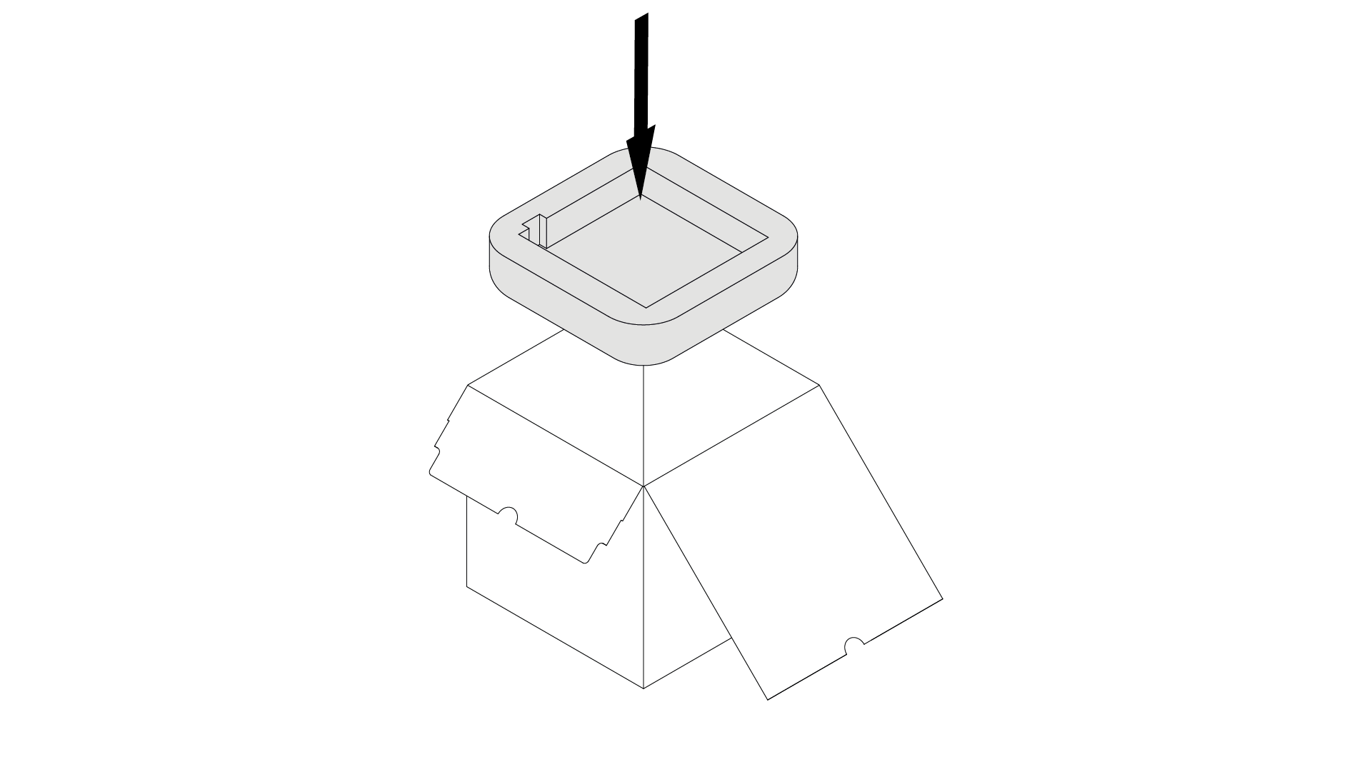

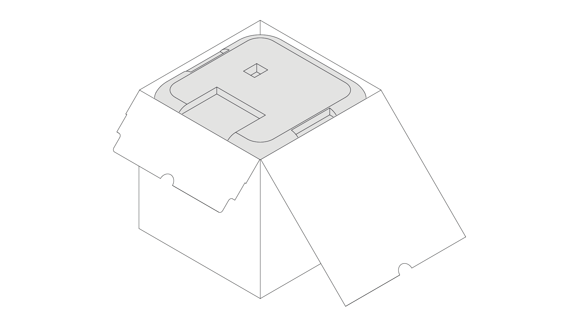

Placing the Top Cushioning
Place the top cushioning on the printer so that it fits the extruder.

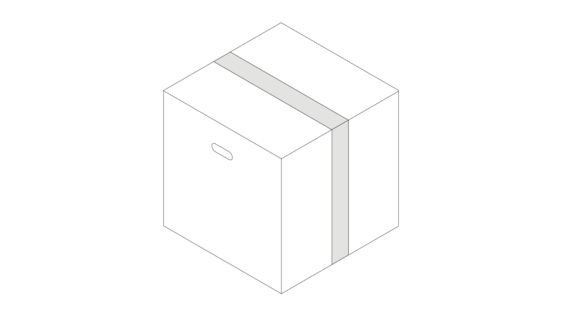

Taping the Box
Tape the box.
