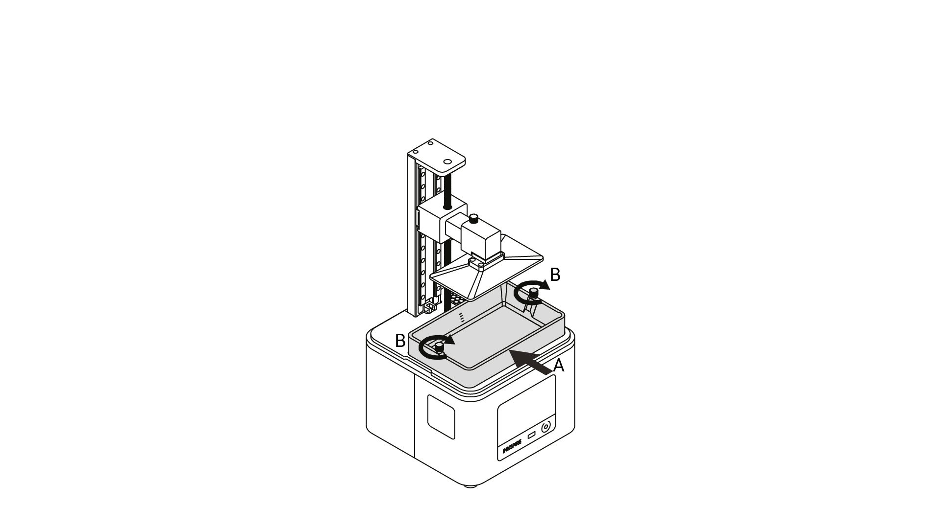

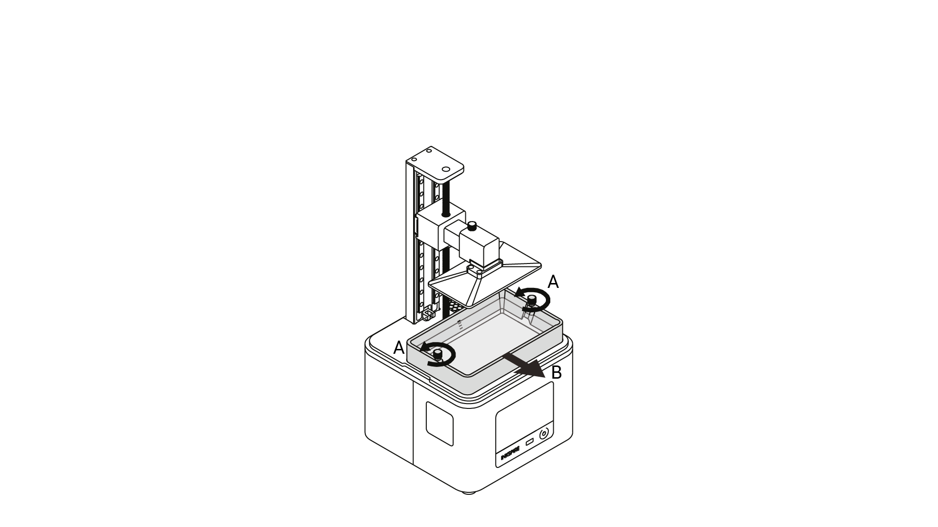

2. Unscrew the two screws that secure the resin tank and remove them (A). Next, remove the resin tank (B).

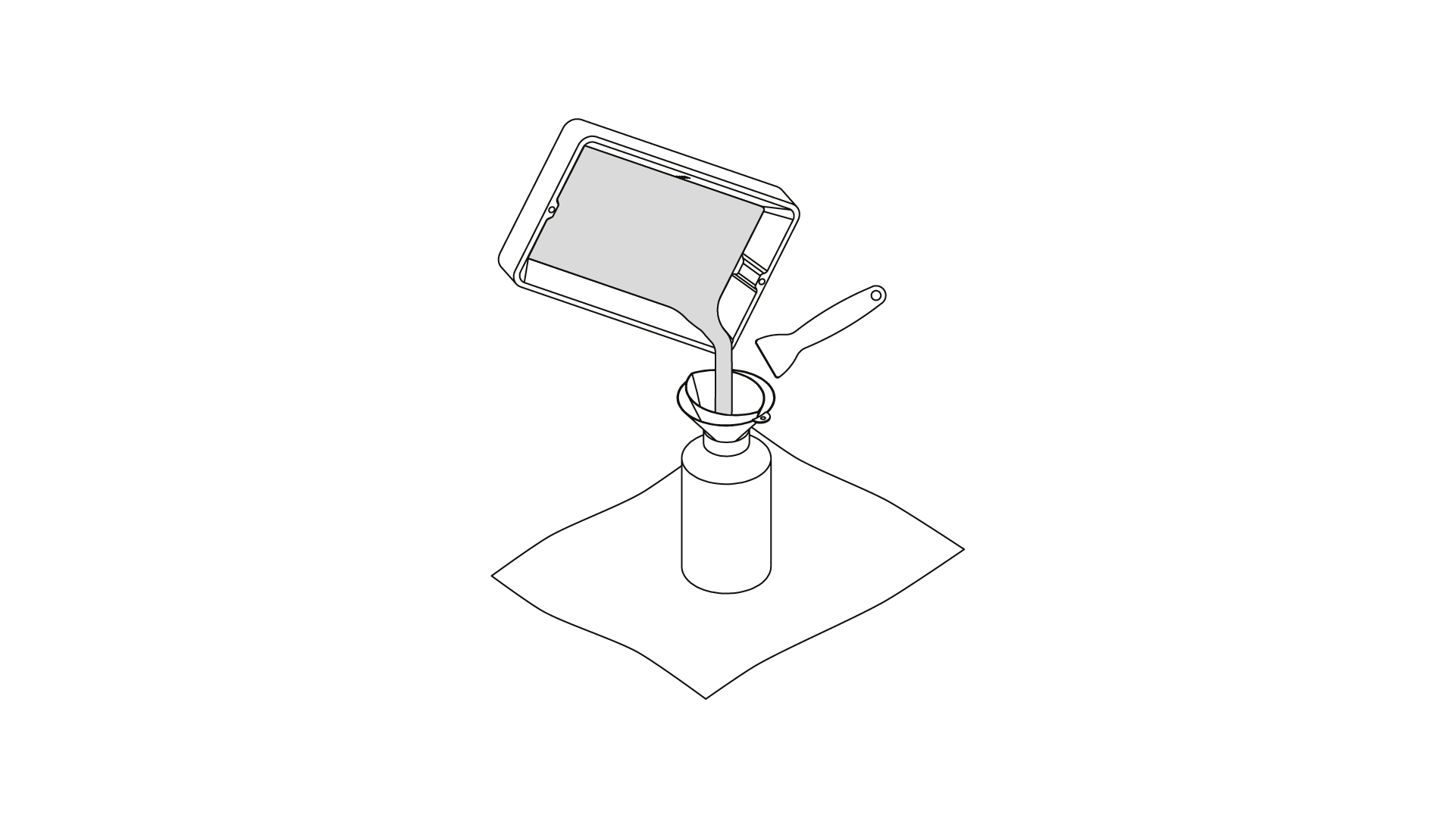

3. Insert the resin filter into the silicone funnel and put them together in the bottle with resin. Pour the resin left in the tank through the filter and funnel. If it's necessary, use a plastic spatula.

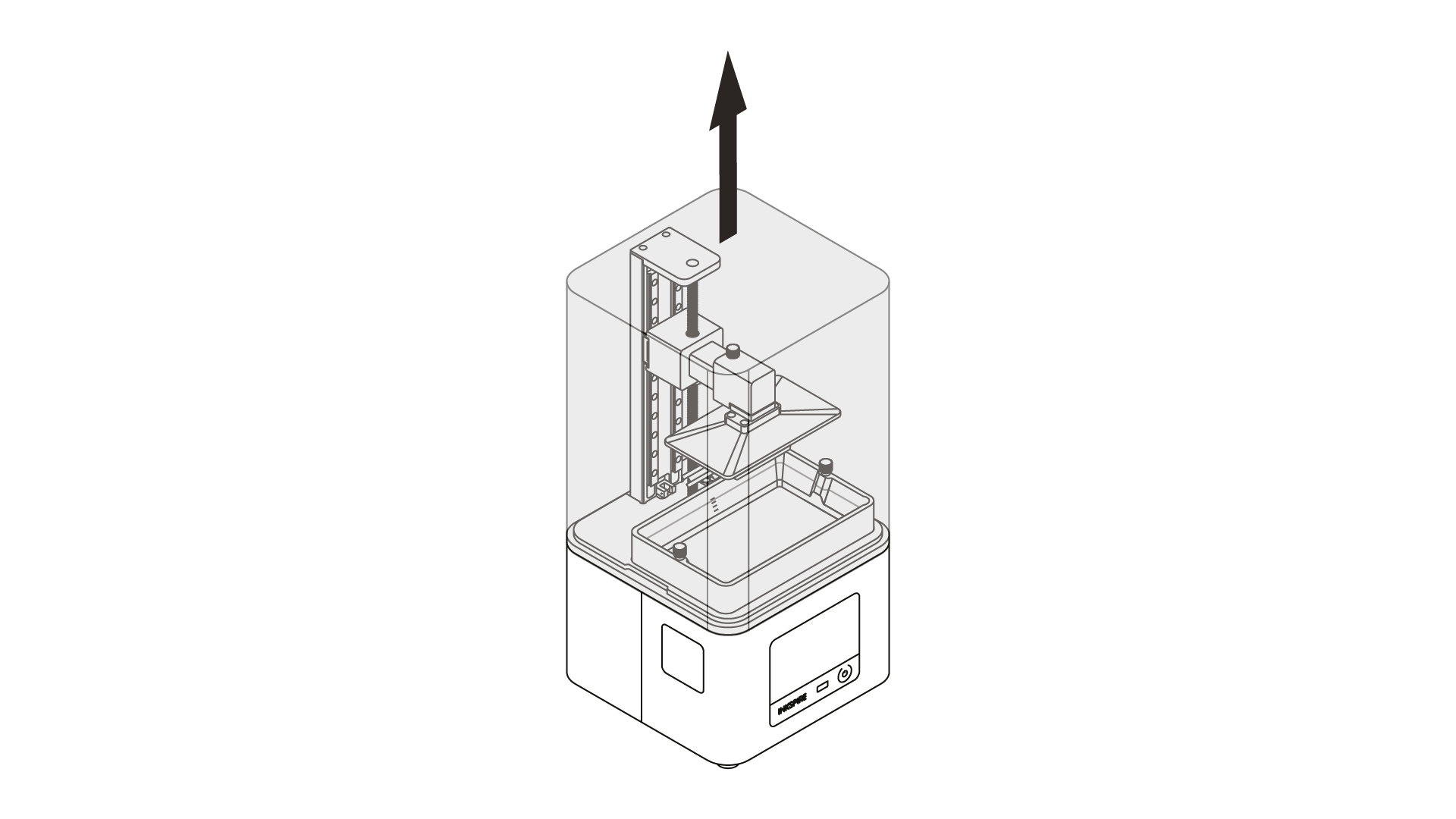

1. Remove the UV cover.

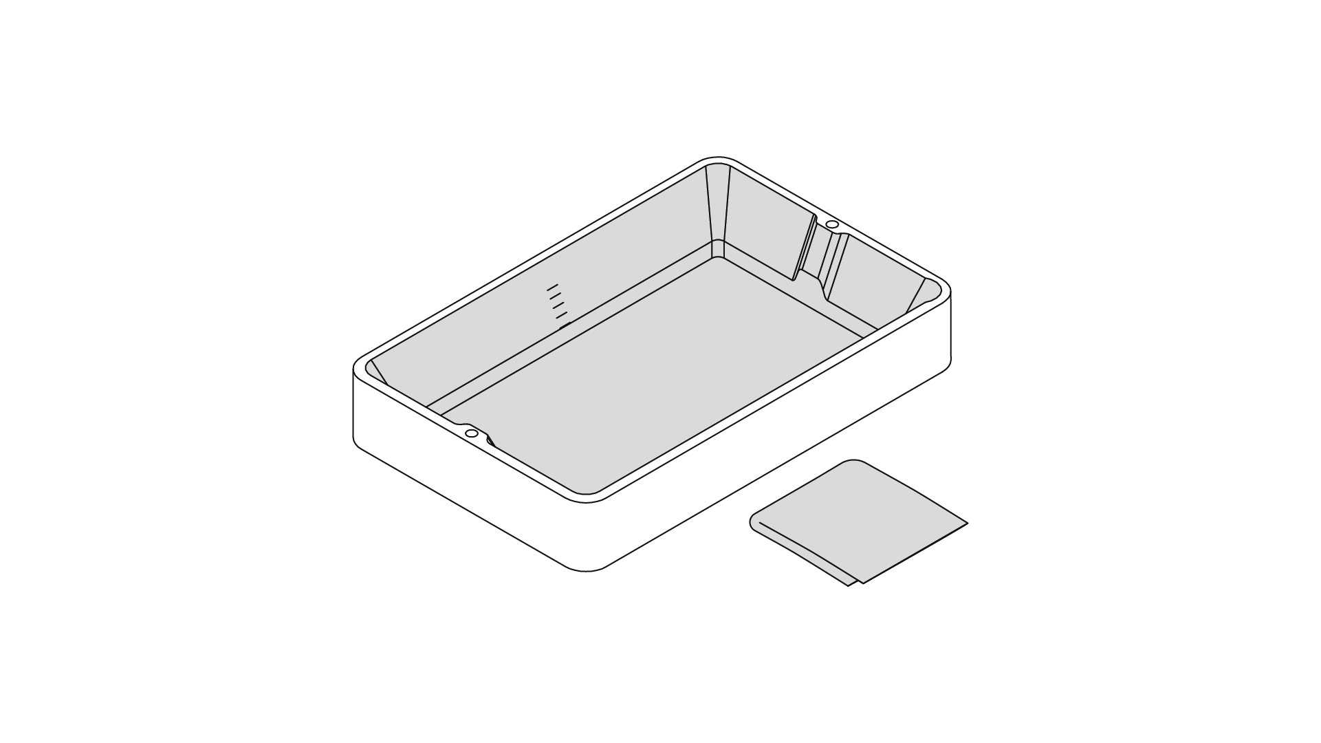

4. Clean the resin tank with a paper towel. You can also use isopropyl alcohol for that purpose.
5. Clean the LCD screen and the outside of the FEP film with a soft cloth. Install the resin tank back in its place (A) and secure it with the two screws (B).

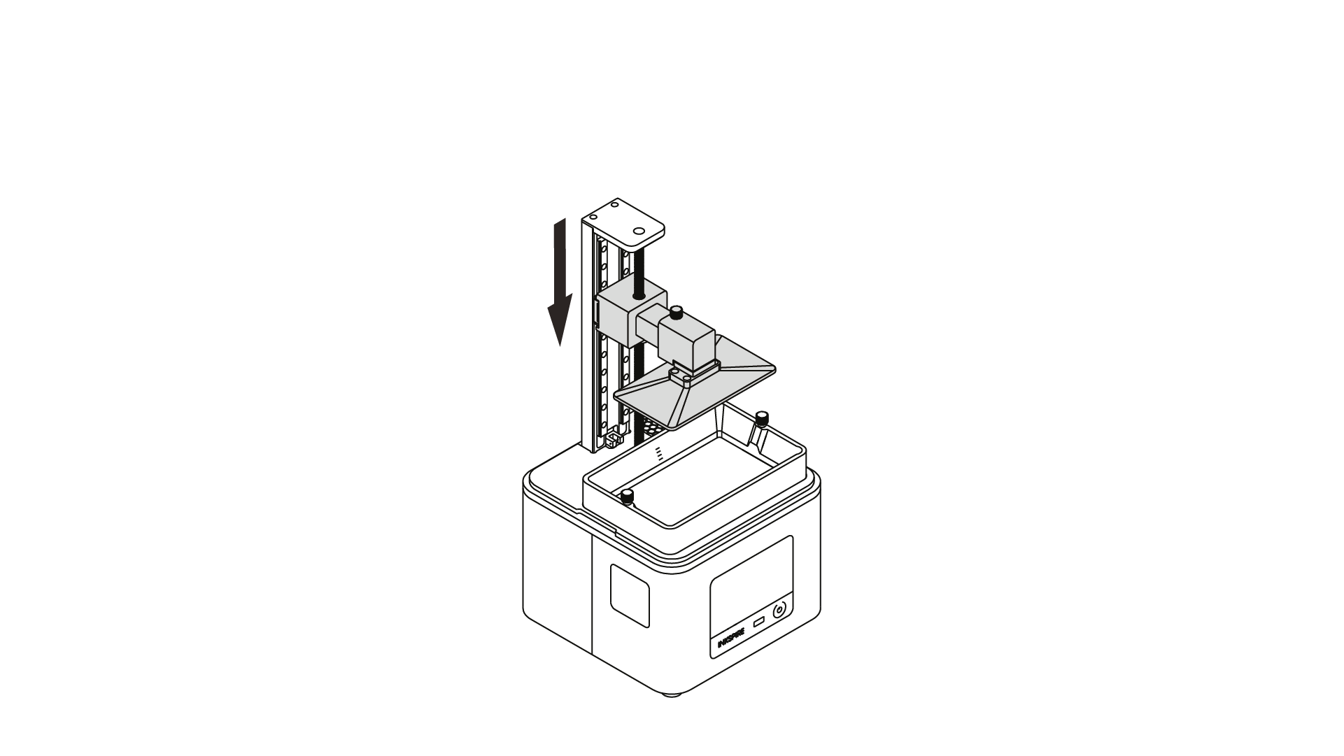

6. Lower the platform to the very bottom using the options from the menu.

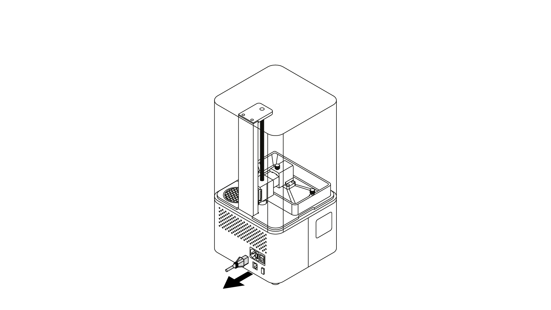

1. Turn the printer off and unplug the power cable.

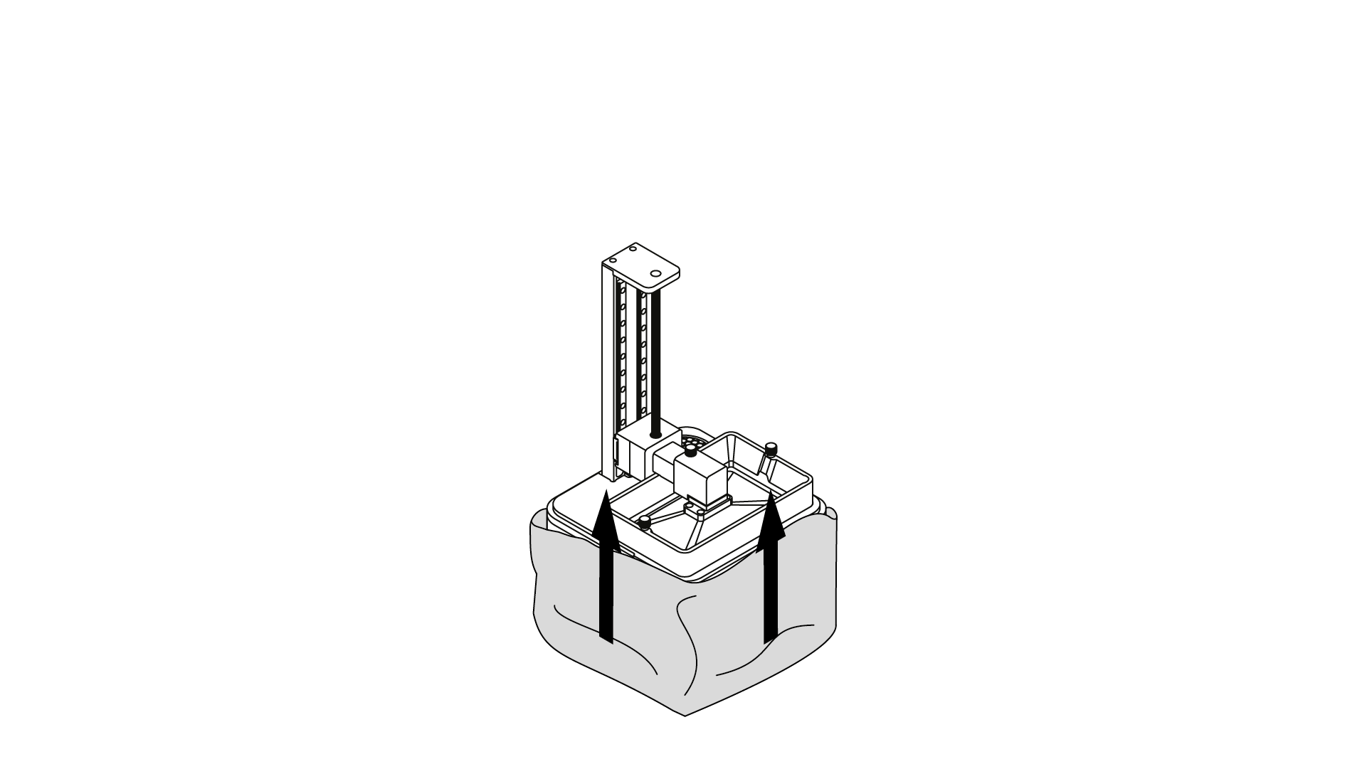

2. Wrap the printer in foil.

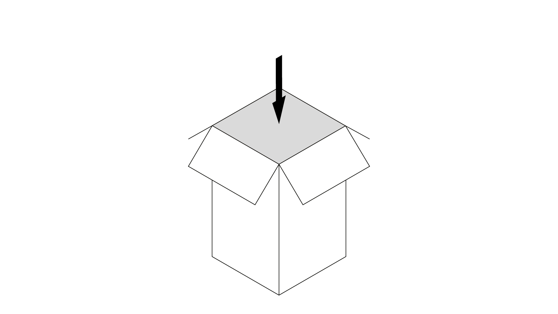

3. Place the cushioning at the bottom of the box.

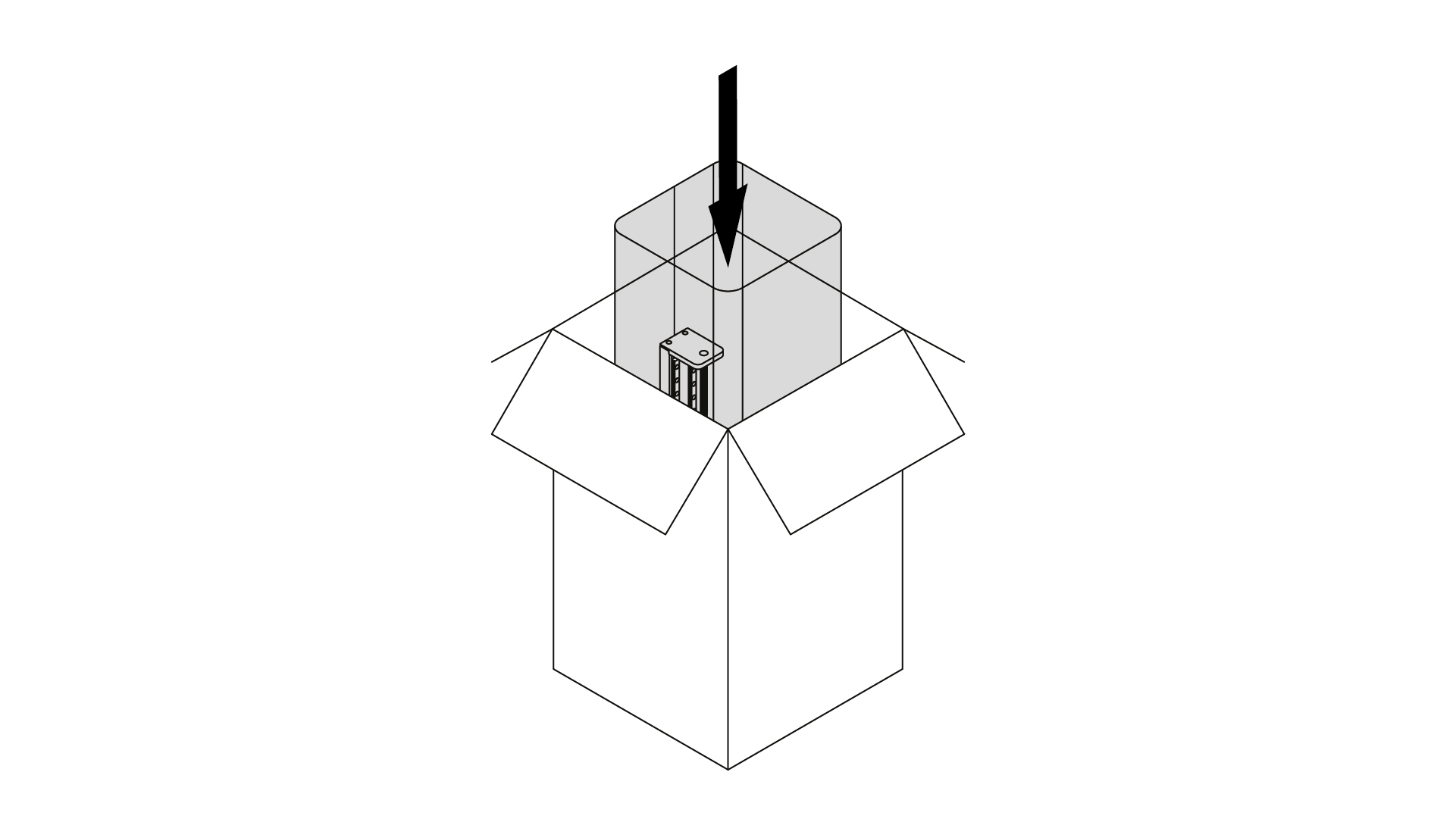

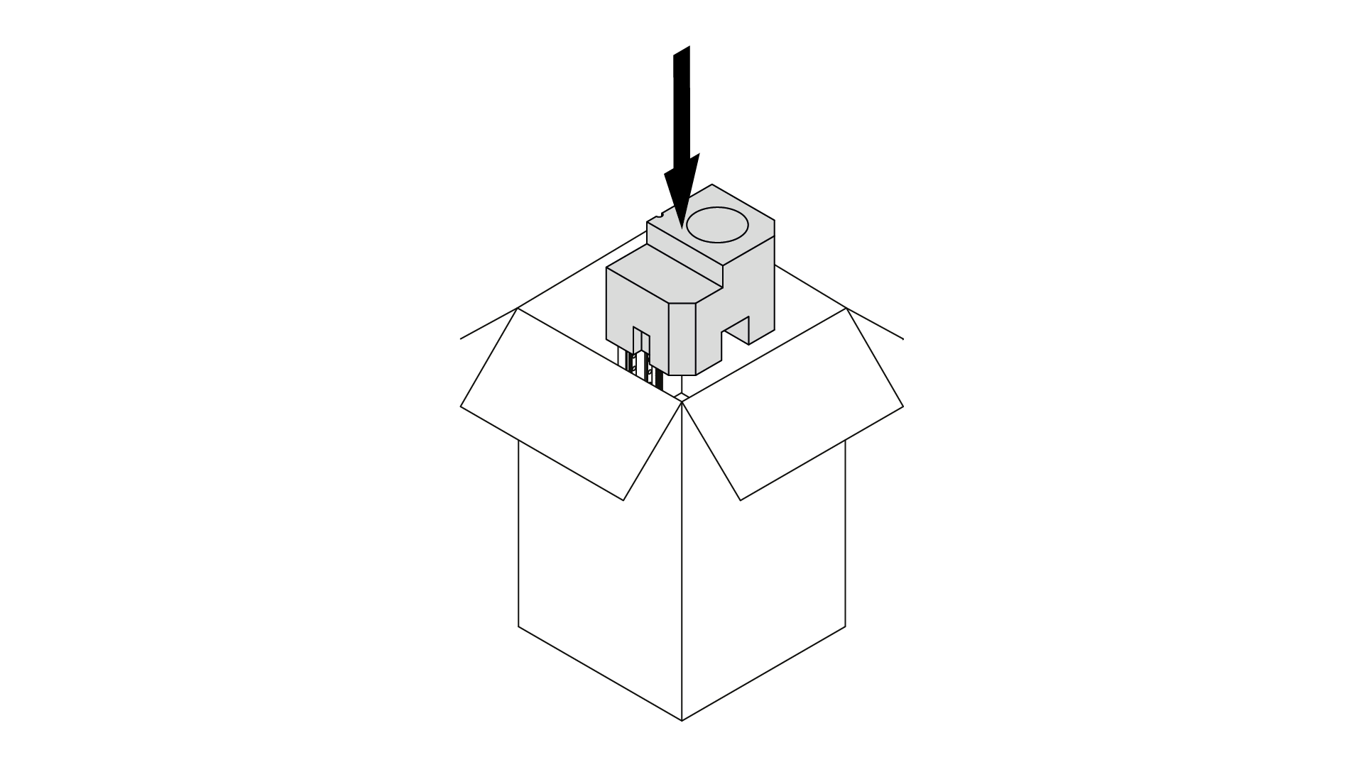

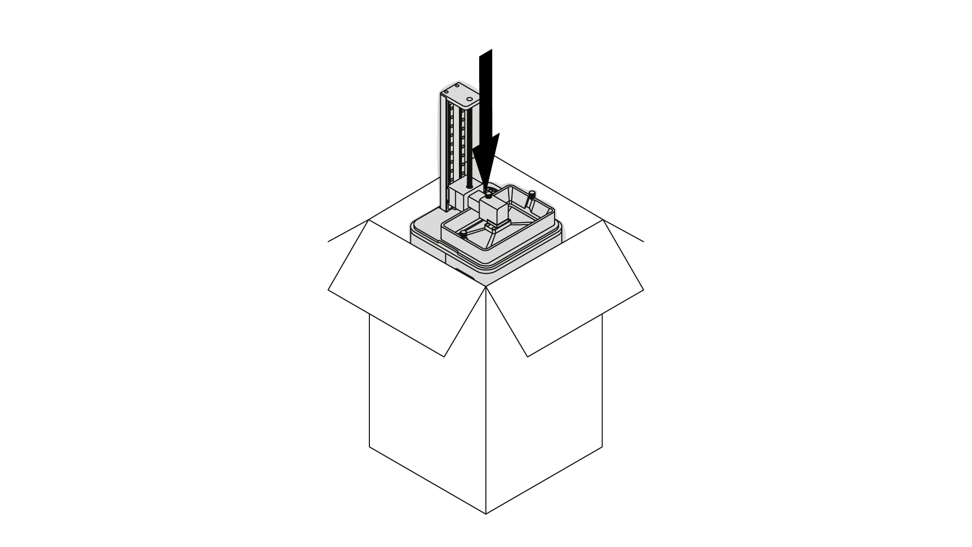

4. Put the printer in the box.
5. Place the foam in the printer.
6. Install the UV cover on the printer.

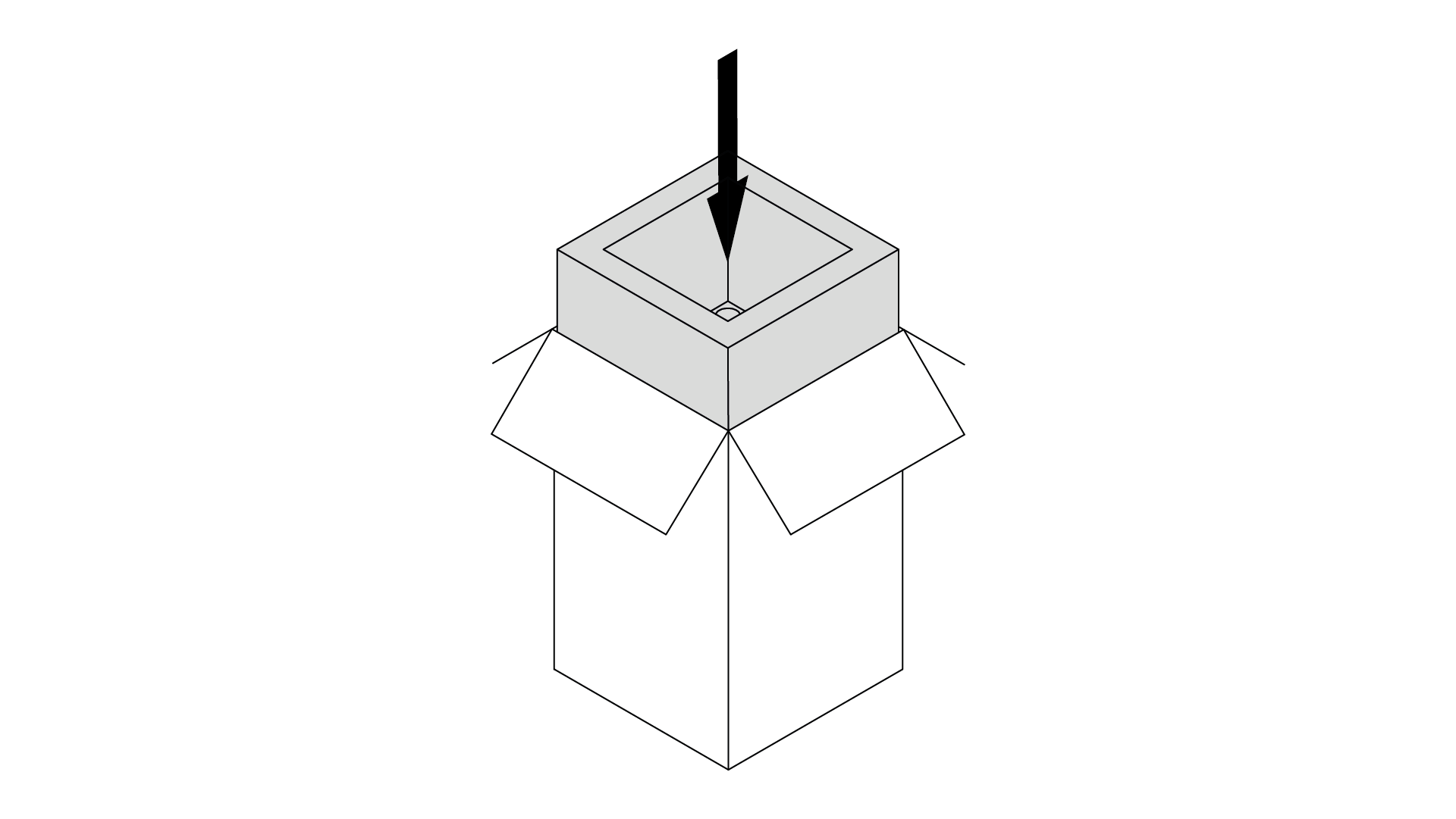

7. Place the top cushioning on the printer and tape the box.
