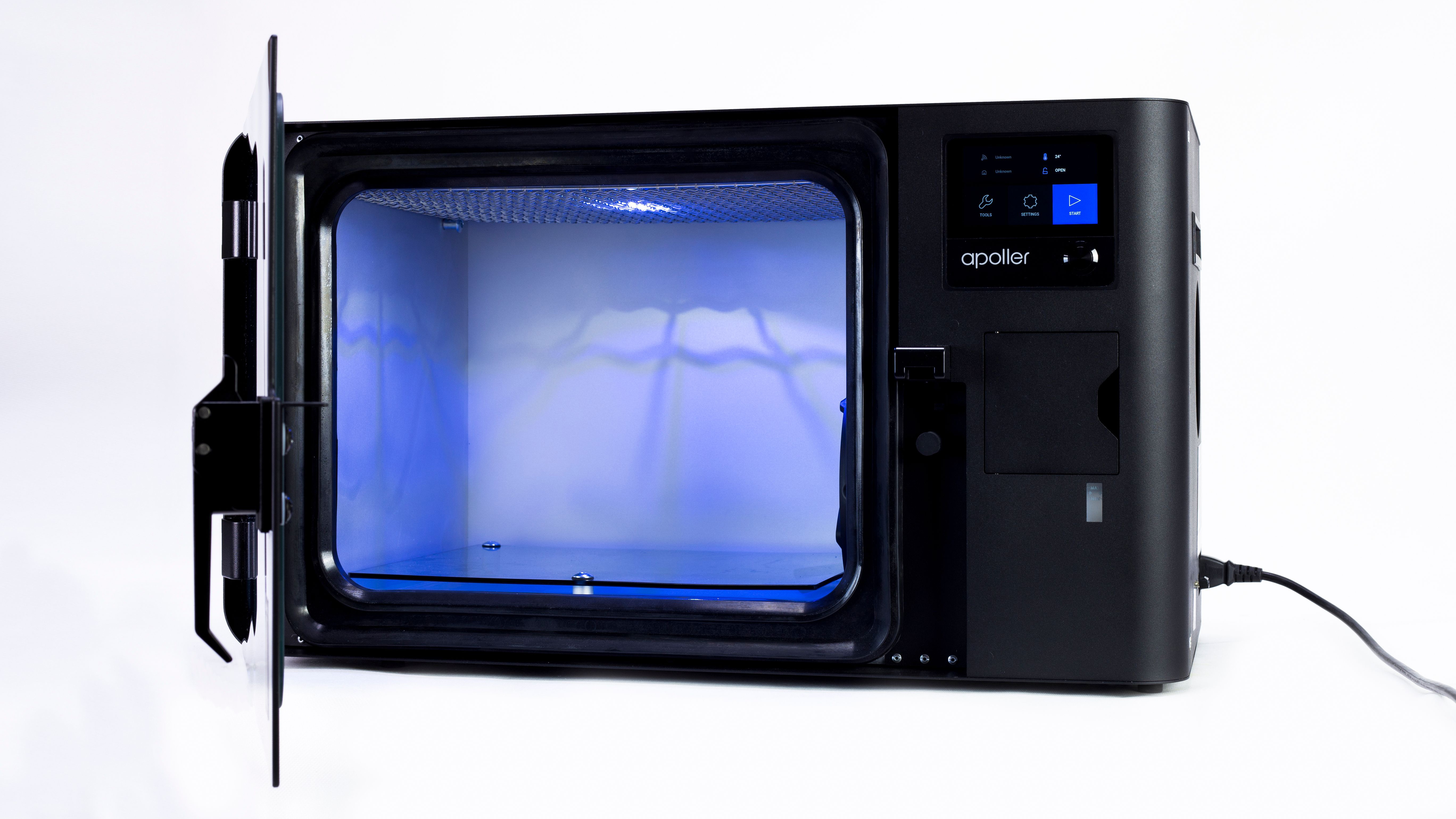

Zortrax Apoller is a post-processing device used for smoothing down layers characteristic for items 3D printed in the LPD/FDM technology. The smoothing effect is achieved through vaporization of solvents, acetone or butanone (MEK), that react with the thermoplastic used for 3D printing. The device operates in a system called Smart Vapor Smoothing (SVS), thanks to which vapors of a chemical substance circulate inside the air-tight chamber, and then are condensed. Once the smoothing process is finished, the remaining liquid solvent is retracted from the chamber and can be used during next processes.

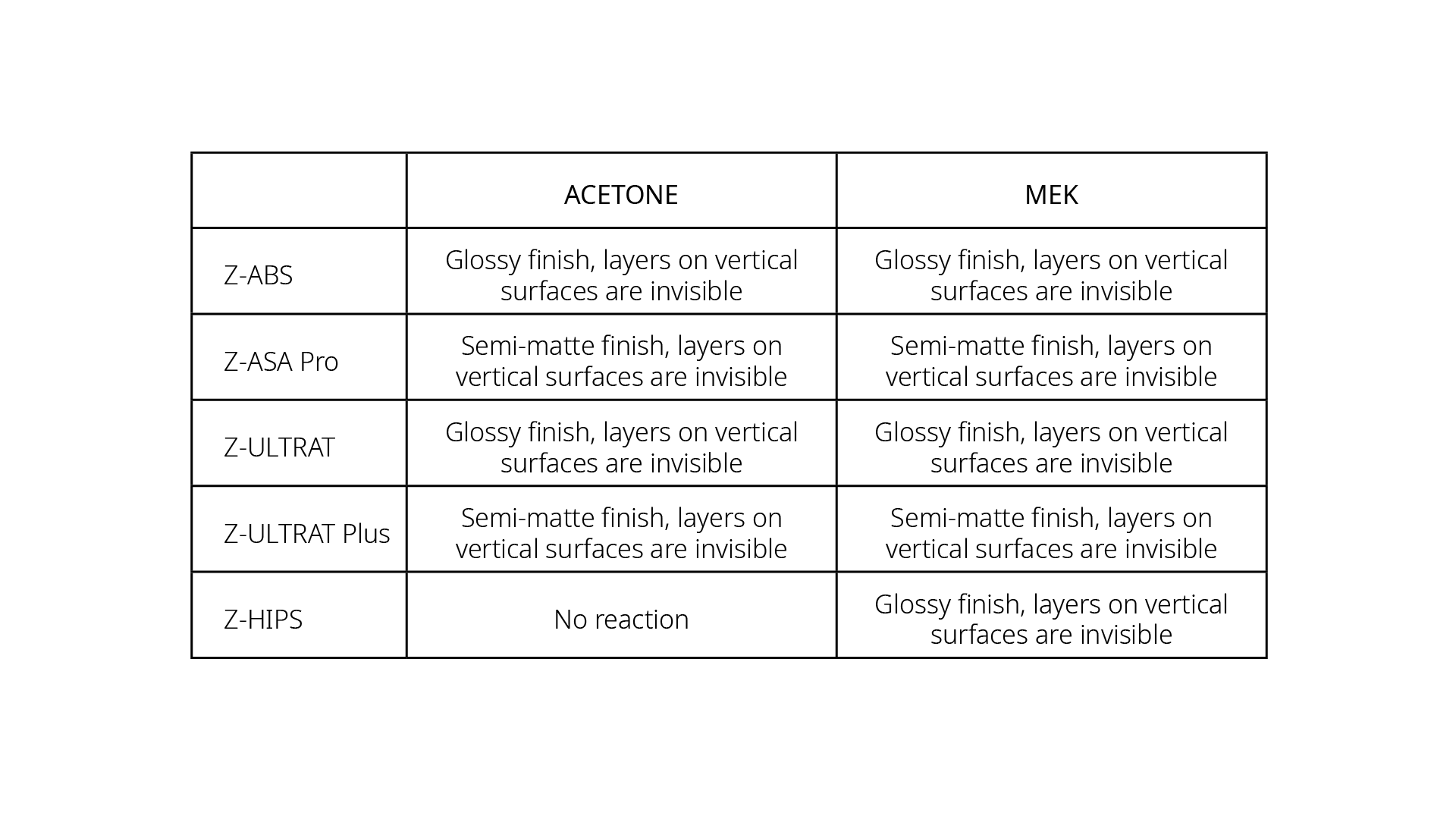

The Zortrax Apoller removes visible layers from items 3D printed with Z-ABS, Z-ULTRAT, Z-ULTRAT Plus, Z-ASA Pro, and Z-HIPS, or their third-party equivalents. However, materials produced by other companies may bring slightly different effects during the smoothing process. The table specifies the final effects of the surface finish on models printed with Zortrax materials.
If you want to obtain a stronger smoothing effect, use the HIGH option while selecting the smoothing intensity in the menu. Also, butanone (MEK) provides slightly more intense effects than acetone.

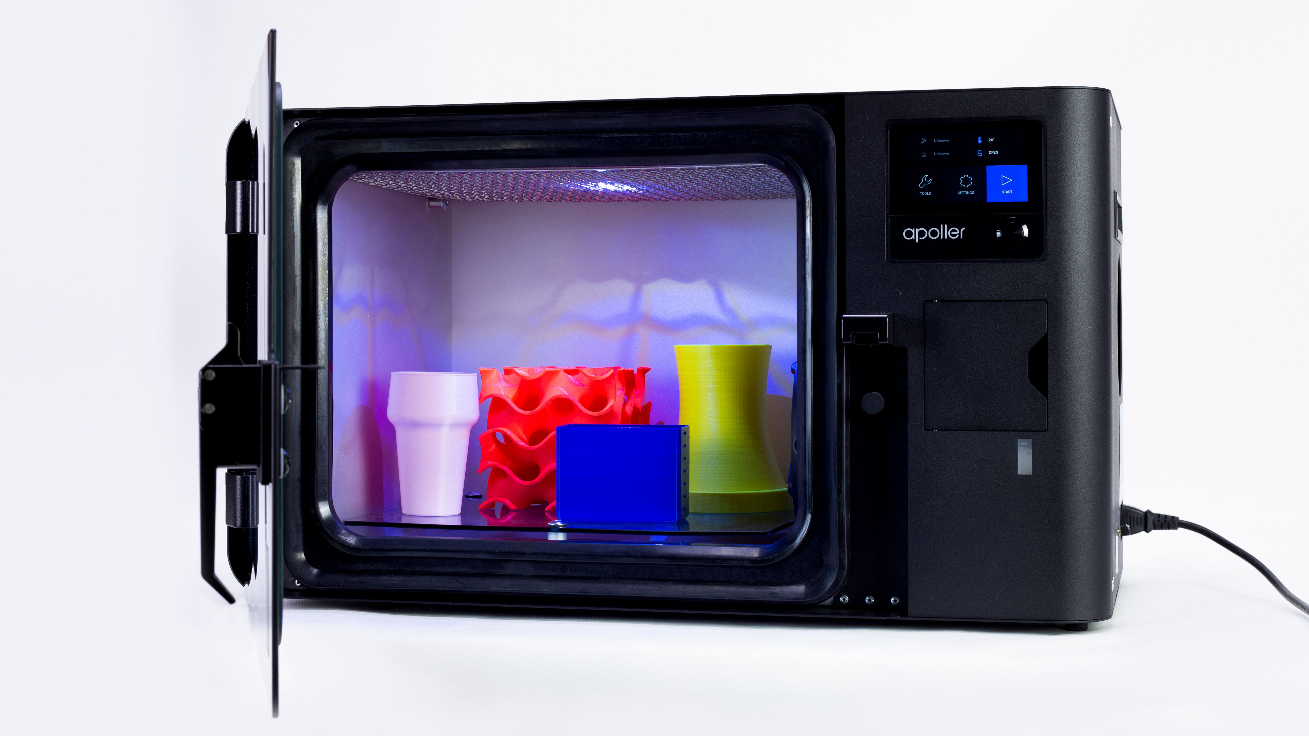

Models intended for smoothing can be placed on the glass platform in the device or can be suspended on the hooks in the grid installed in the chamber. You can use both methods during one smoothing process, but remember to keep proper spaces between models (3-5 cm [1.2-2 in]). If you put too many models inside the chamber or you don’t keep spaces between them, the vapors circulation will be interrupted and the smoothing effect will be uneven. It is also important to place models 5 cm [2 in] away from the chamber walls.

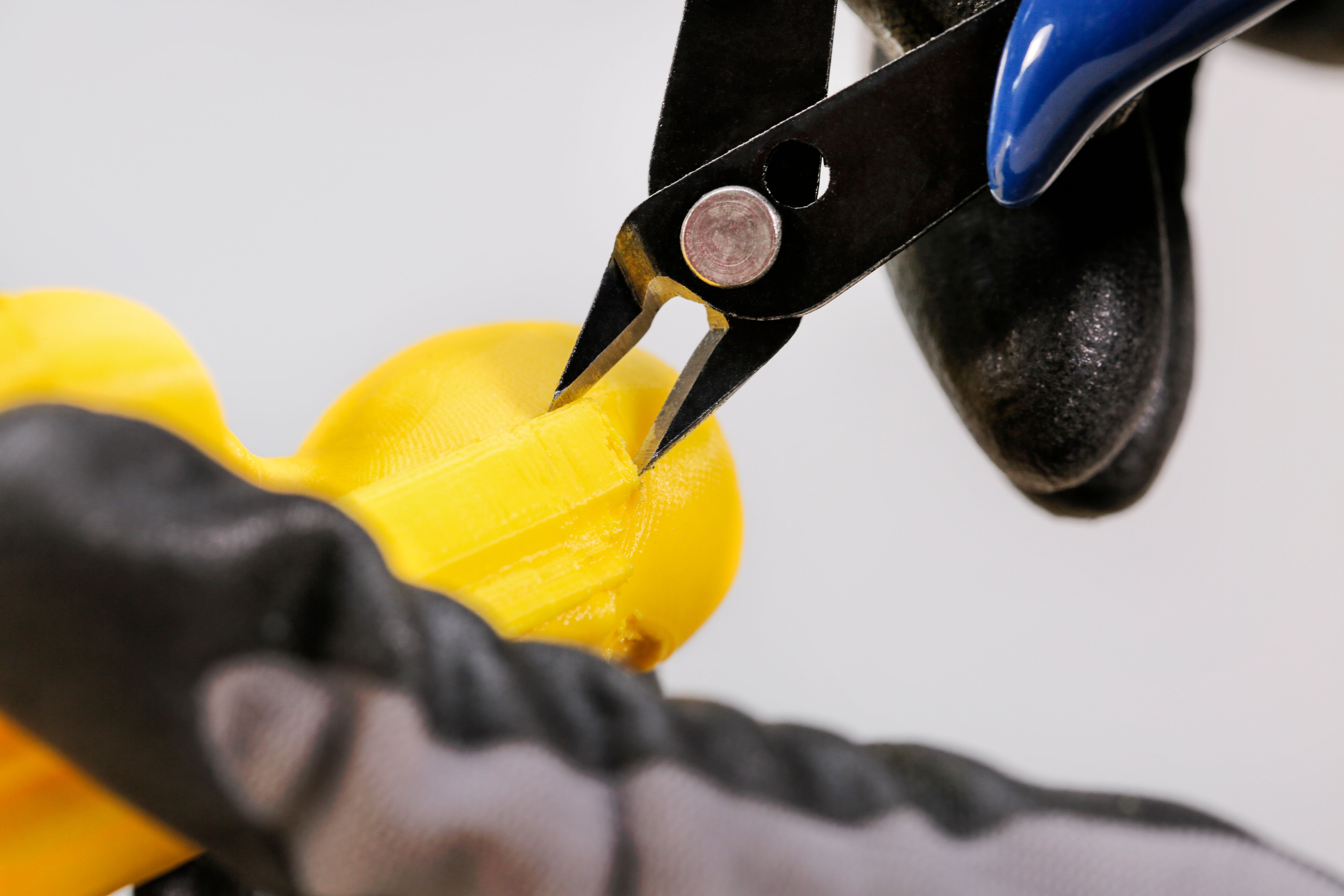

Support structures, material residues or any surface imperfections should be removed from the 3D printed object with a scalpel, knife or pliers before smoothing in the Zortrax Apoller. It is not recommended to remove residues or defects with sandpaper because marks which remain after sanding will be clearly visible on the model’s surface after the smoothing process.
Still, if you decide on sanding your model, use sandpaper with as fine grit as possible. Once you finish sanding, wipe the object with a wet cloth to remove dust.

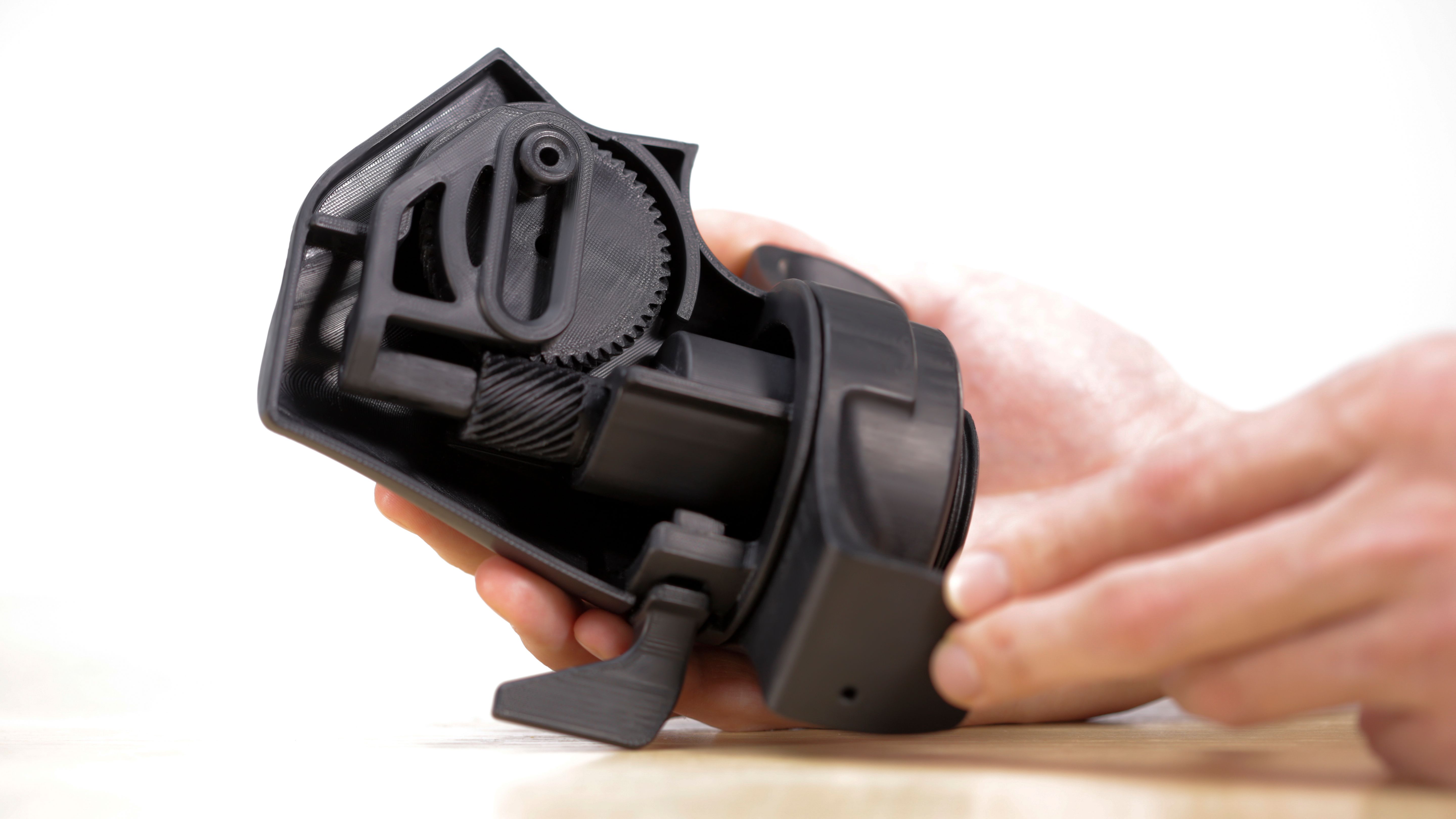

Moveable mechanisms
Moveable mechanisms, including gears, bearings or hinges, usually retain their capacity to move after the smoothing process. However, mechanisms in which there is a large contact area between individual elements may not move after smoothing. In that case, separate the glued surfaces by slightly “cracking” the mechanism.
