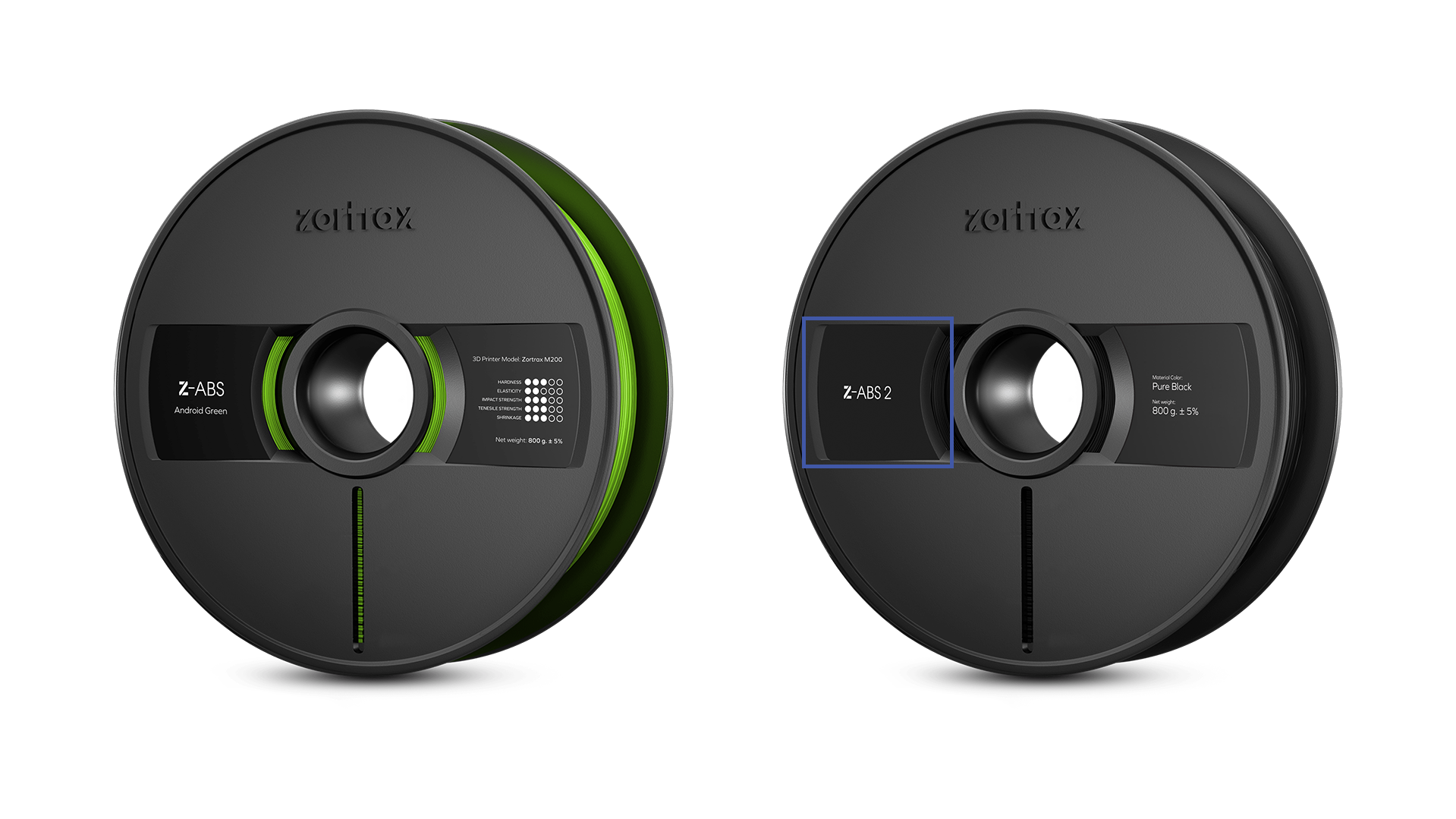

Checking Spool Sticker
Before each printing process, check the sticker on the spool to know which type of material you’re about to use or load: Z-ABS or Z-ABS 2 (previously Z-ABS v2).

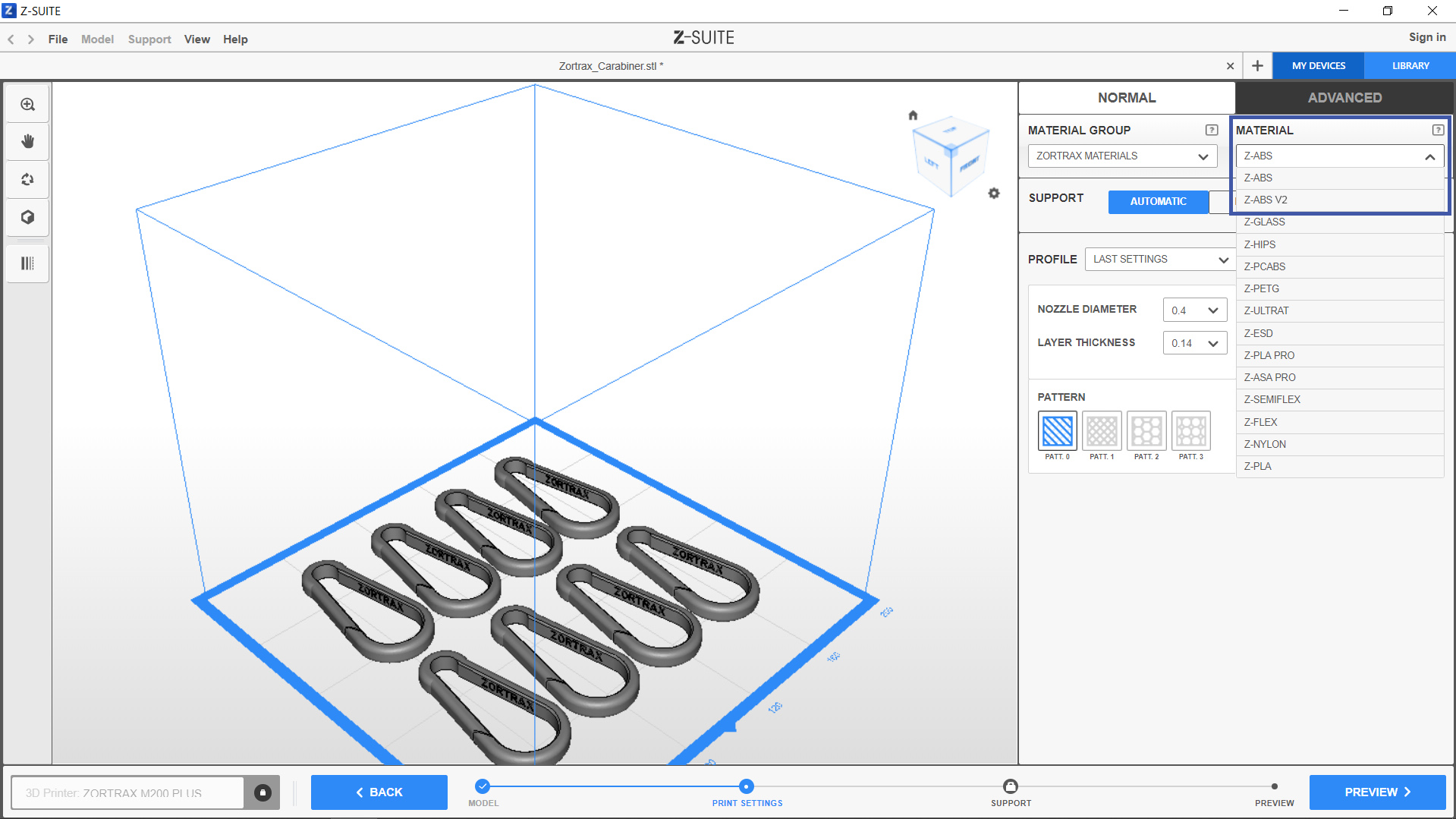

Z-SUITE Settings
Once you check the type of Z-ABS you’re using, make sure to select the right Material from the drop-down list in the Print Settings step.
Remember that a .zcode/.zcodex file previously prepared for Z-ABS must sliced again before 3D printing with the correct Material settings if you want to print it with Z-ABS v2/Z-ABS 2.
