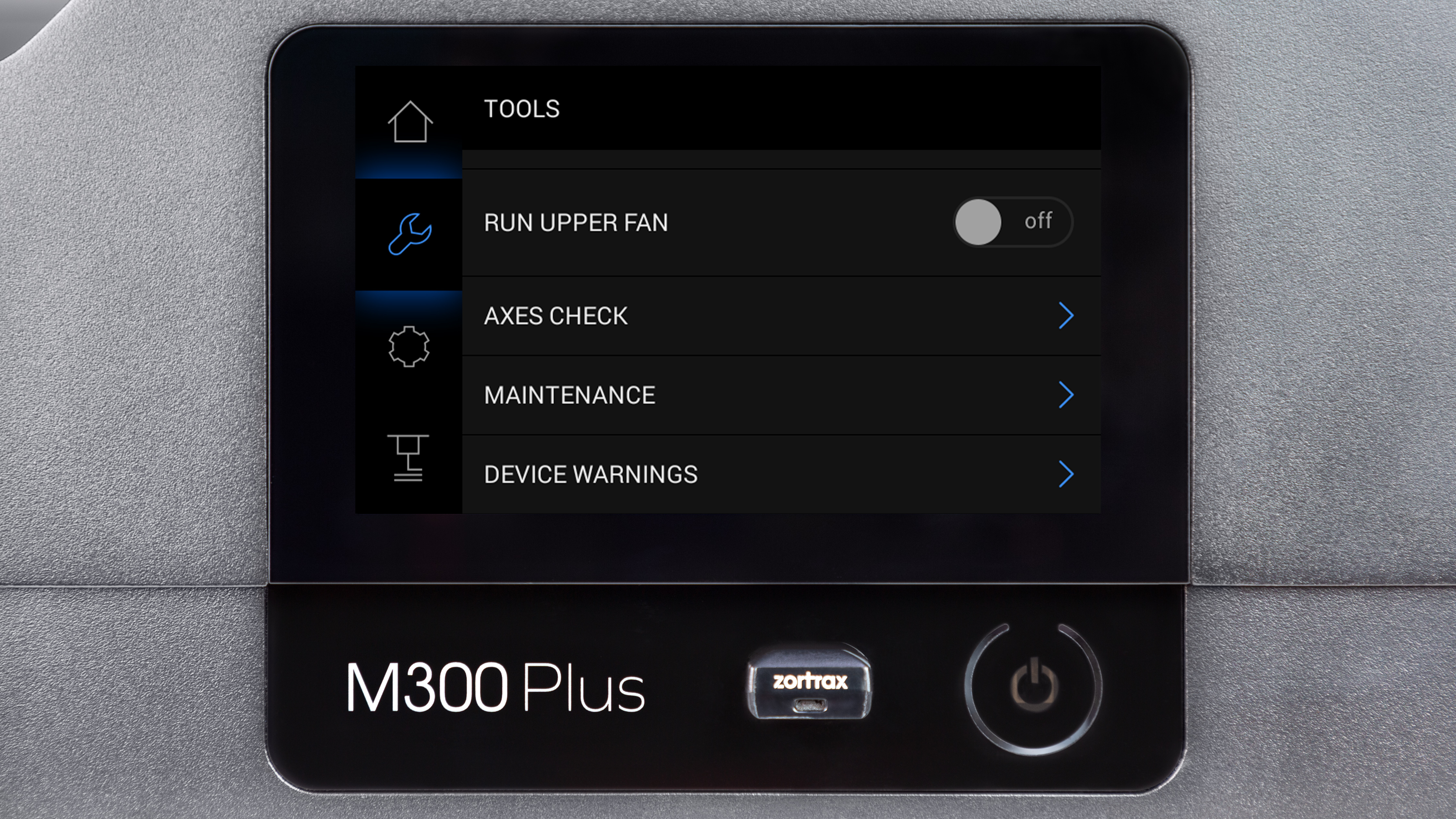

1. If you don't experience problems with the extruder homing, but receive the Endstop error, at first you should carry out the Axes check procedure. Open the Tools menu and select the Axes check option.

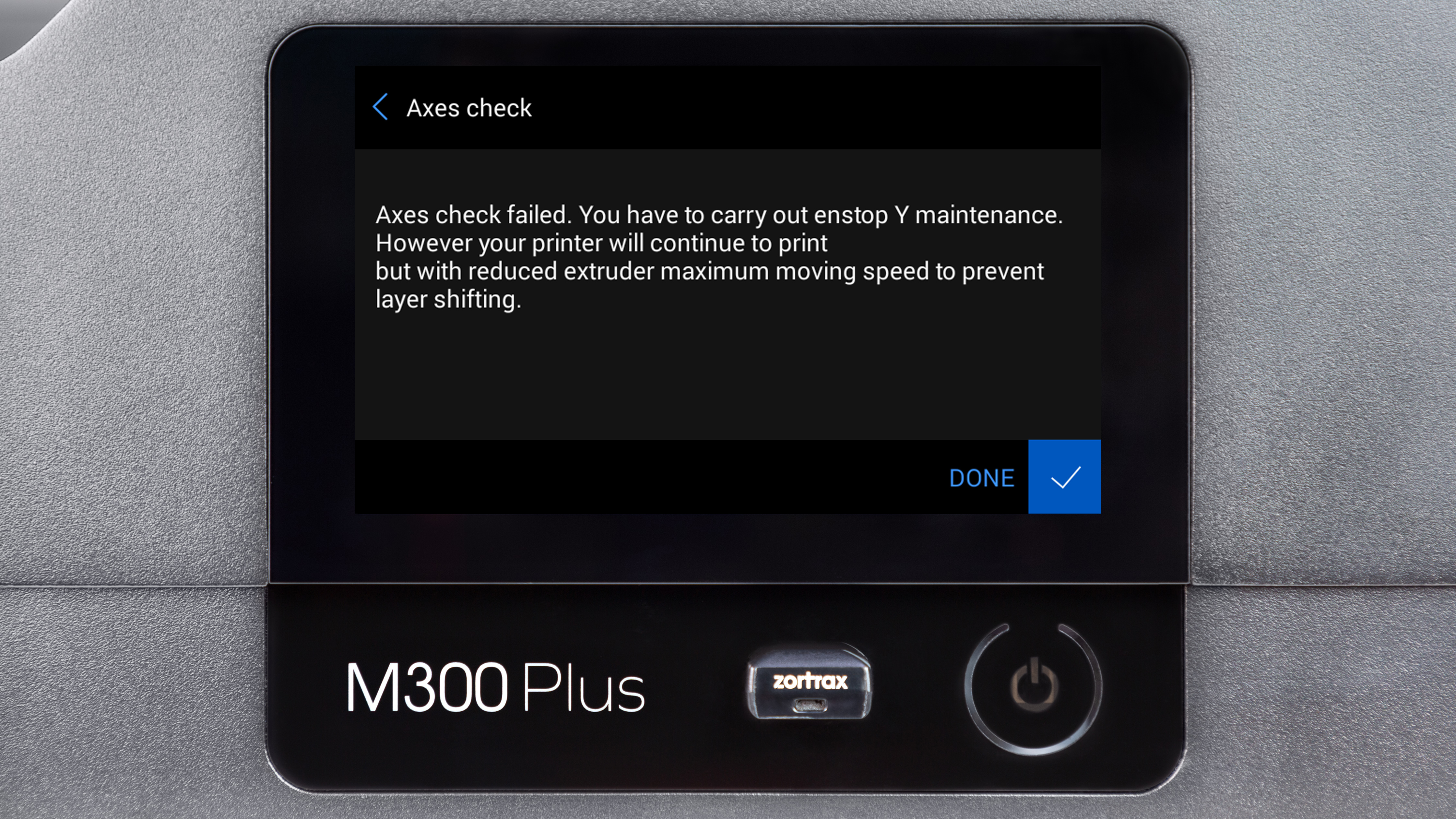

2. If the Axes check procedure fails*, follow the instructions displayed on the screen. The printer may require:
- axes maintenance,
- X/Y endstop maintenance, which is described in the step 3 in this manual.
*Even if the procedure fails, your printer can still print, but with reduced speed.
- axes maintenance,

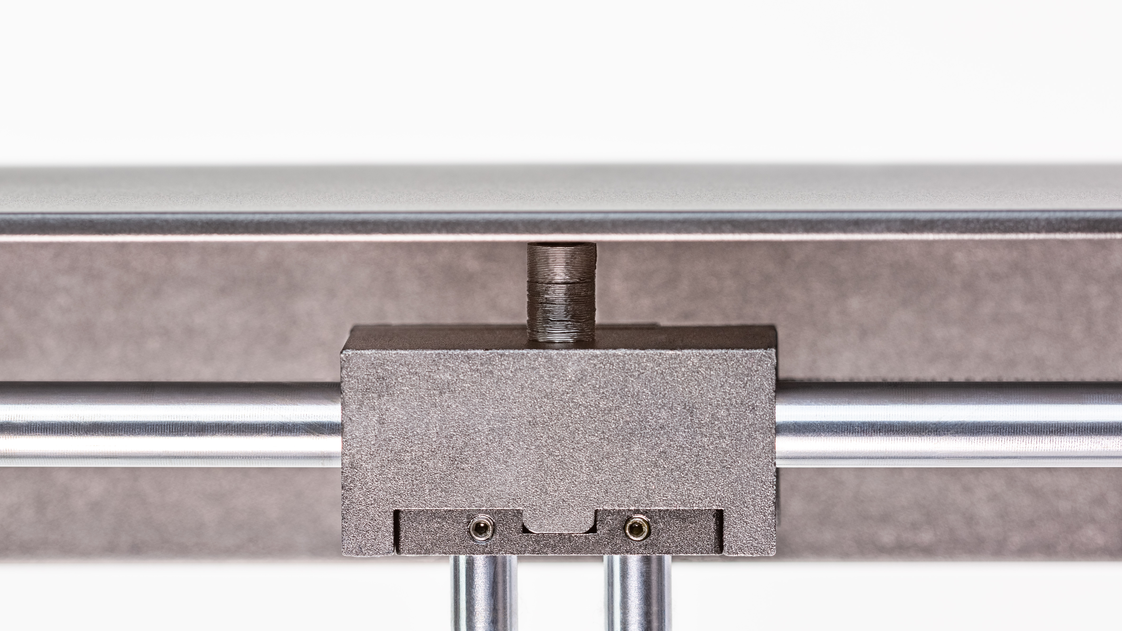

1. First, check if the endstop sleeves are installed on each axis block. Make sure the sleeves are not worn out. More details are available in the Endstop sleeve installation manual.

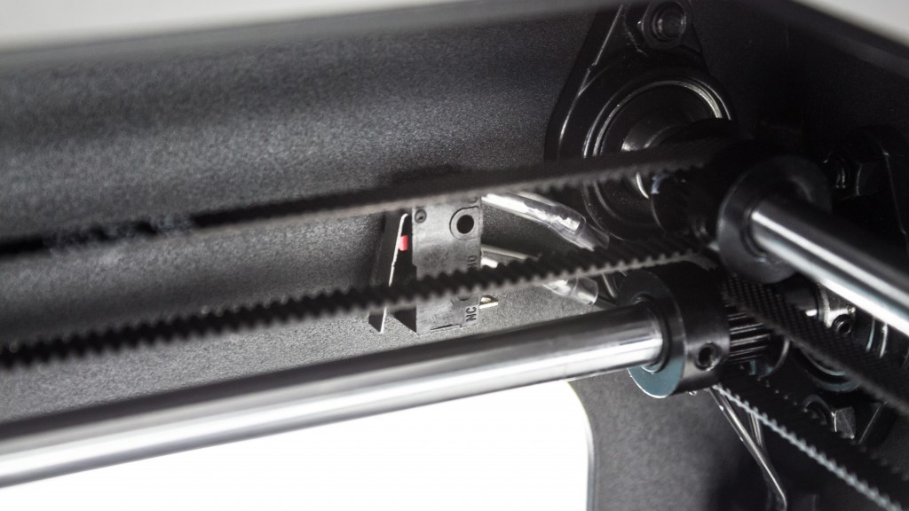

3. If the above instructions don't help, replace the endstop. More details are available in the Endstop replacement manual.
2. Check if the endstop cables are properly plugged into each endstop.
