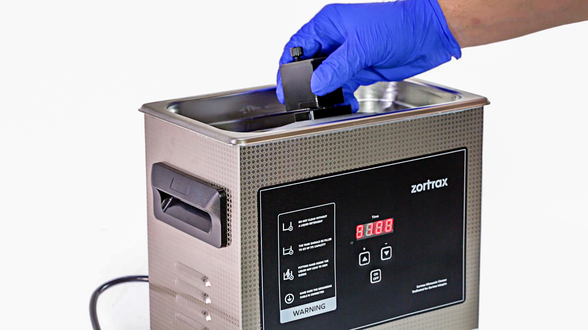

Cleaning:
  • Remove excess resin from the printed part with a painter brush (or any brush made with hair) and 95% concentrated Ethanol (preferred) or IPA. Some form of methanol should work, but make sure it does not contain acetone.
  • Do not submerge the parts in alcohol for more than 30 seconds. After 2-3 minutes of cleaning, remove alcohol with a hair dryer or air blower. For complex parts with a lot of cavities, it may be a good idea to clean/dry multiple times.
  • You can touch the dried surface to see if it is still sticky. If the surface is still sticky, repeat washing and drying again.

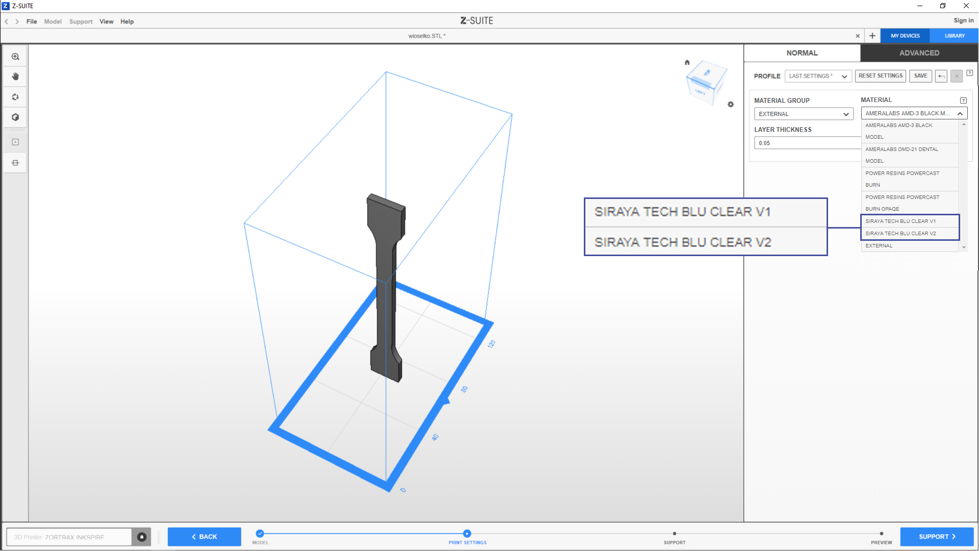

First, change the Material group to External, and then select the SIRAYATECH BLU CLEAR v1 or SIRAYATECH BLU CLEAR v2 from the drop-down list.
Next, set the Layer thickness with which you are going to print your model. This parameter determines the height of each layer. Finer layers provide better surface quality but make the printing process more time-consuming.
