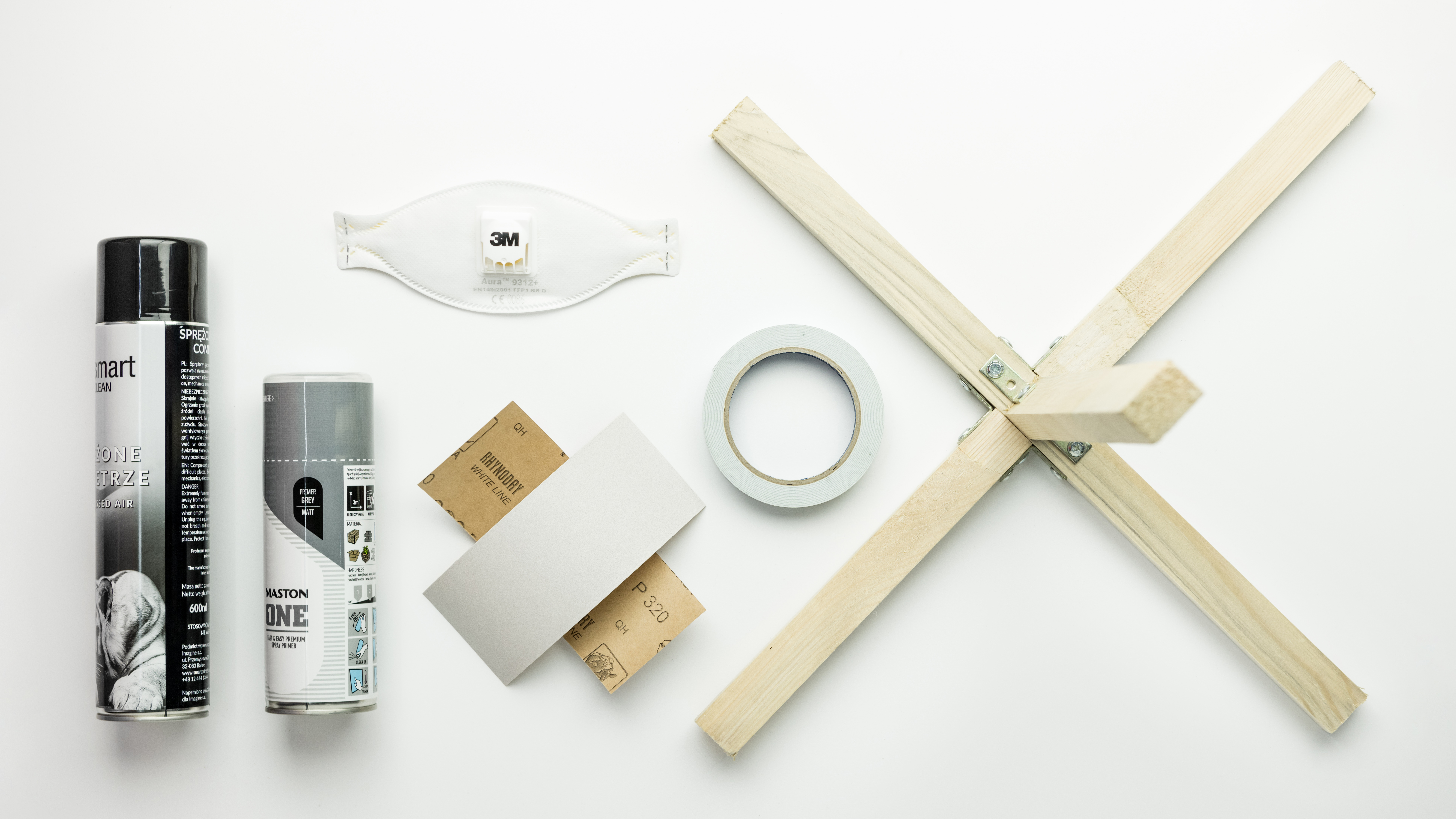

Necessary Tools
You’ll need a face cover mask, sandpaper, a can of compressed air, a primer, and a rack that will allow you to hold the model still.
Our rack is handmade from a few pieces of wood screwed together.

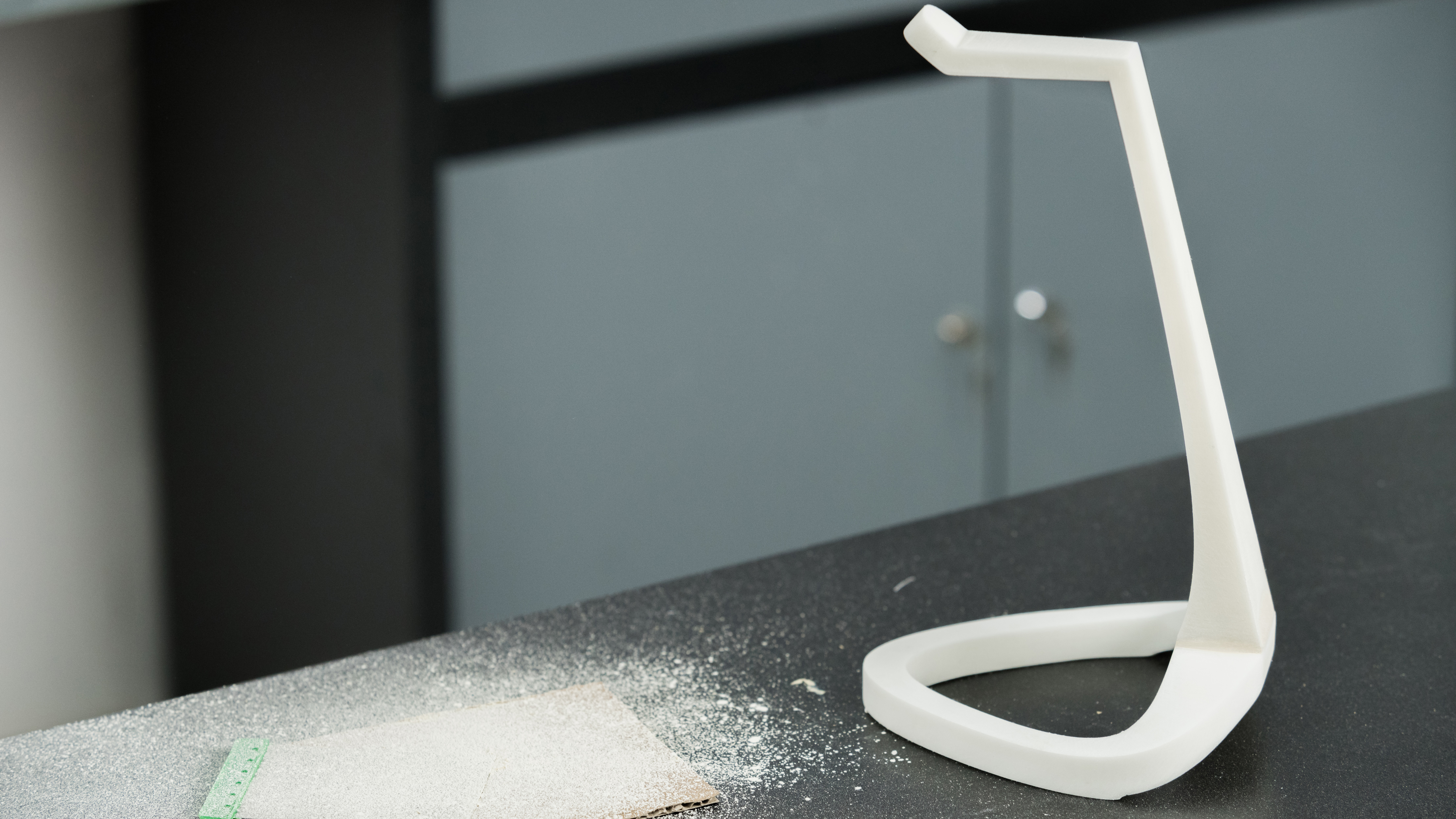

Sanding the Model

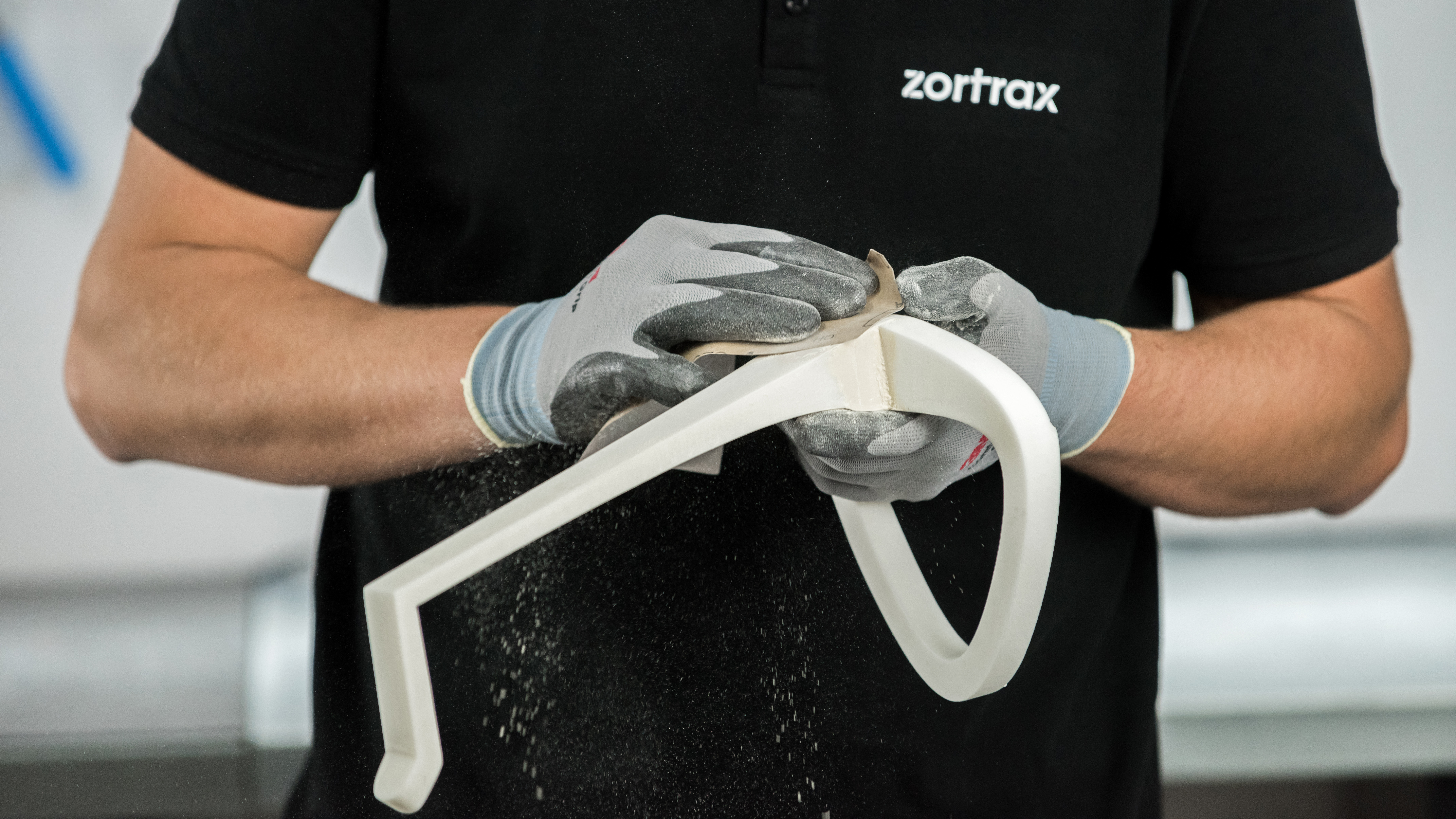

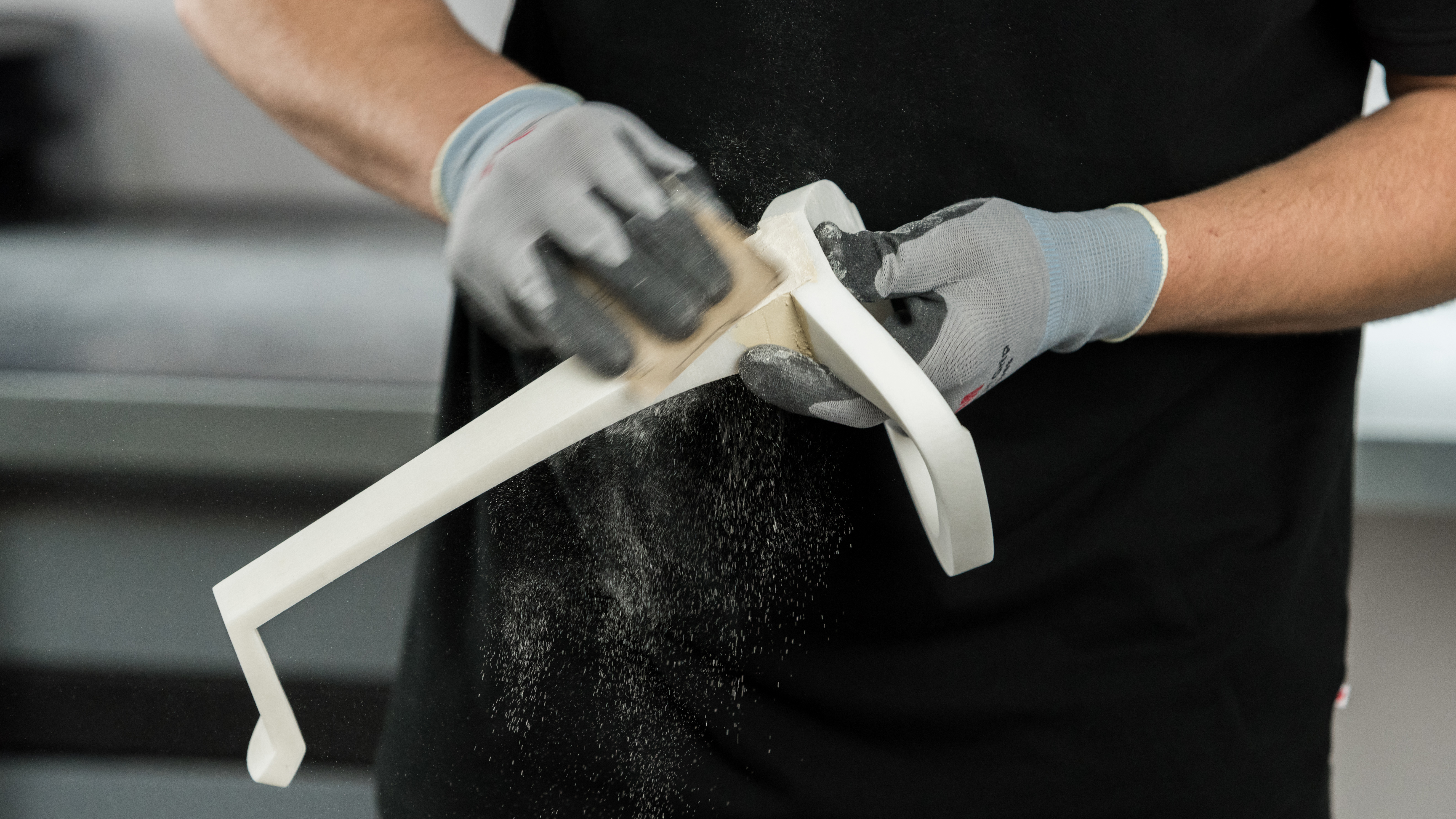

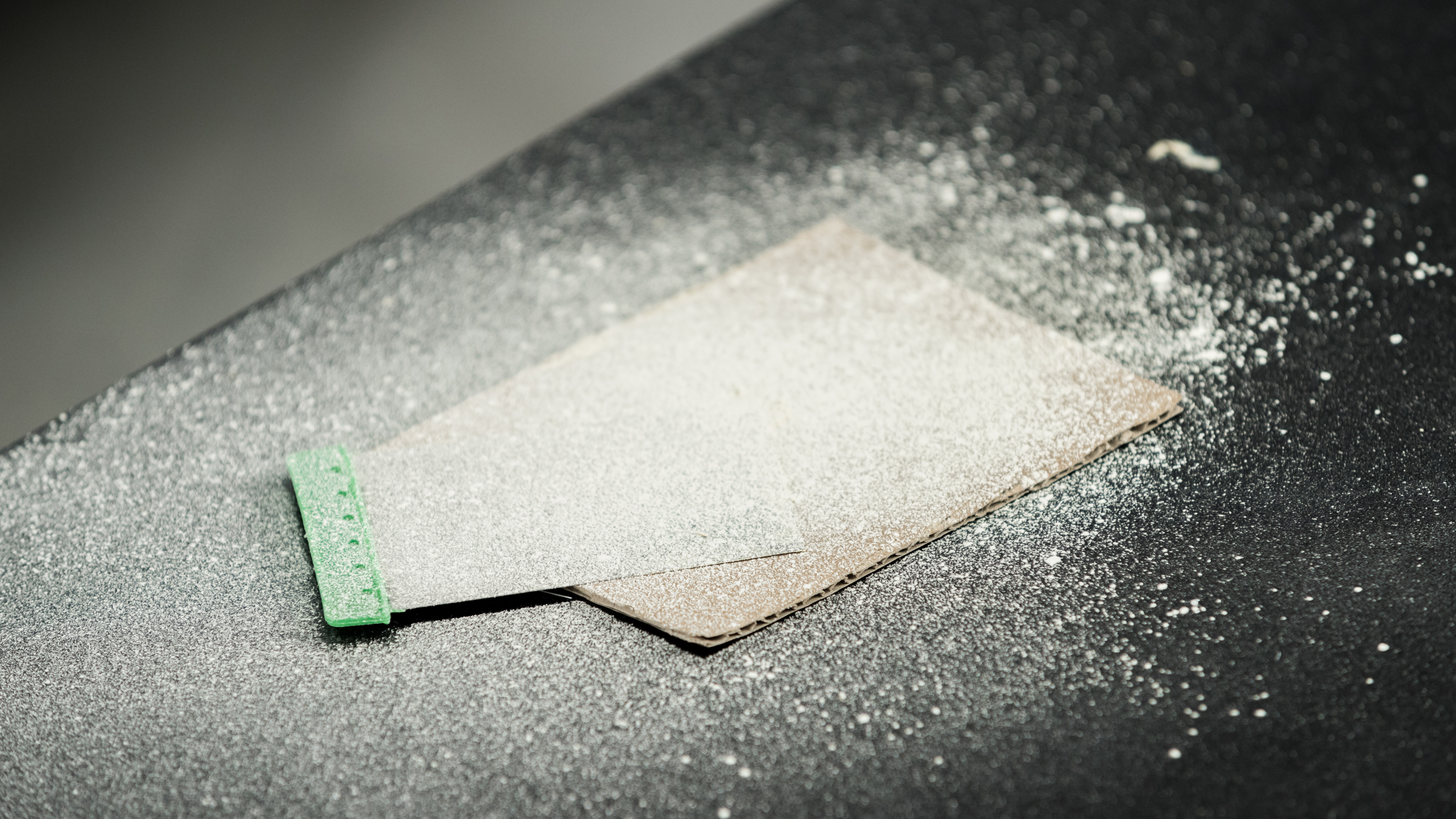

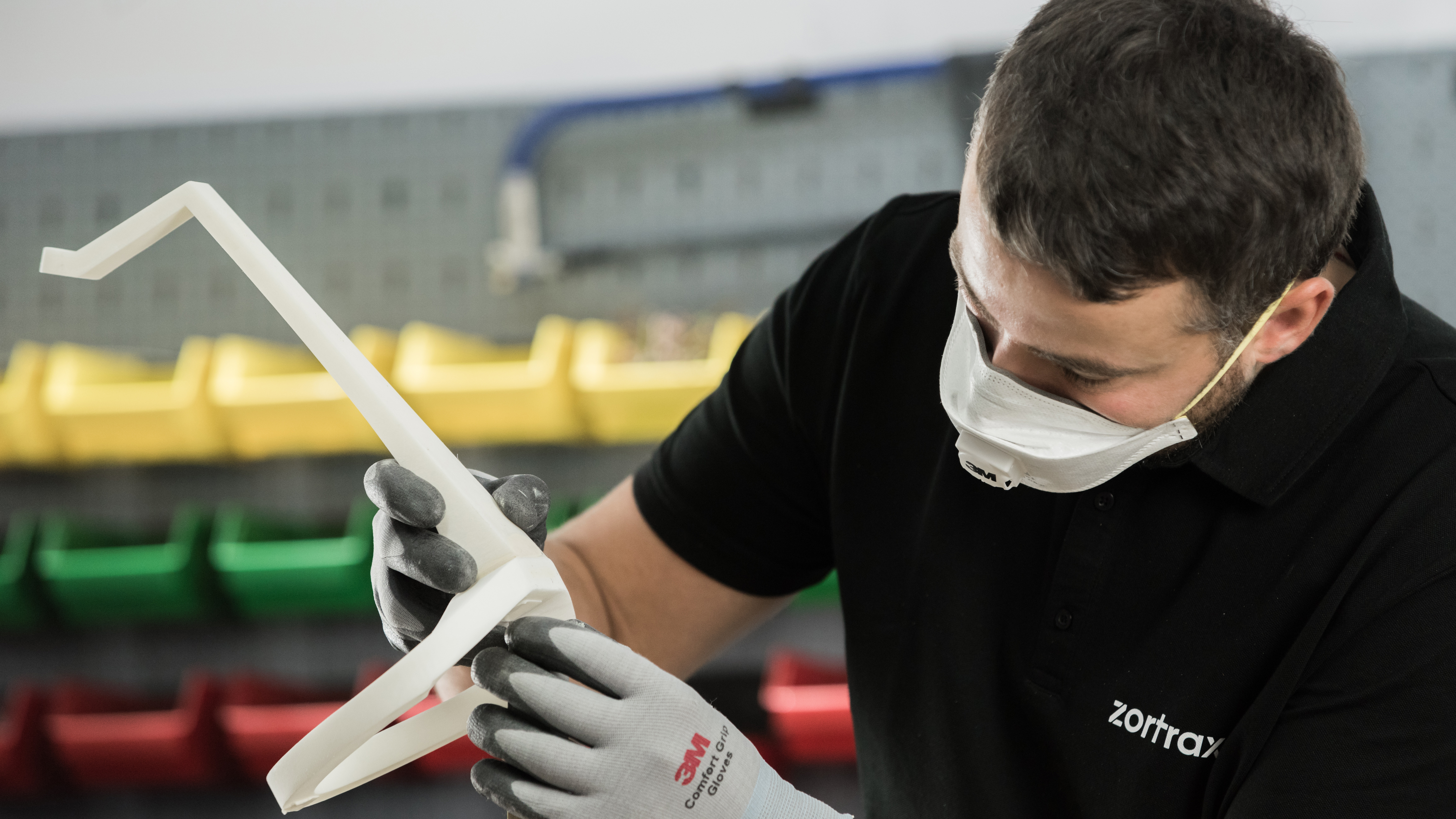

Take time to smooth all the elements of your model thoroughly.
Use sandpaper of 320 grit. Finer one will leave scratches on the surface of the model and such imperfections will be visible, even under a layer of paint.

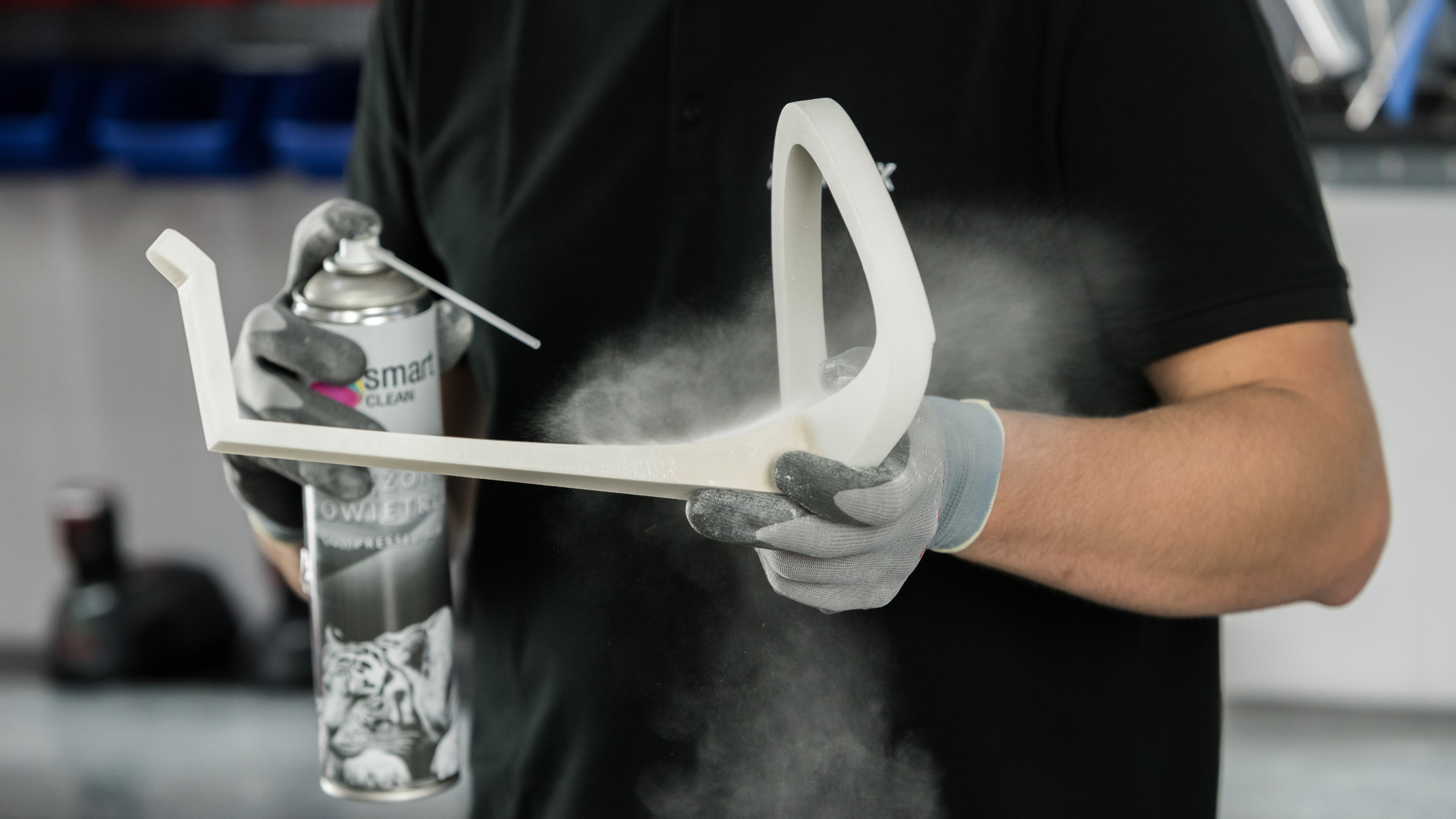

Once you’re done, dust the model off with compressed air.

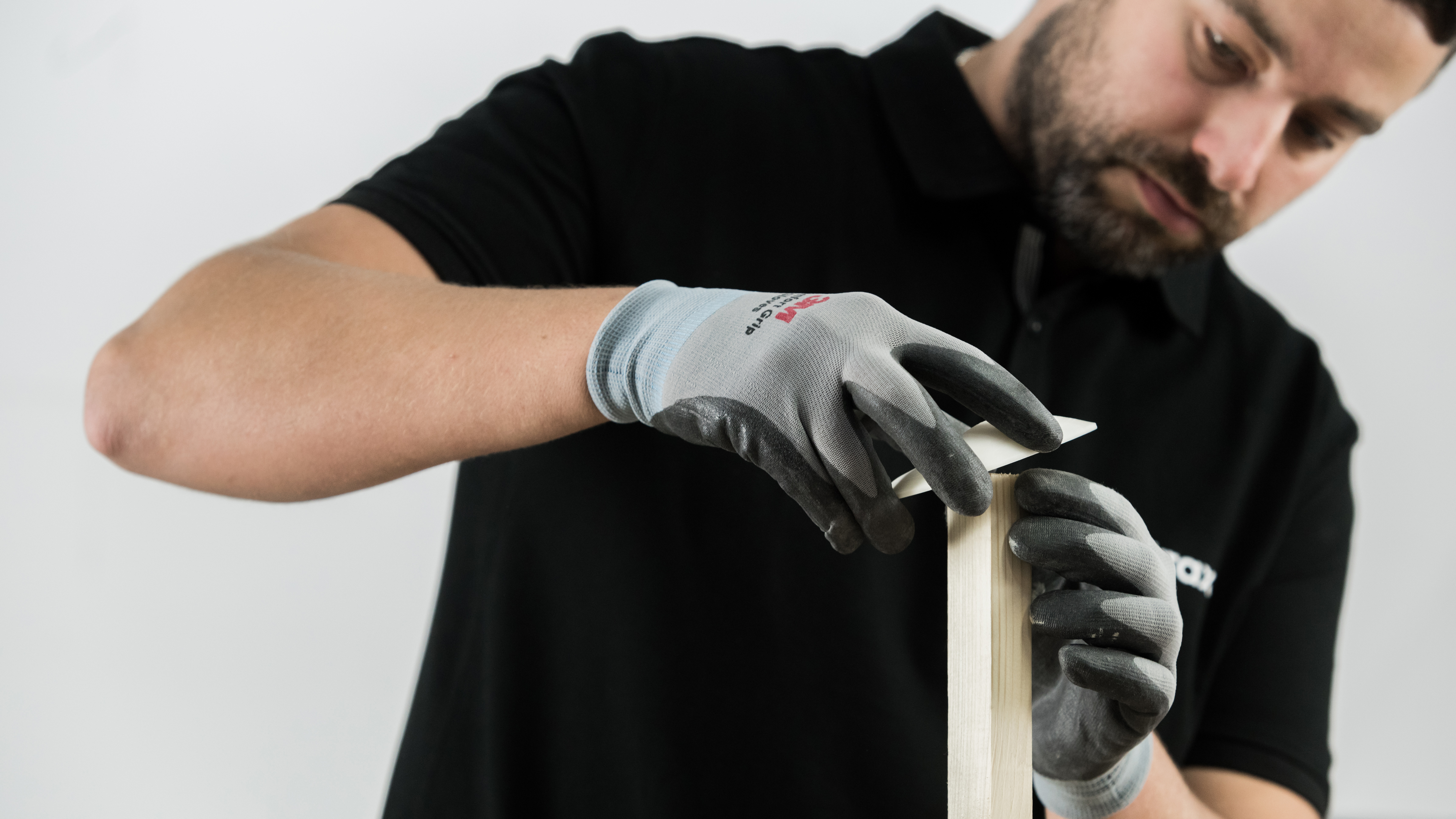

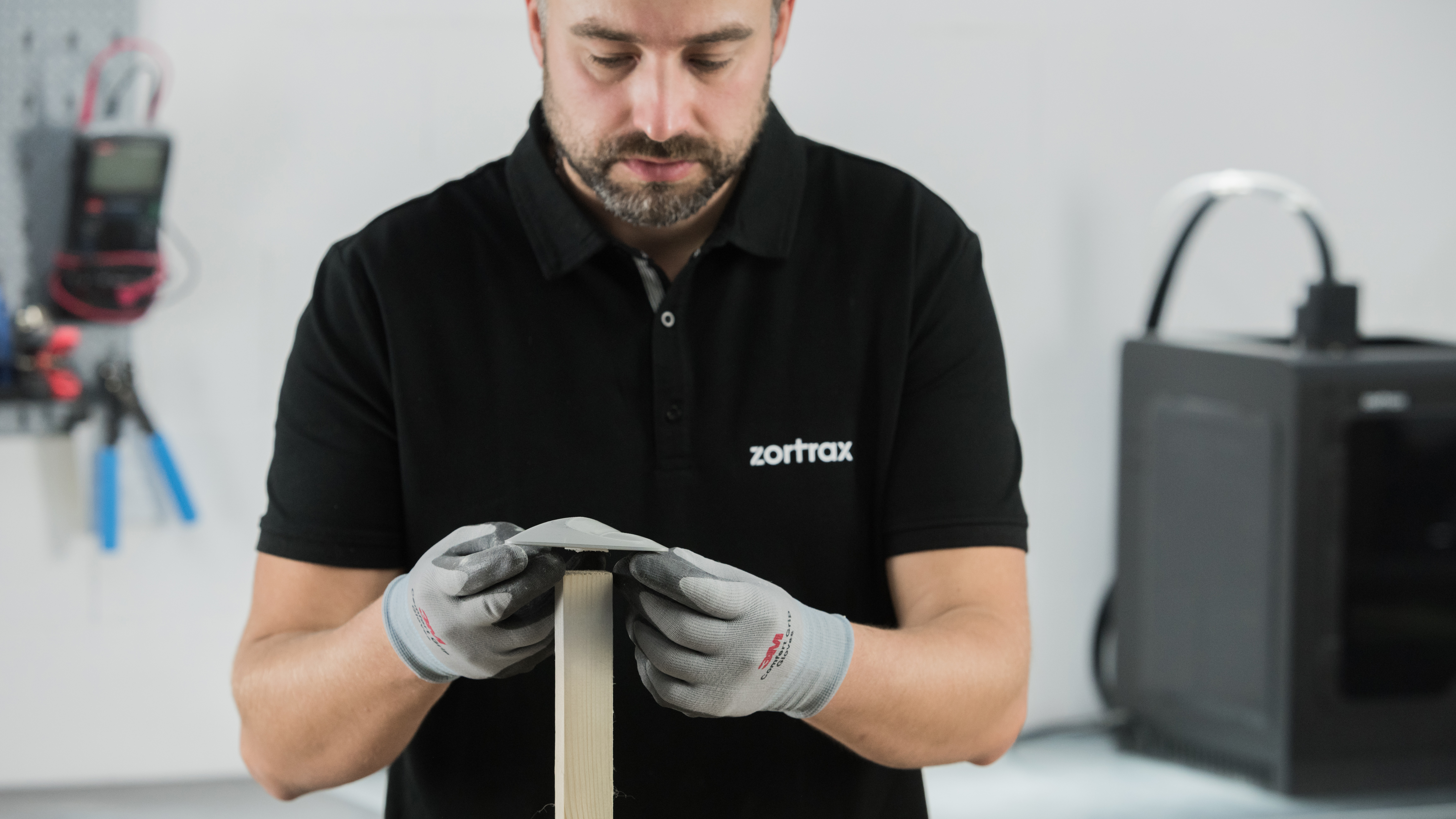

Set your model firmly on the rack with a piece of adhesive tape. The model shouldn’t move and it has to be easily accessible from any side.

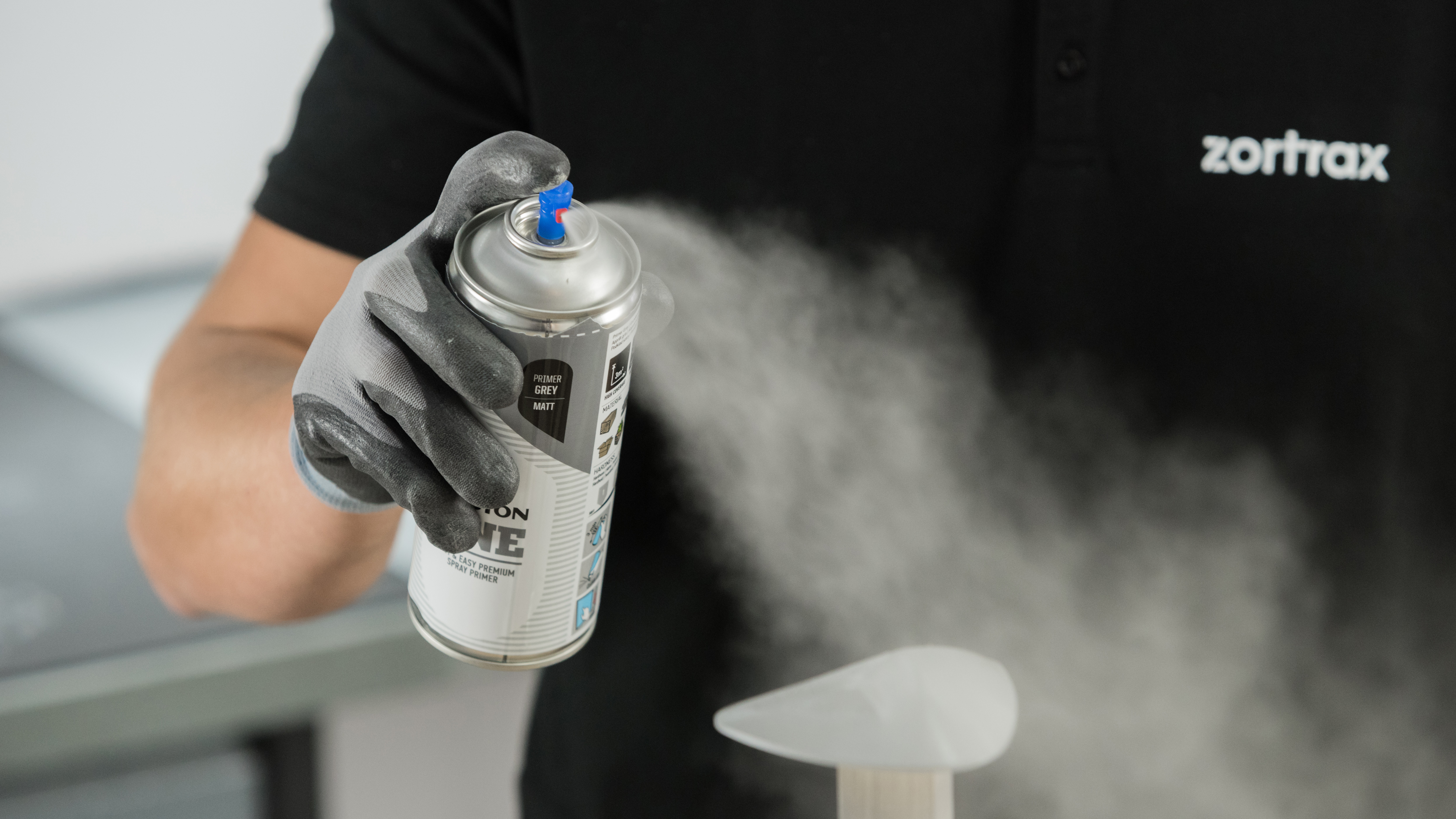

Shake the can well for three minutes and begin to apply the primer onto the hard-to-reach areas and then onto the whole model.
At first, apply two thin layers. Wait about three minutes and apply two more.

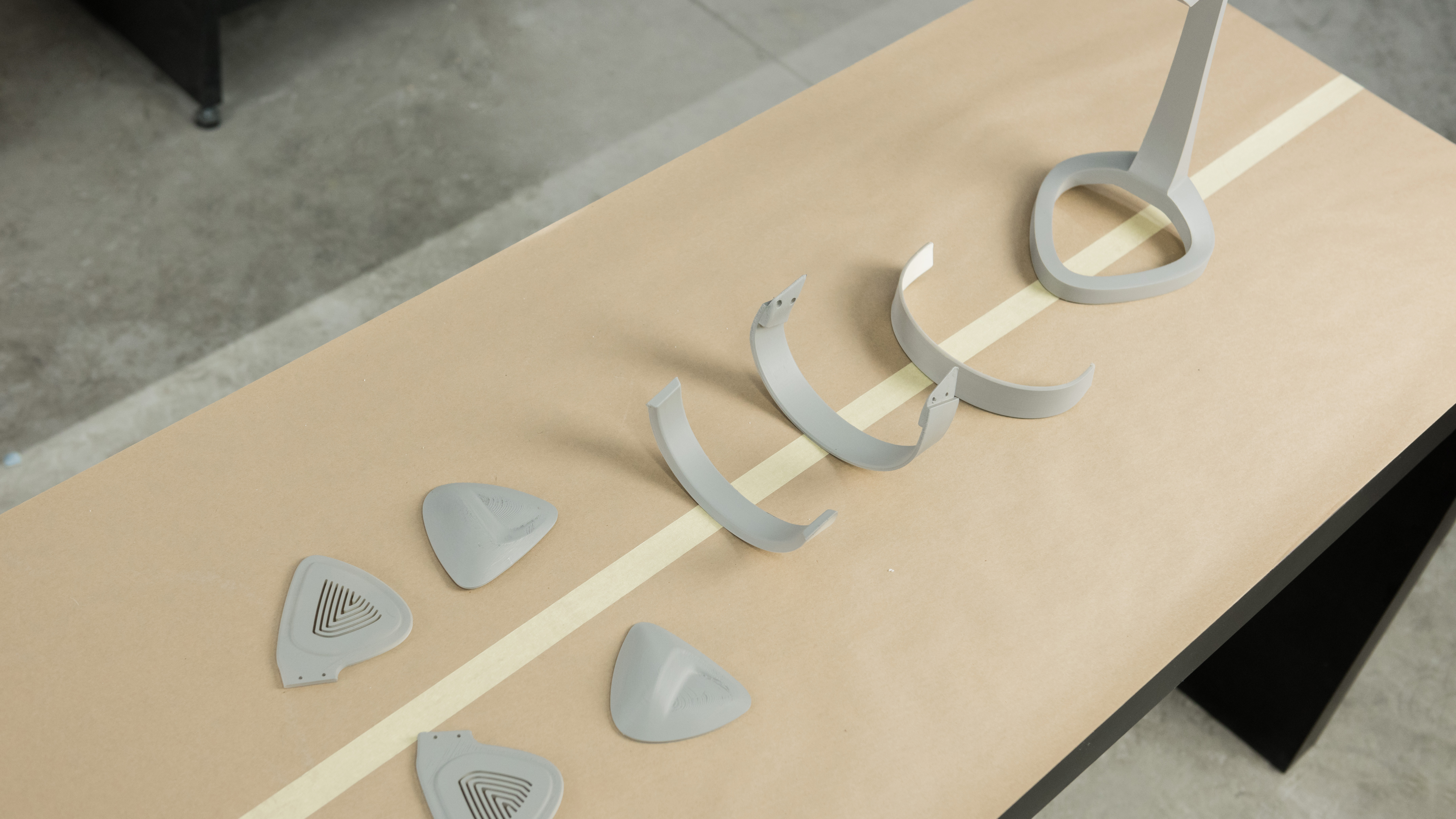

Leaving the Model to Dry
Leave the elements to dry for about 20 minutes at room temperature.
