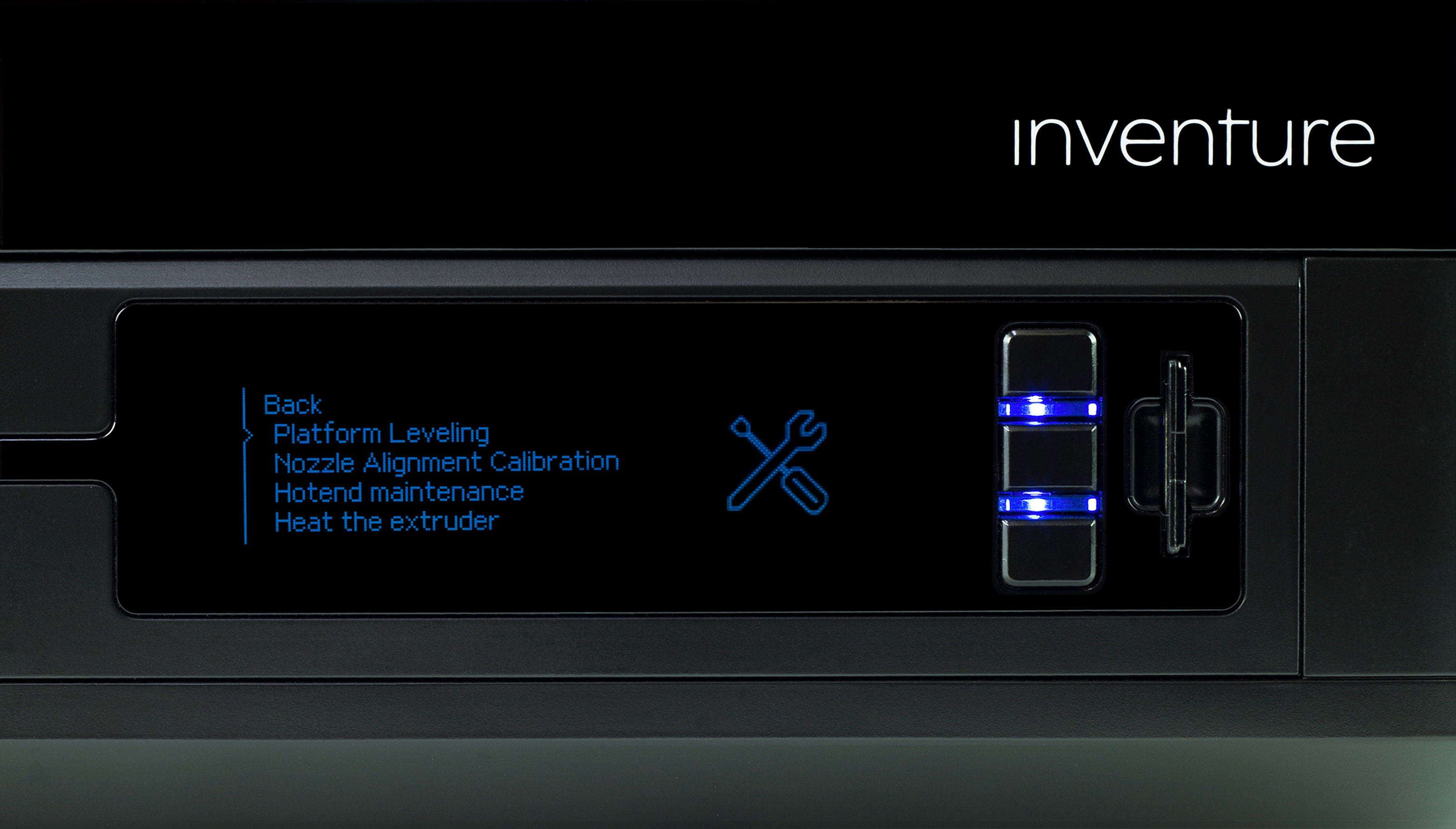

From the menu select “Maintenance” -> “Platform Leveling.”

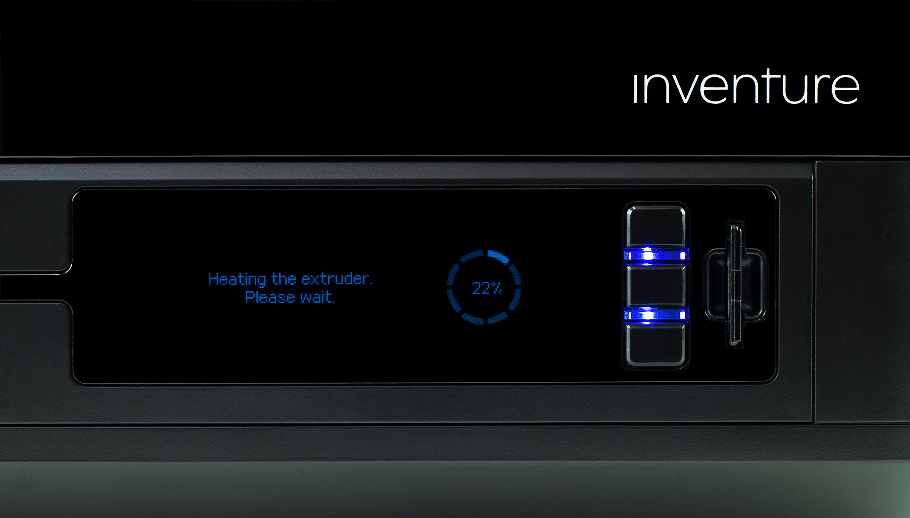

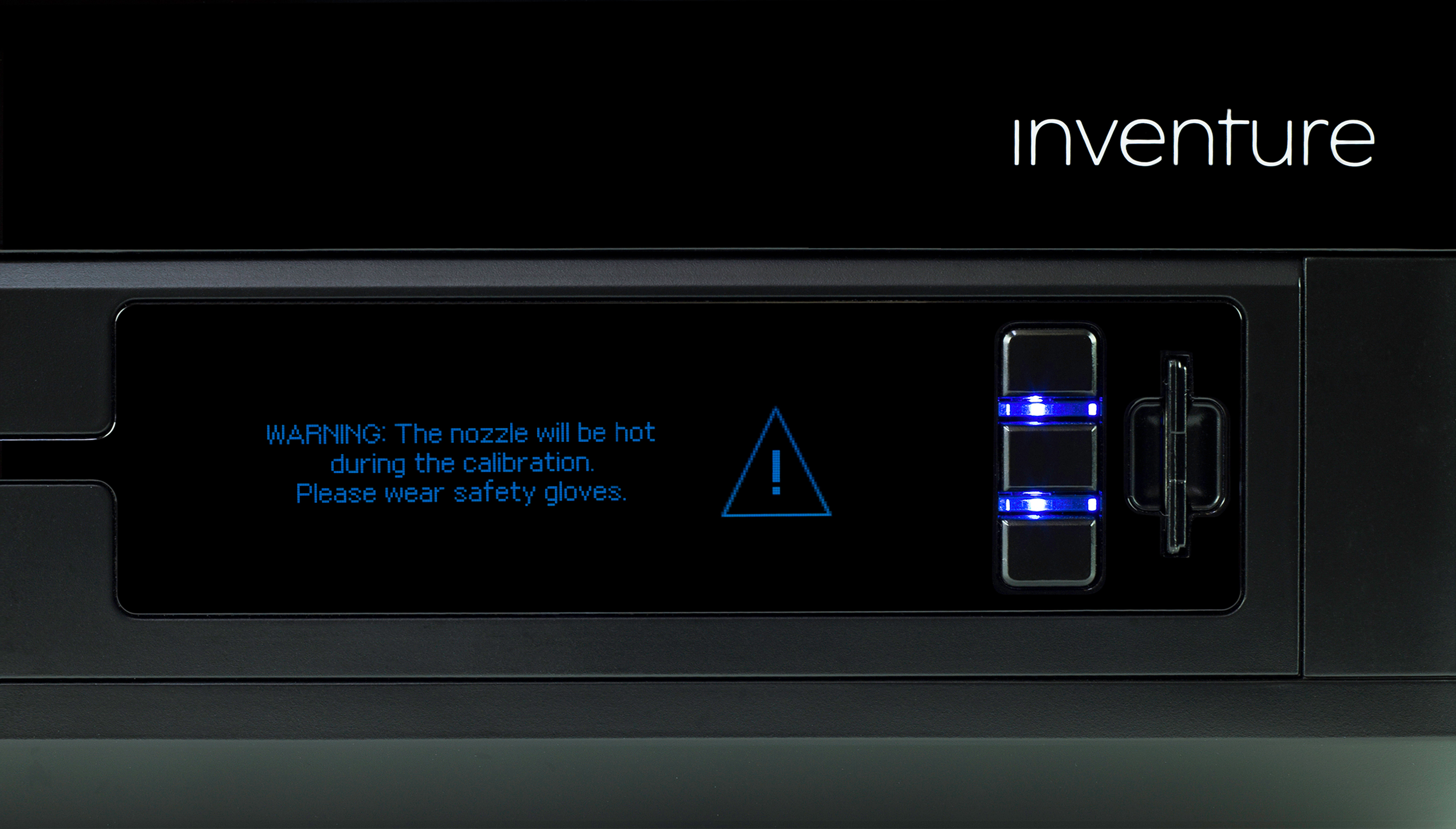

At this point the printer will begin to heat up the extruder.

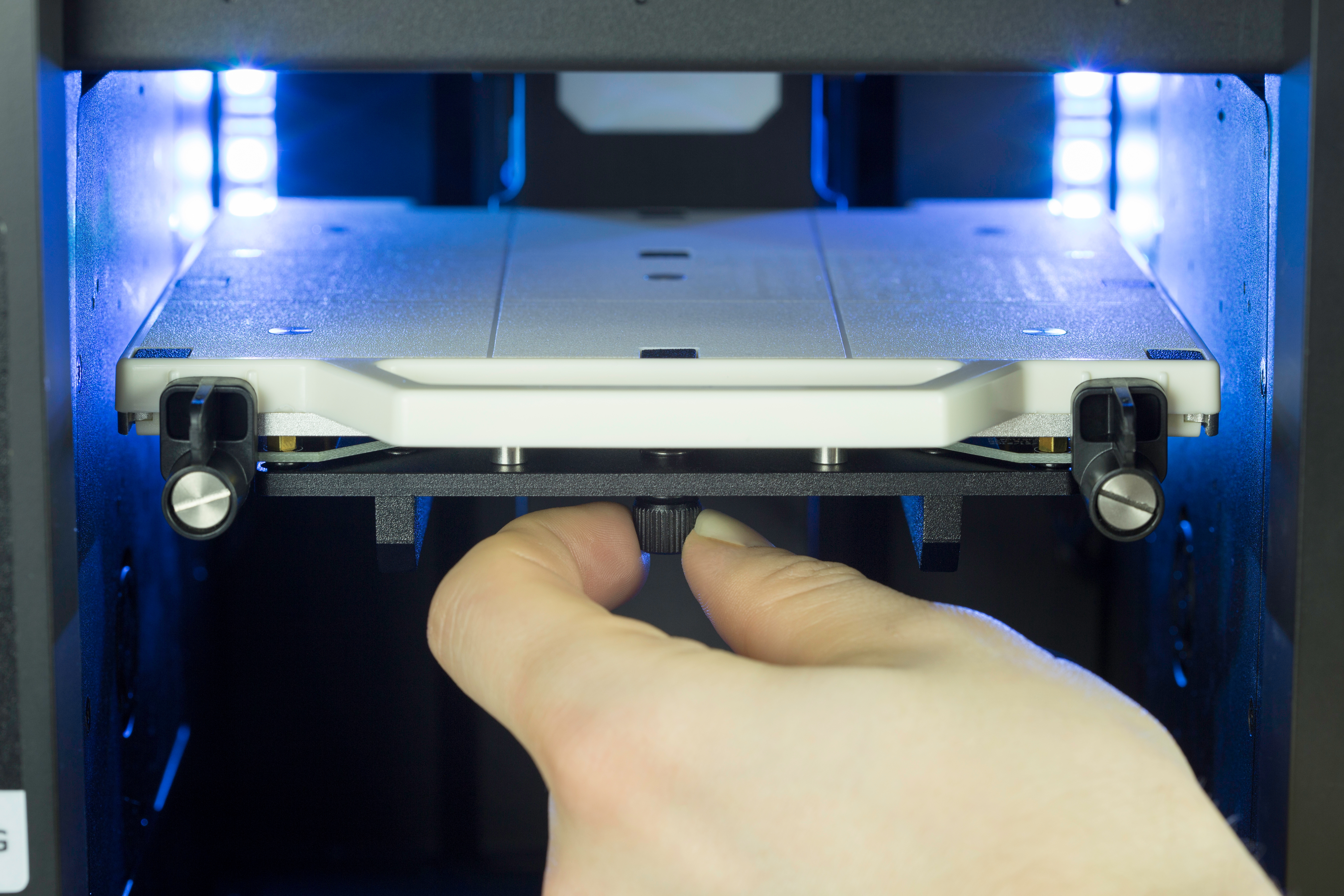

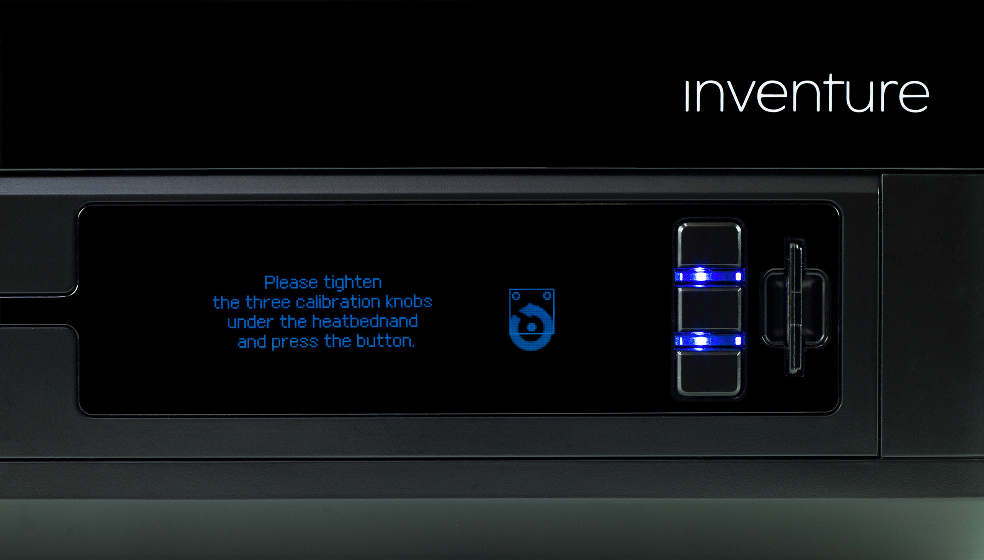

At this moment the printer will lift up the platform and check the distance between the nozzle and the center point of the platform. Next, the display will show a message indicating that the three calibration screws placed under the platform need to be tightened. Once you’ve tightened the screws, push the middle button to continue.

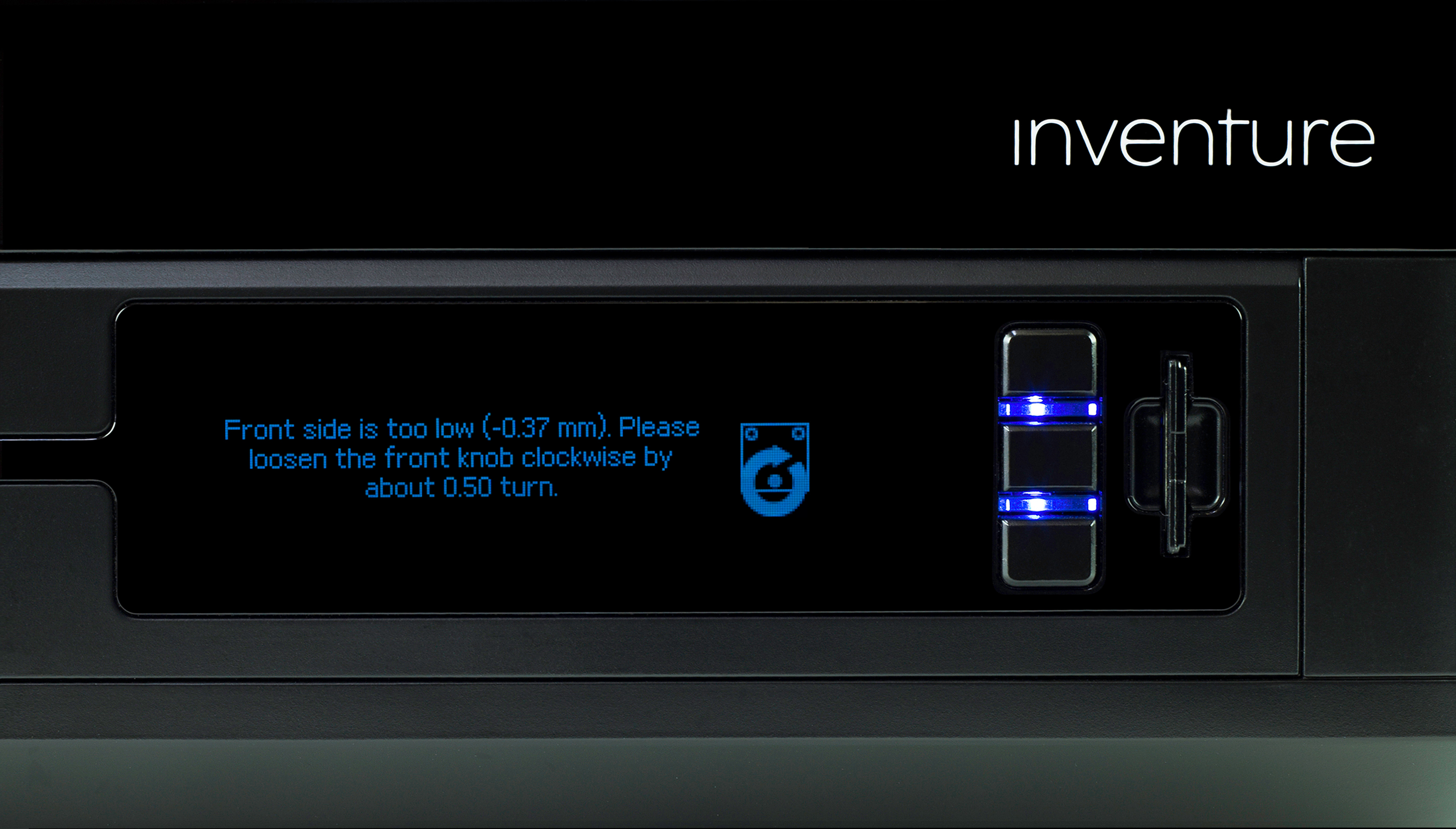

Distance Corrections
If the printer detects an incorrect distance in any of these points, the display will show instructions on what adjustments should be made.

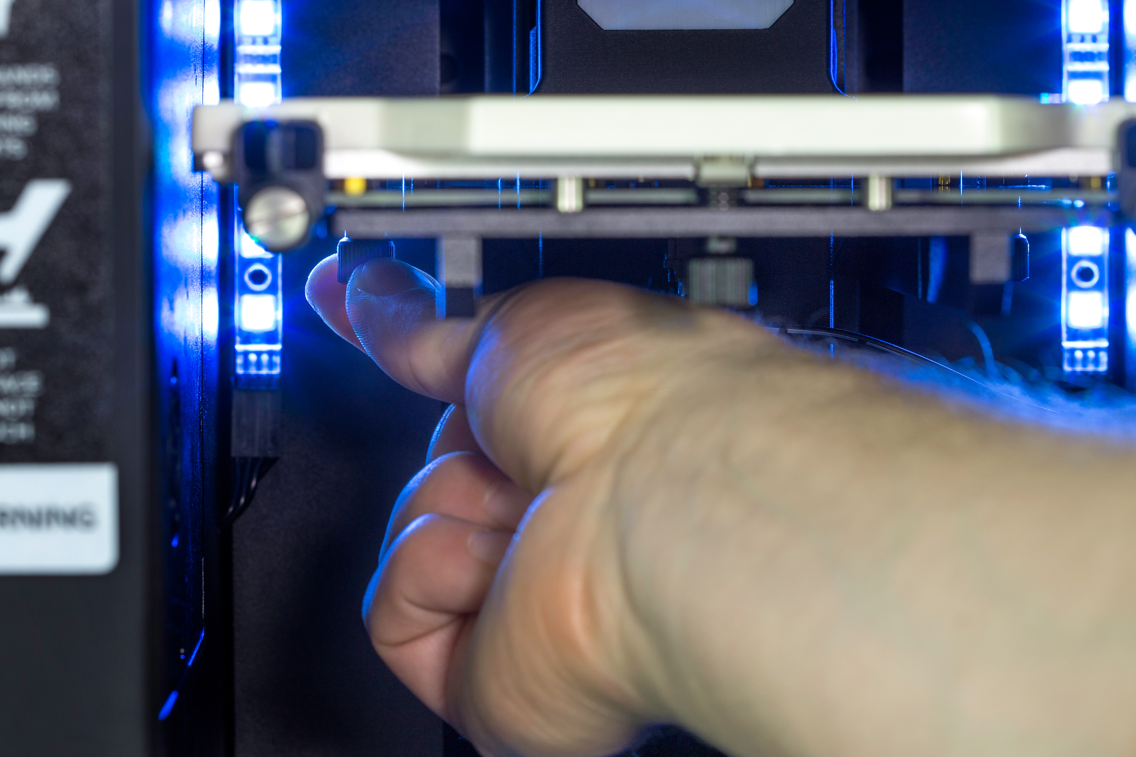

Follow the instructions and tighten or loosen the screw indicated in the message.
Turn the screw slightly, only by a few degrees. Once you finish, push the middle button and the printer will recheck a given point on the platform.
If the distance between the nozzle and five points is set within the acceptable limits, the printer will finish the calibration procedure.
Additionally, the display will show the calibration results.
