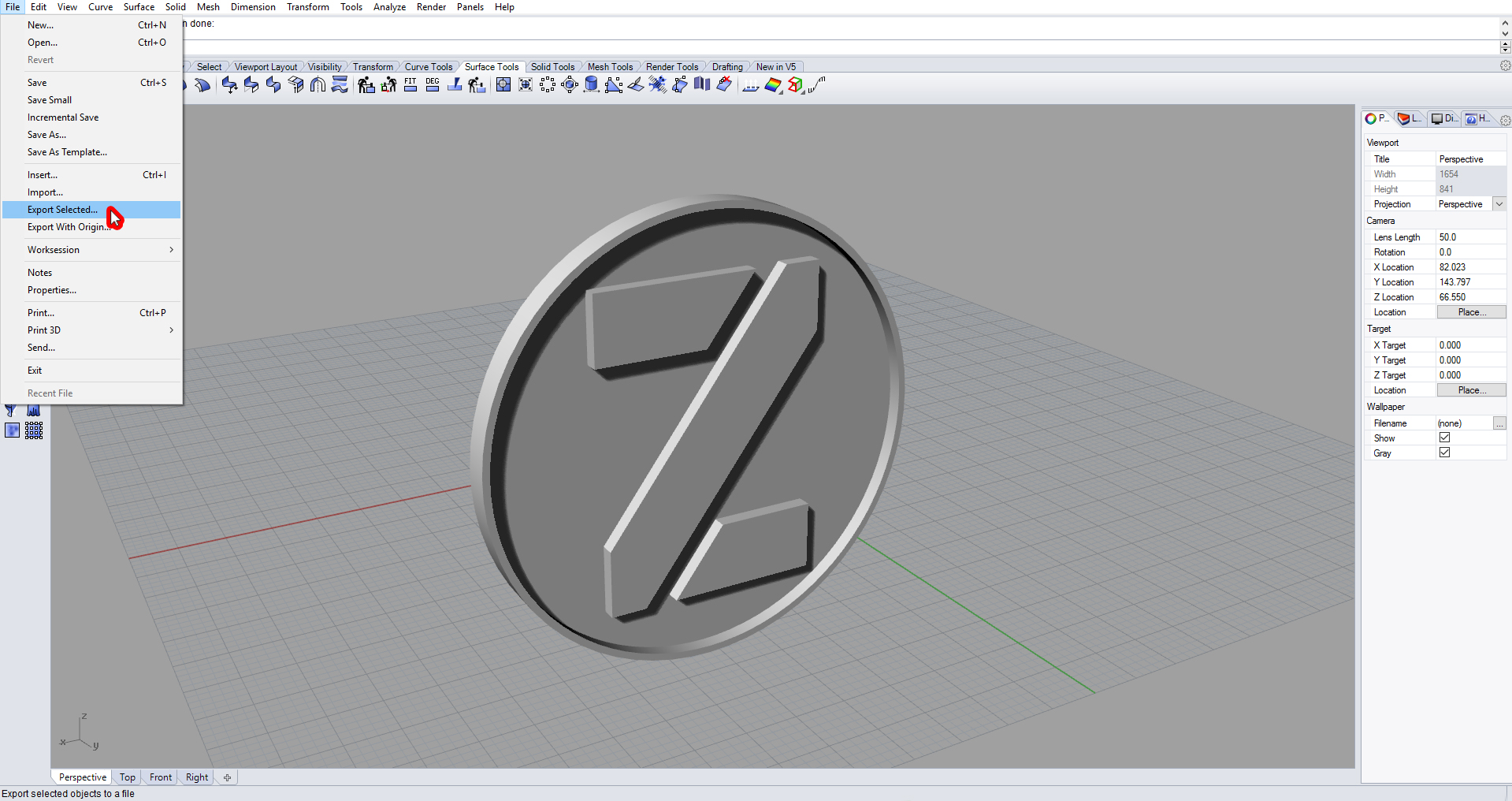

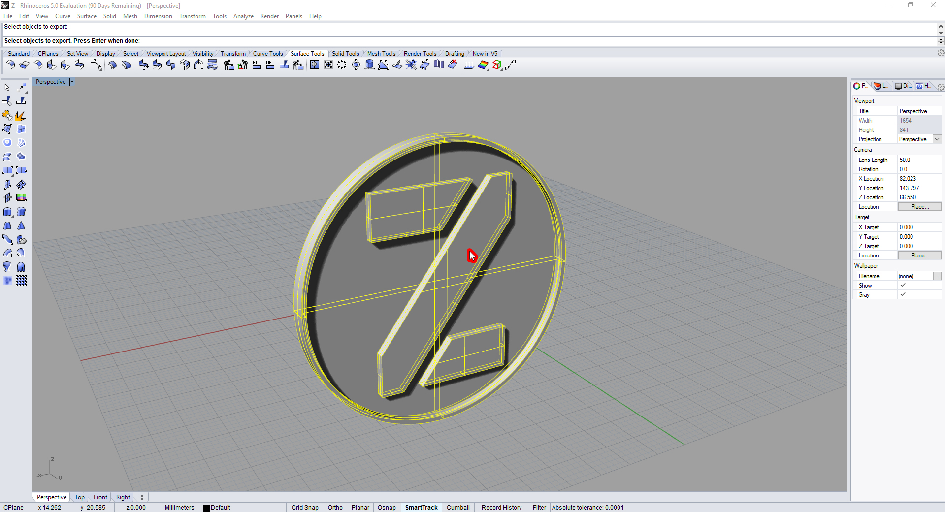

Rhinoceros

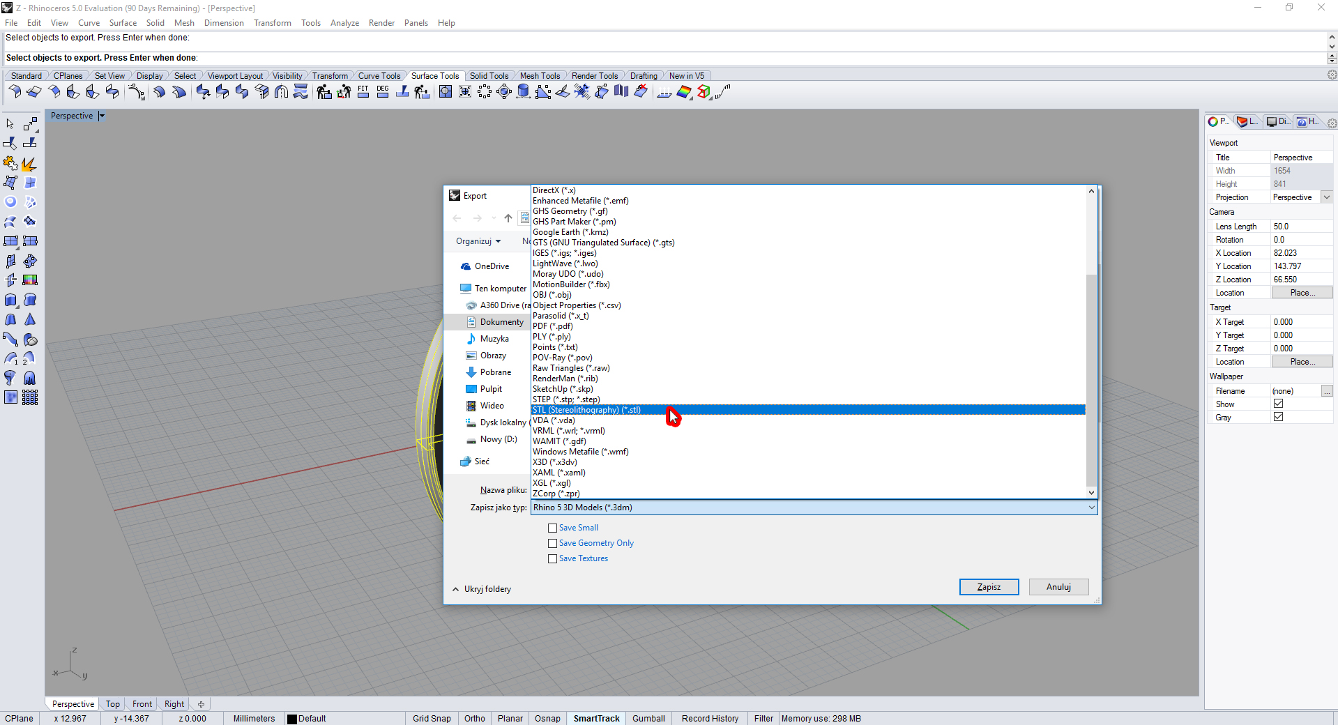

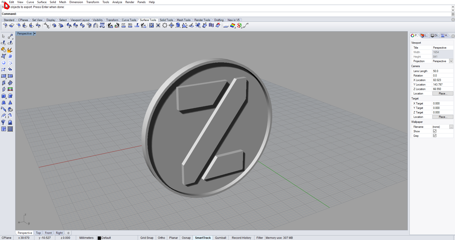

Rhinoceros allows exporting STL files in two ways:
-from the menu bar, select File > Export Selected. Next, select the 3D model which you want export as an STL file, and then press Enter. In the pop-up window, select STL (Stereolitography) (*.stl), and click Save,
-from the menu bar, select File > Save as. In the pop-up window, select STL (Stereolitography) (*.stl), and click Save.

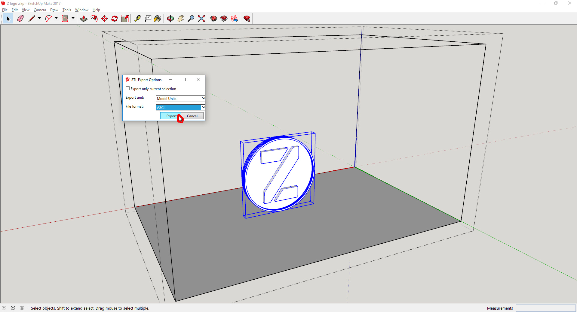

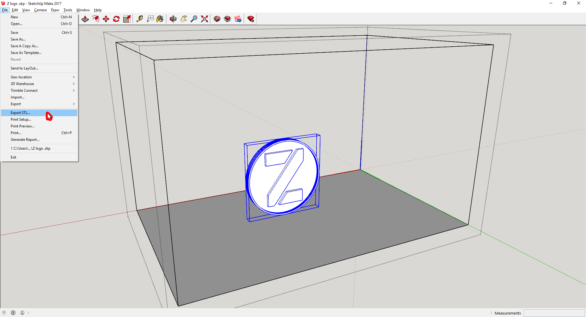

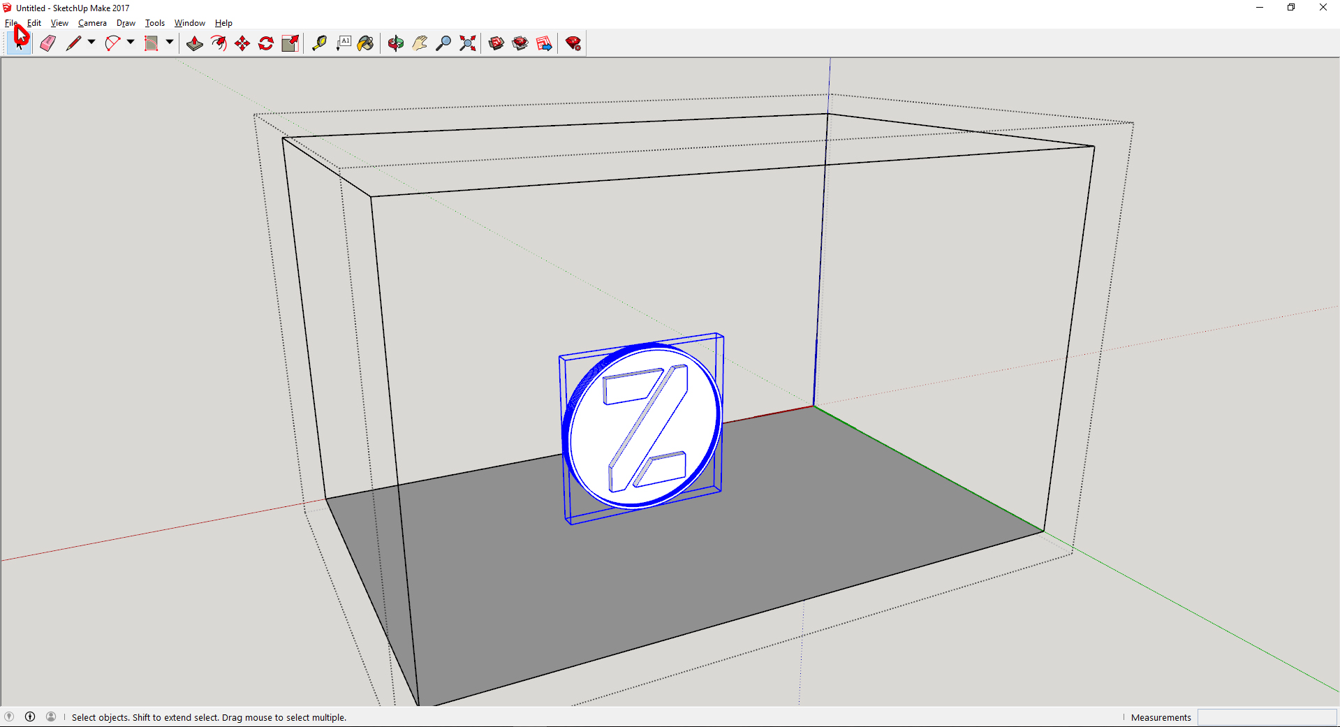

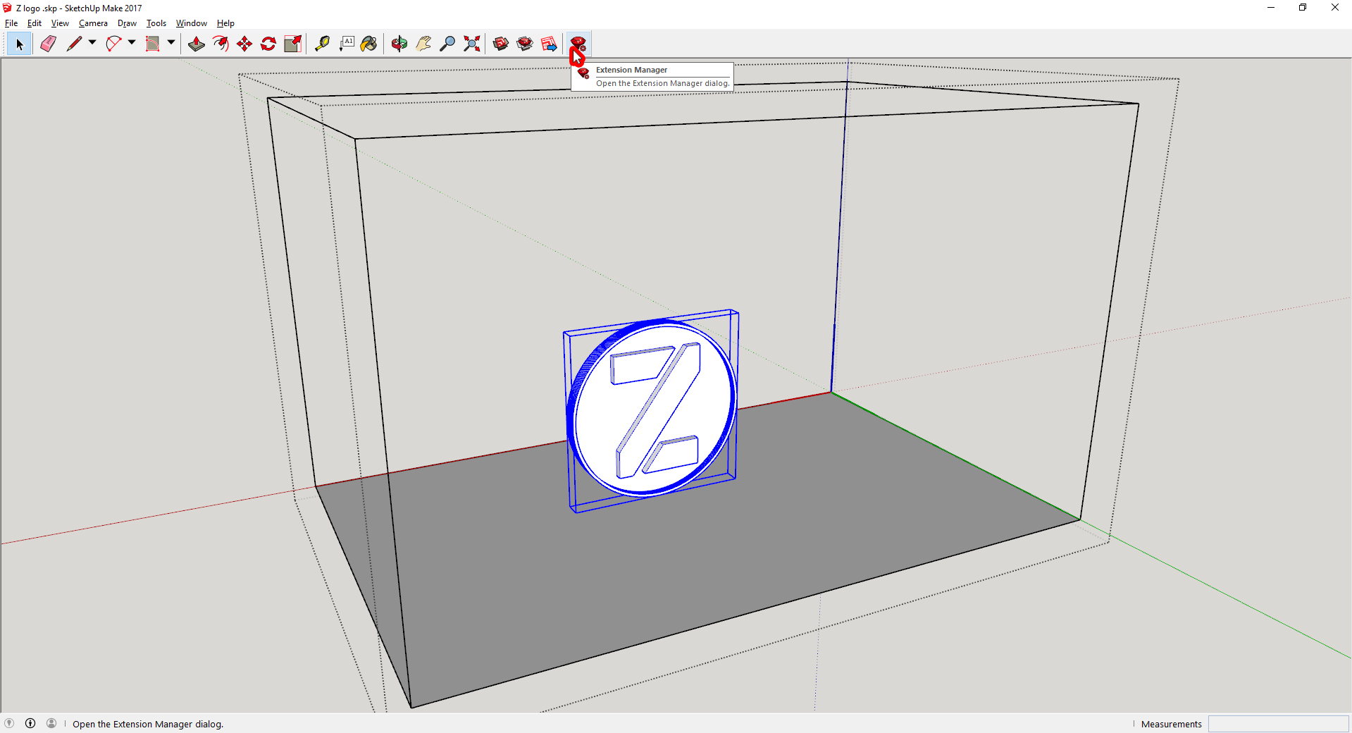

Sketchup

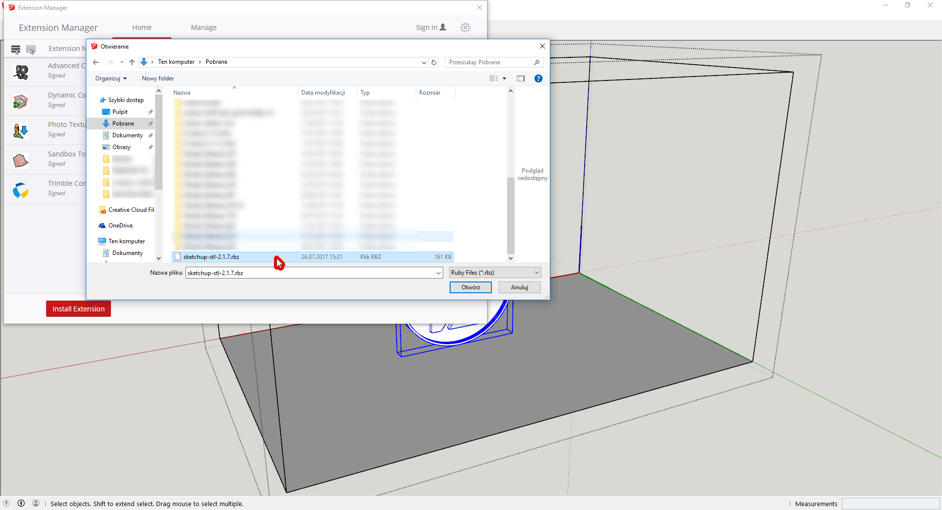

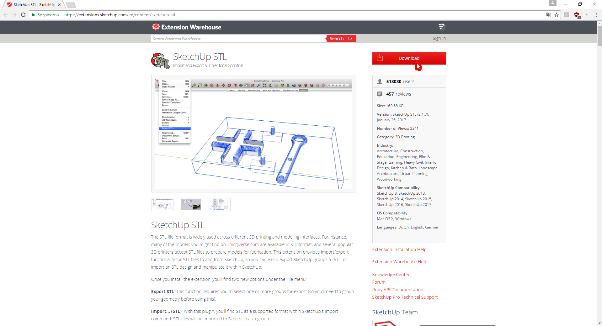

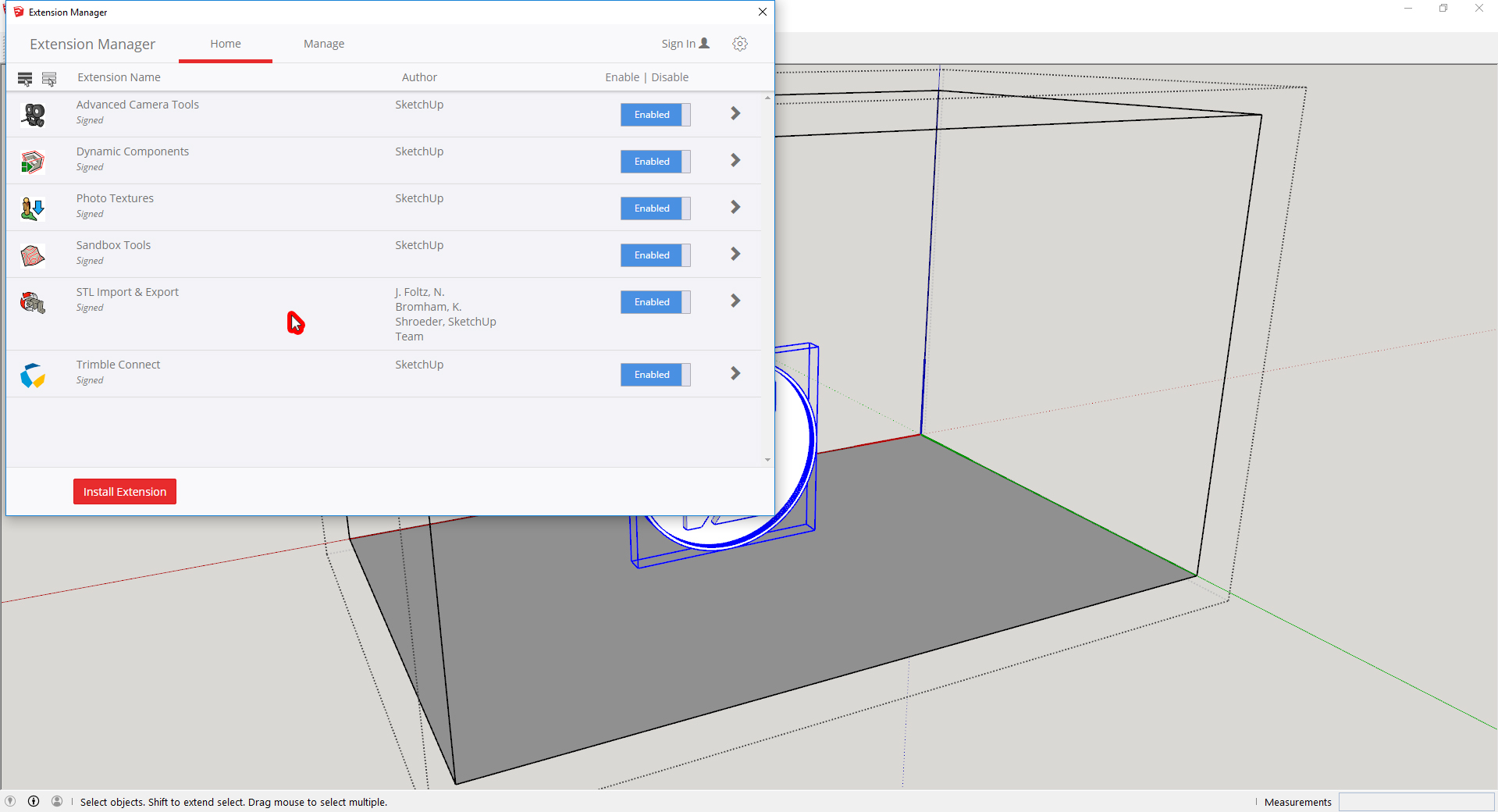

Sketchup requires a special plug-in allowing to export the model as an STL file. The plug-in is available for download here.
From the menu bar in Sketchup, select Extension Manager. In the pop-up window, click Install Extension. From the drop-down list, select the plug-in you’ve just downloaded, and click Open. The plug-in will be installed automatically.
Once you’ve installed the plug-in, select File > Export STL from the menu bar, and click Export.

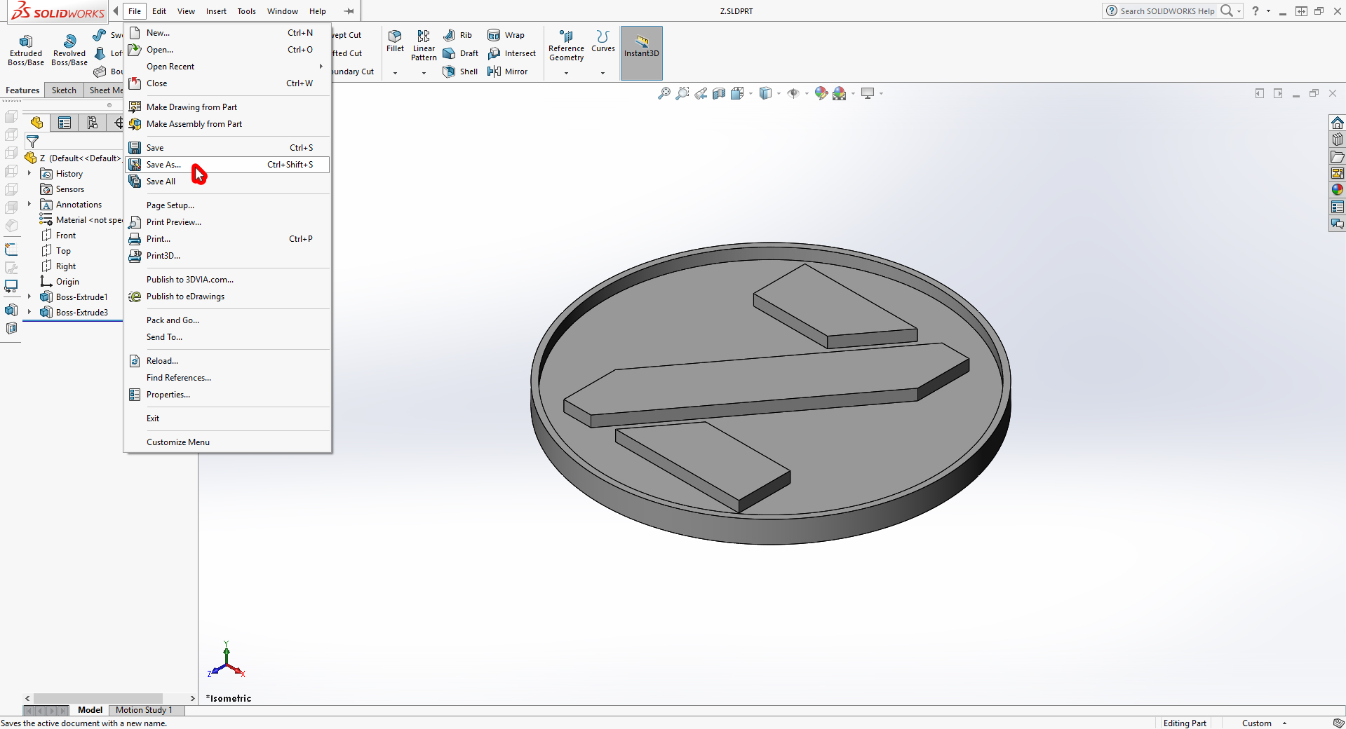

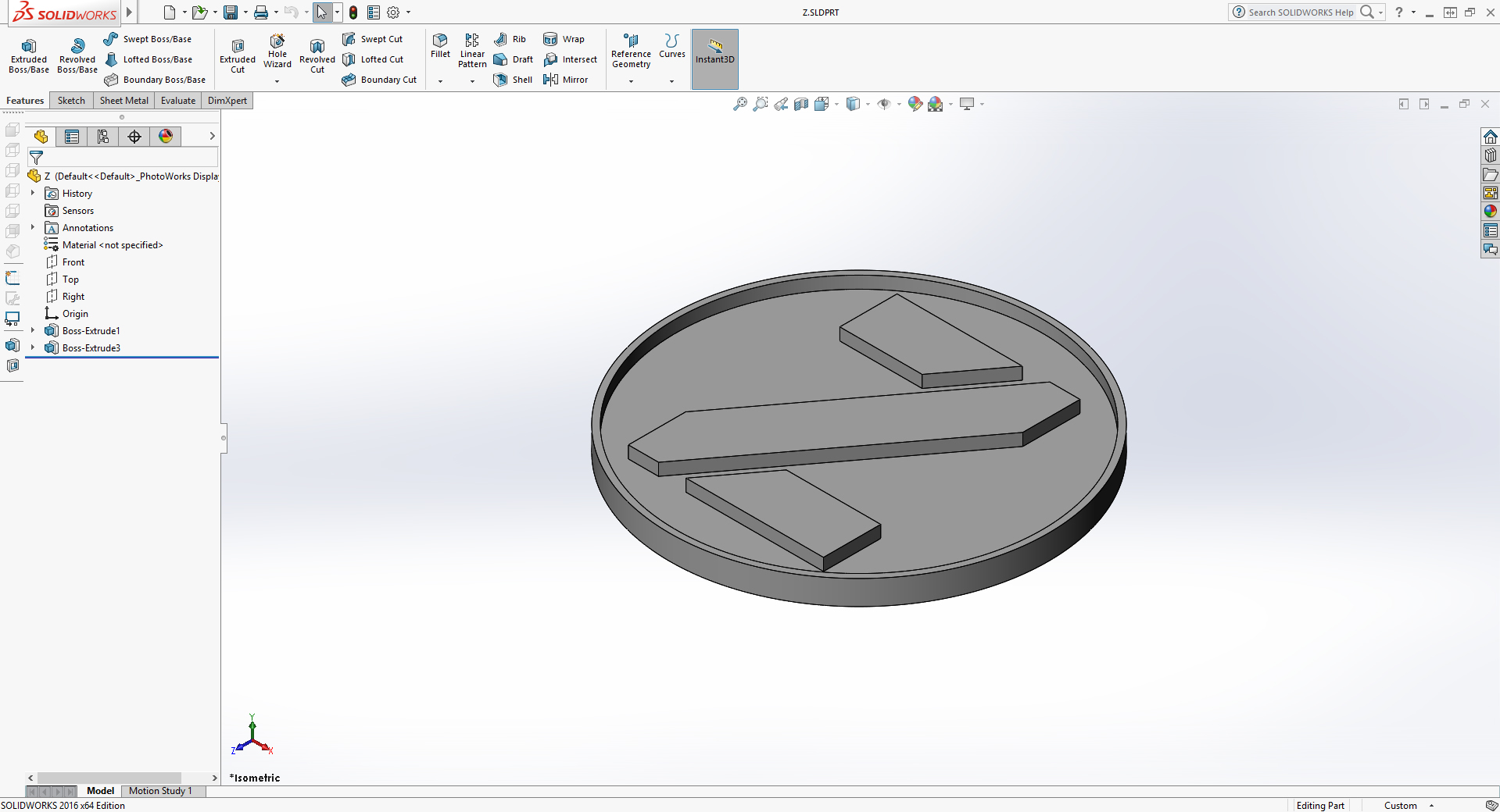

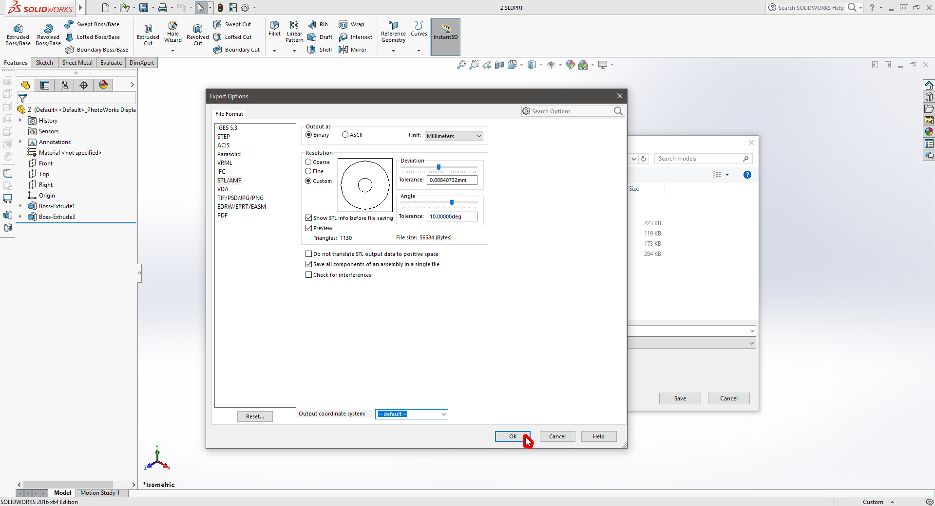

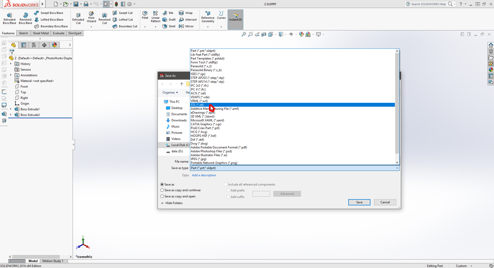

Solidworks
From the menu bar, select File > Save as. Next, choose a location for your file, and from the Save as type drop-down list, select STL (*.stl), and click Save. If you want to increase the number of triangles, before you click Save, select Advanced and adjust the Deviation and Angle sliders to achieve the desired results.
