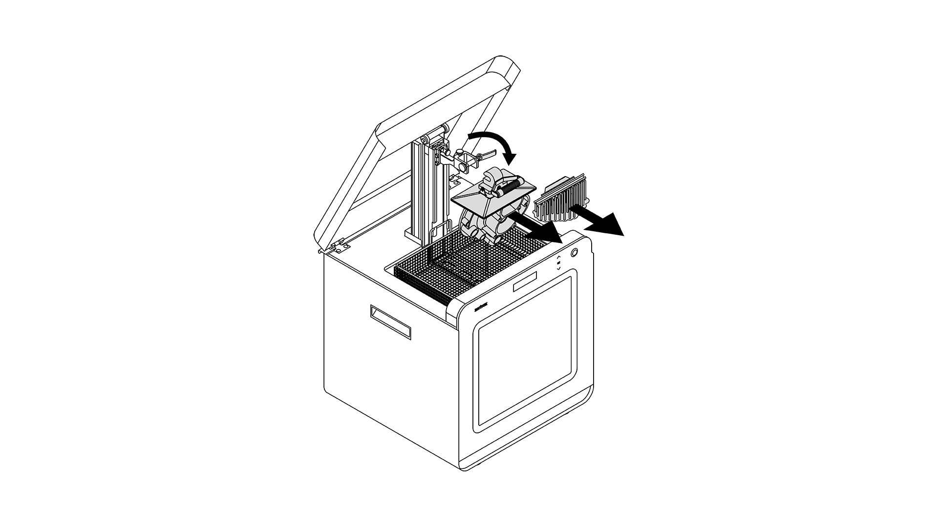

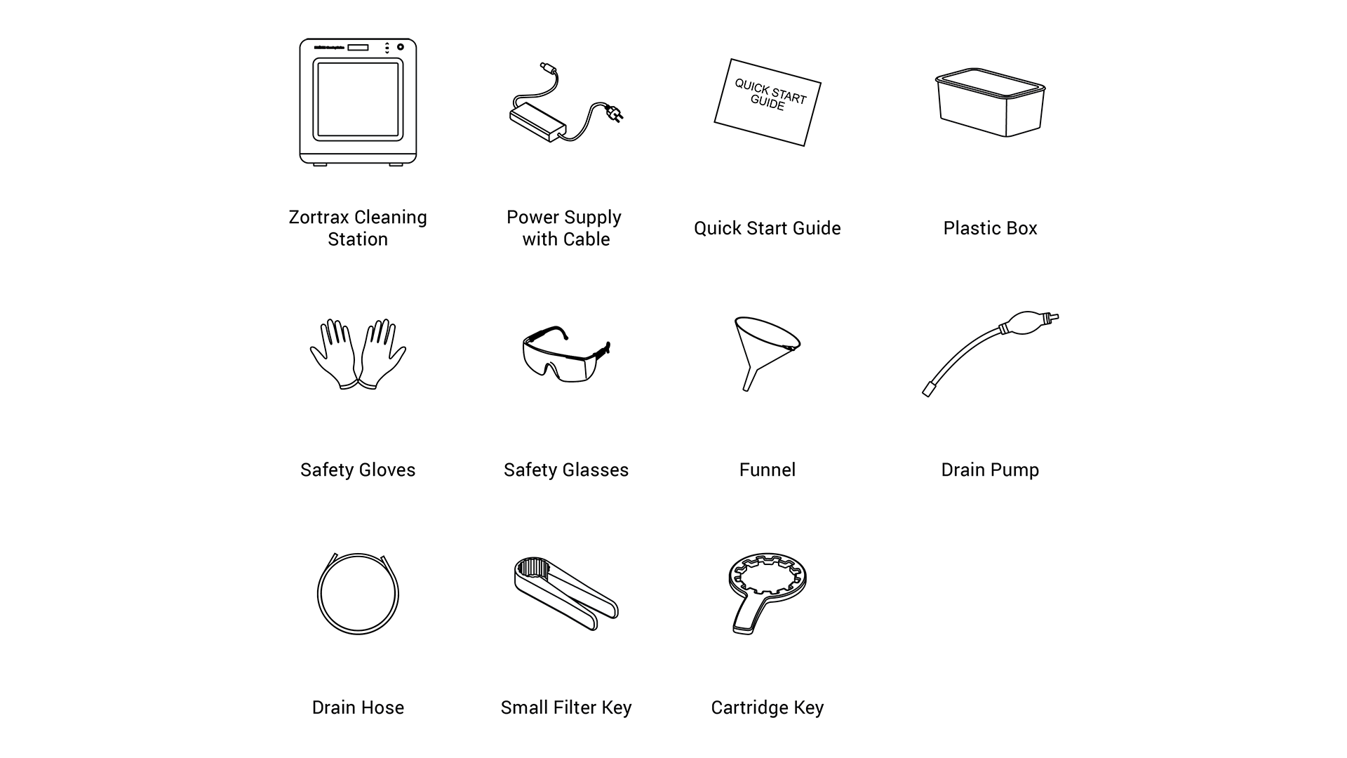

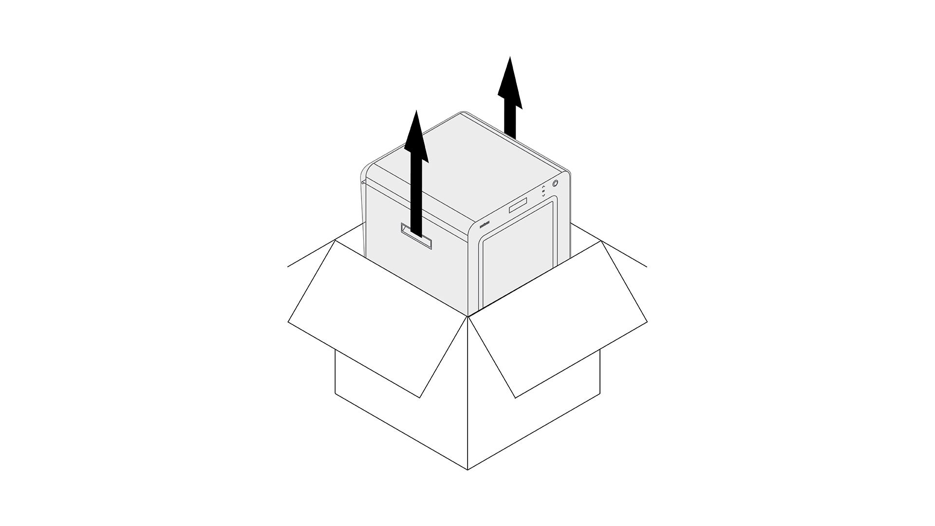

1. Open the shipping box and remove the upper.
2. Take the device out of the box.

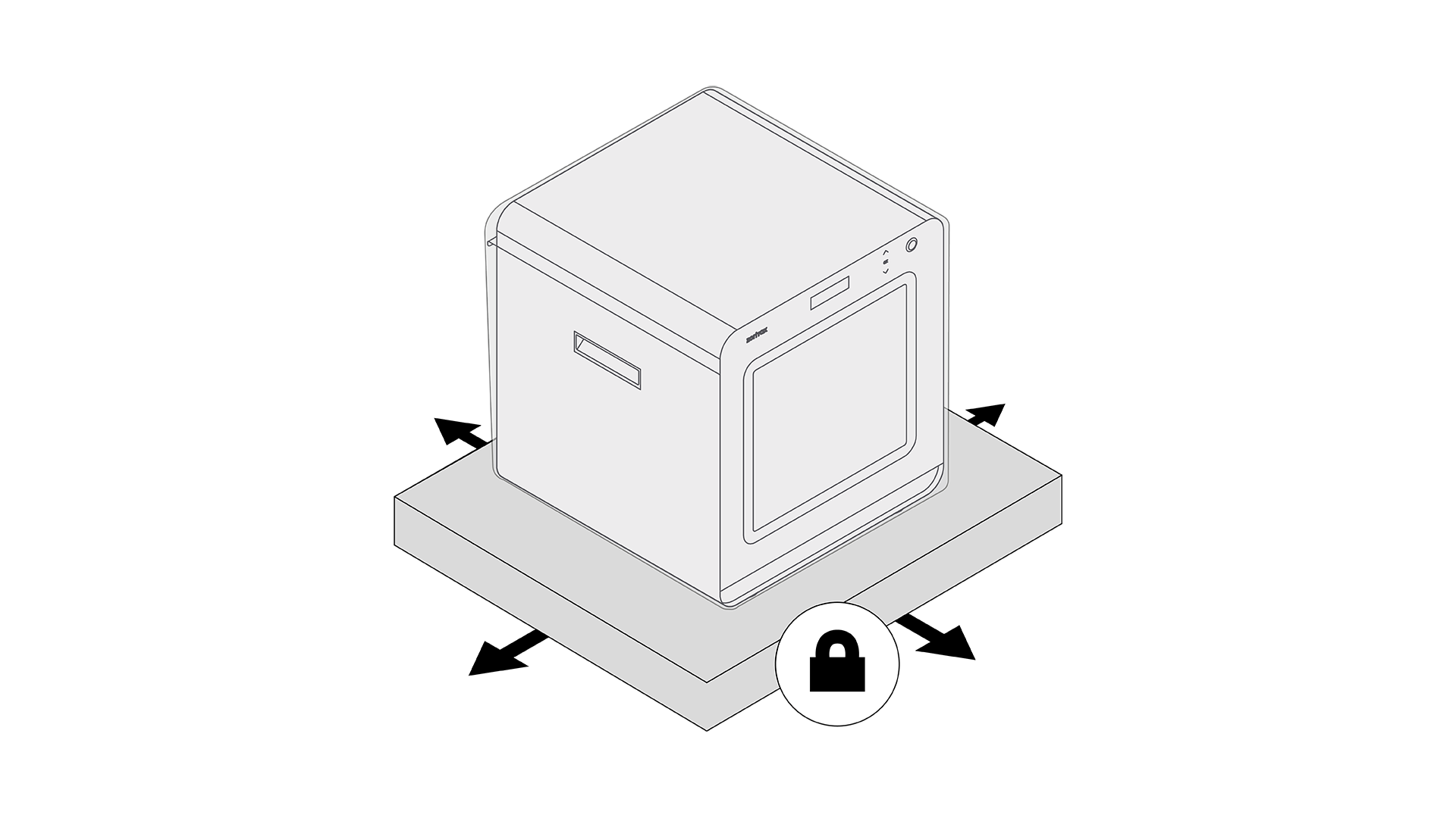

3. Place the device on a flat and stable surface.

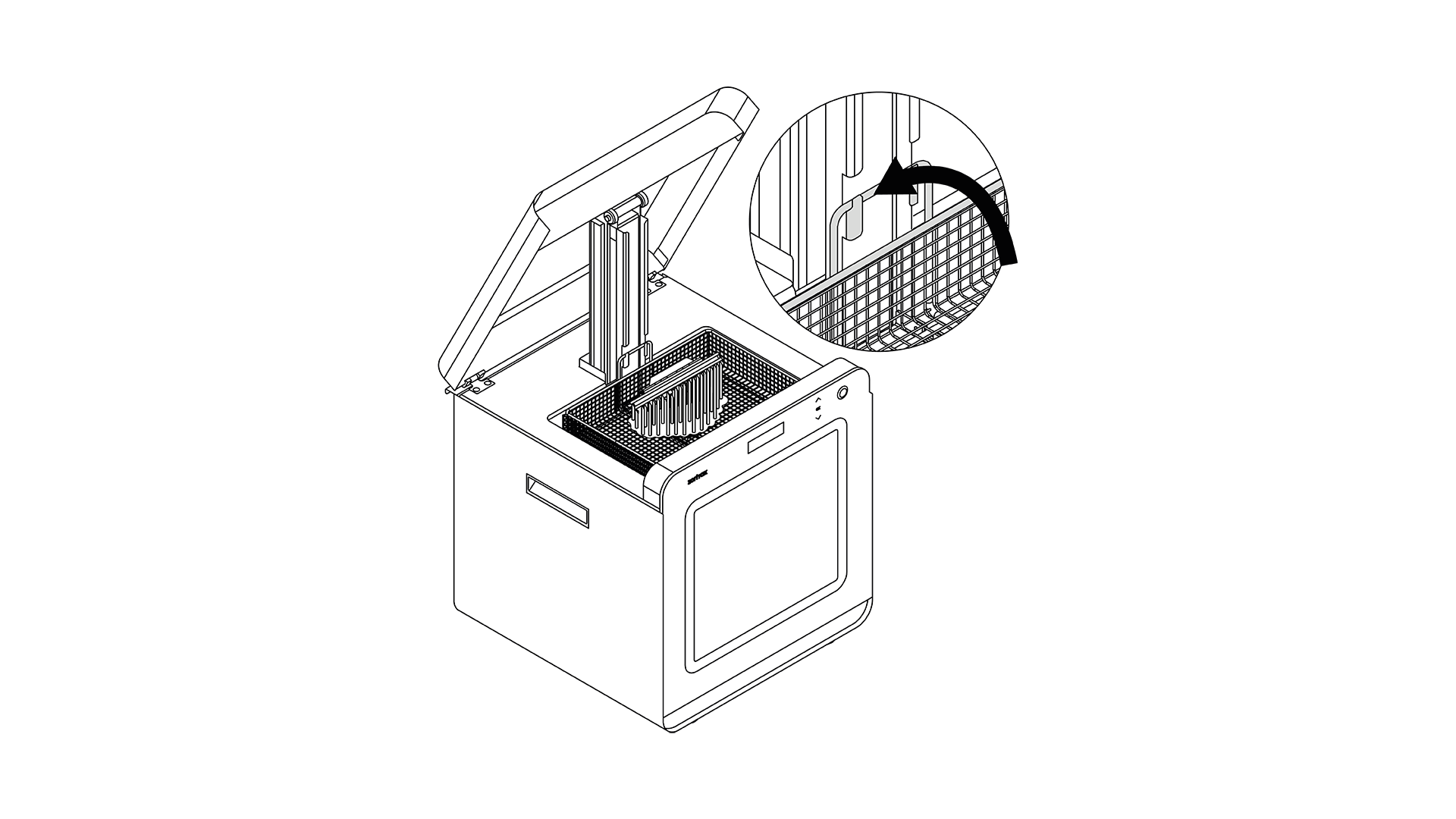

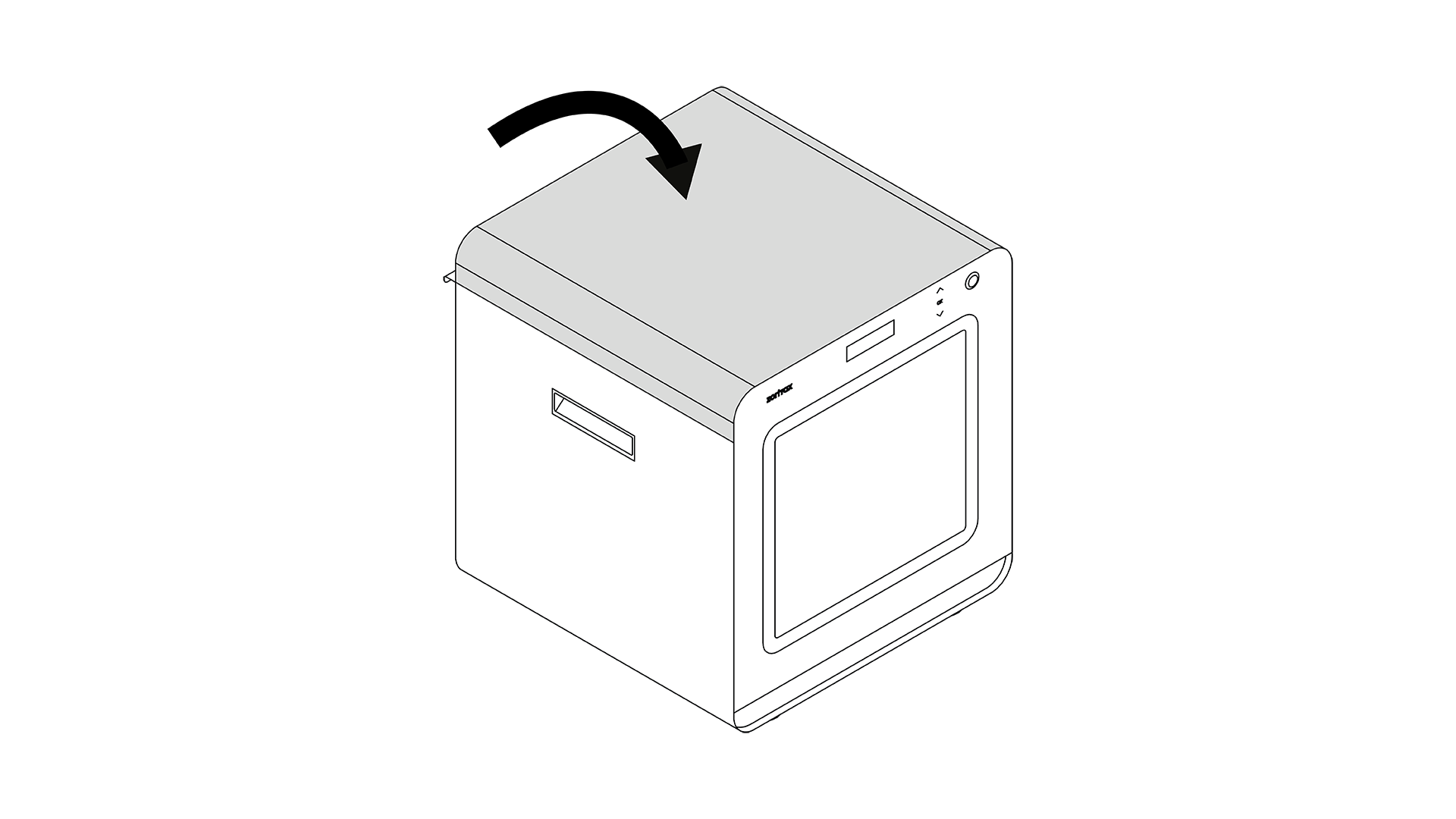

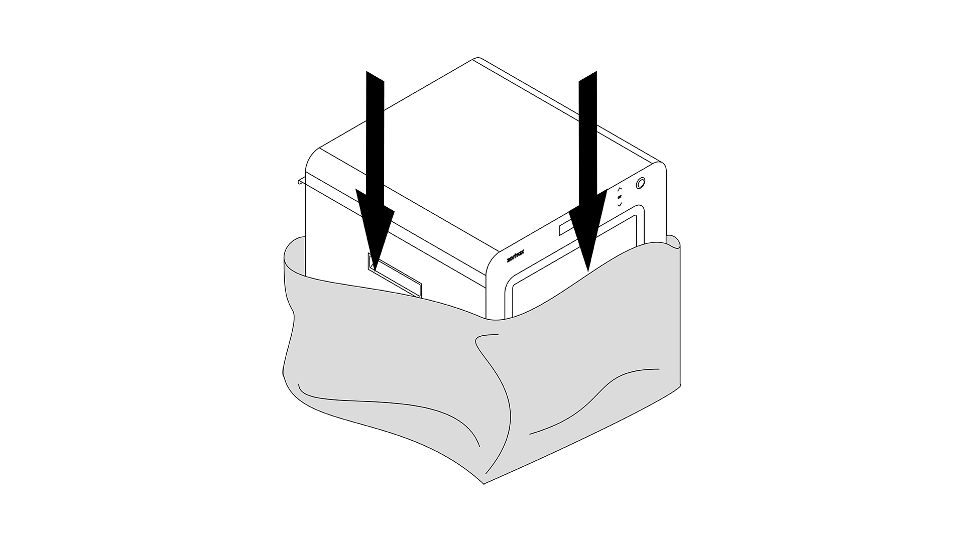

1. Remove the protective foil.
2. Open the top cover.
3. Remove the box with accessories and remove the cardboard protection from the inside of the chamber.

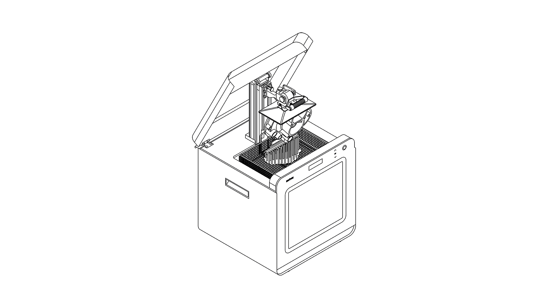

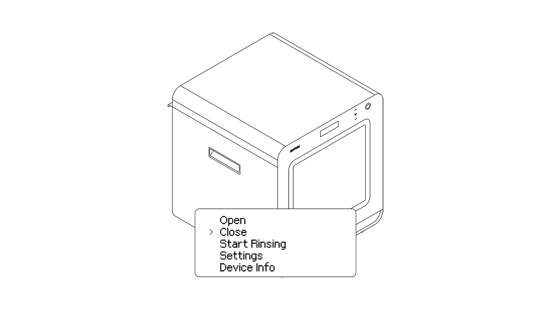

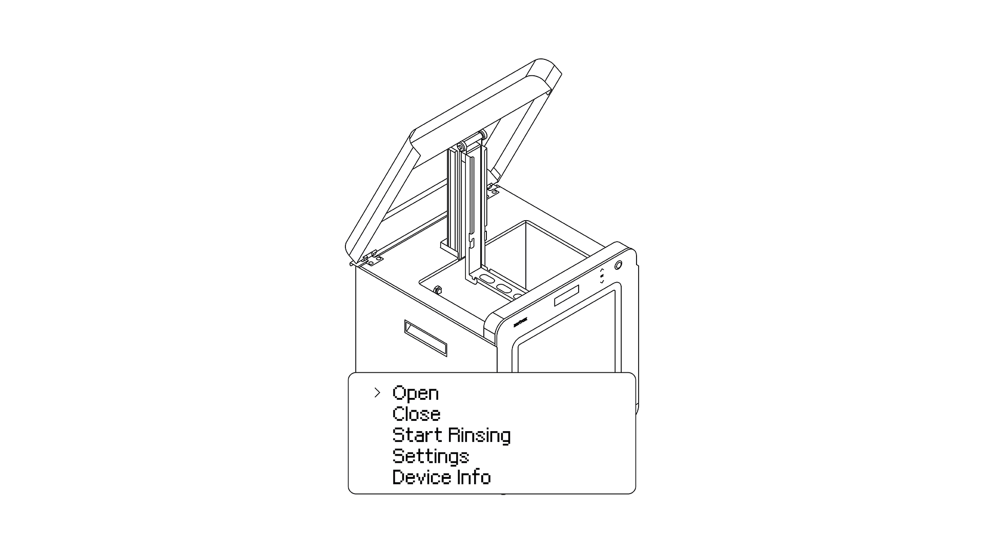

1. Close the top cover.

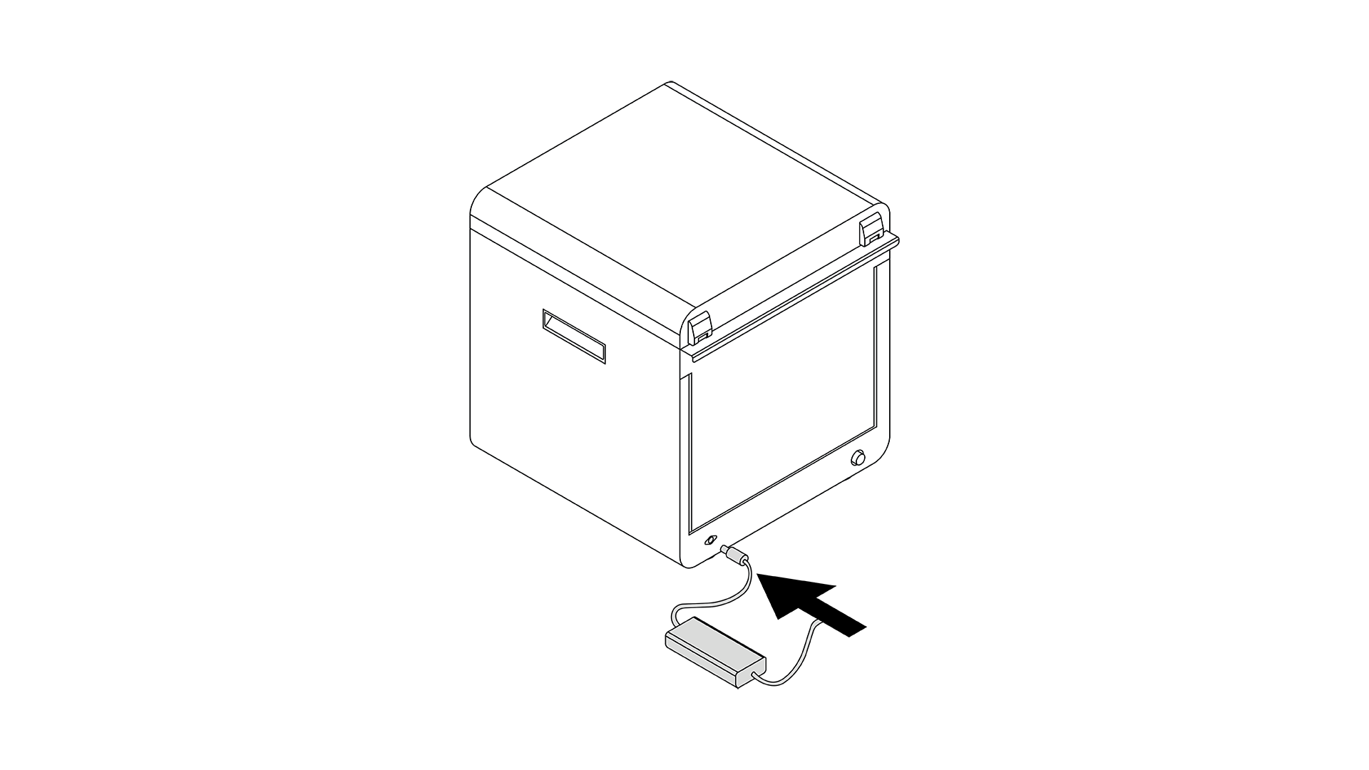

2. Plug the power cable in.
3. Open the top cover using the Open option from the menu.

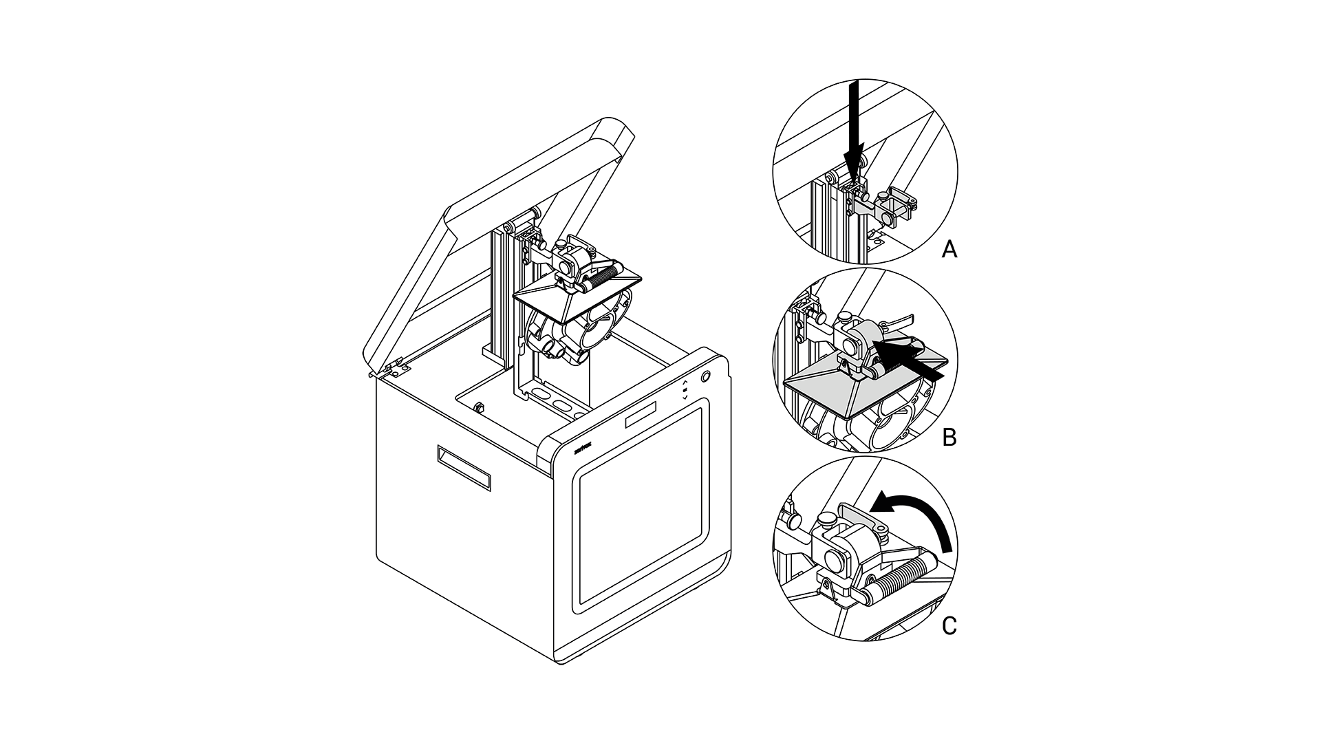

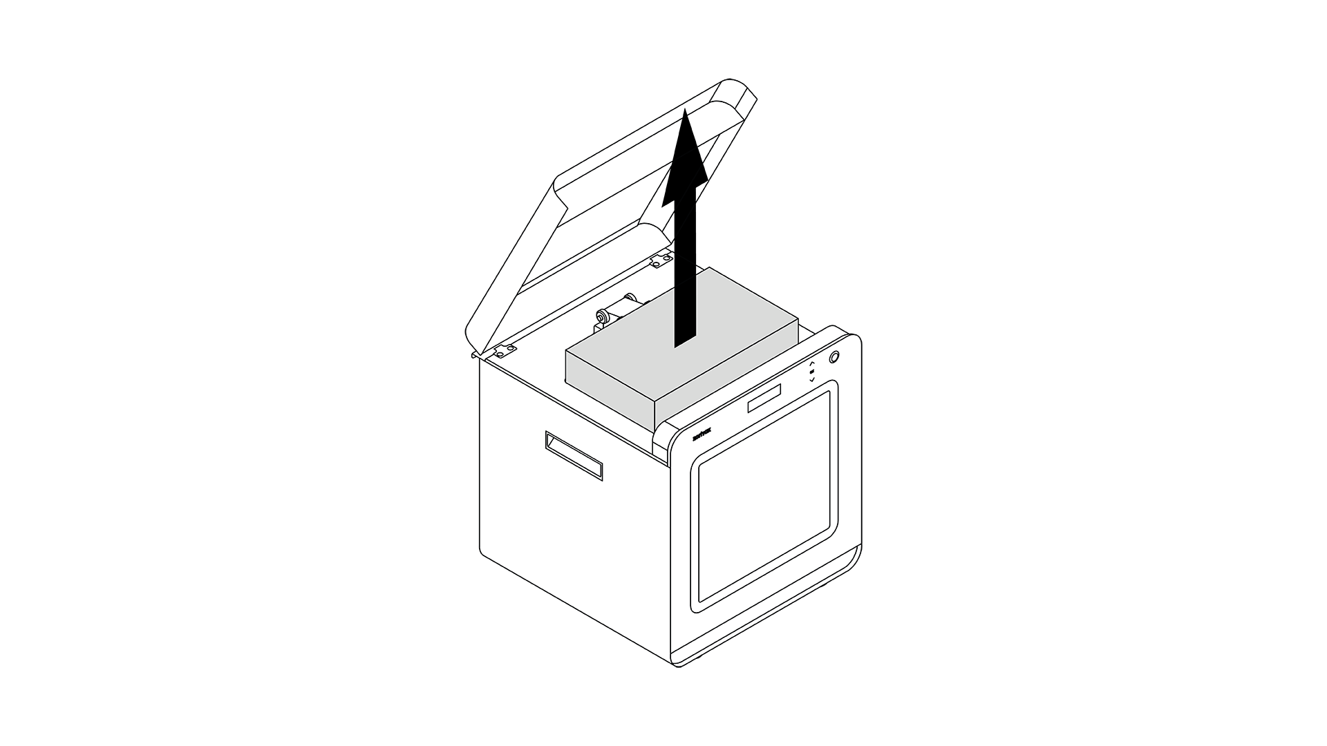

3. Insert the platform handle into the guide and set its height (A). Install the platform with the model in the handle (B) and lock it with the lever (C).
*In the case of models heavier than 0.5 kg (1.1 lb), it is recommended to put them in the basket for the cleaning process as they may fall off the platform and get damaged.

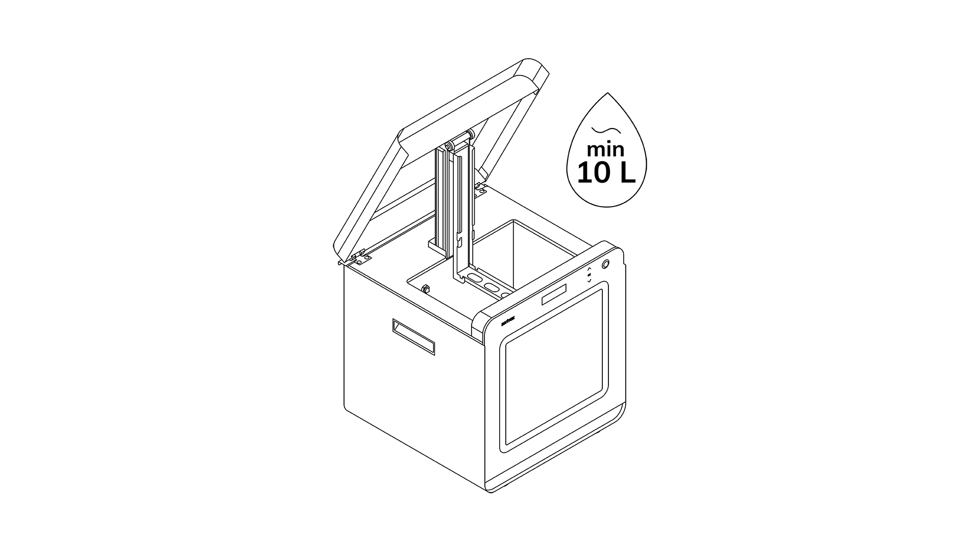

1. Pour the cleaning agent into the chamber - at least 10 liters (338 fl oz) of liquid.

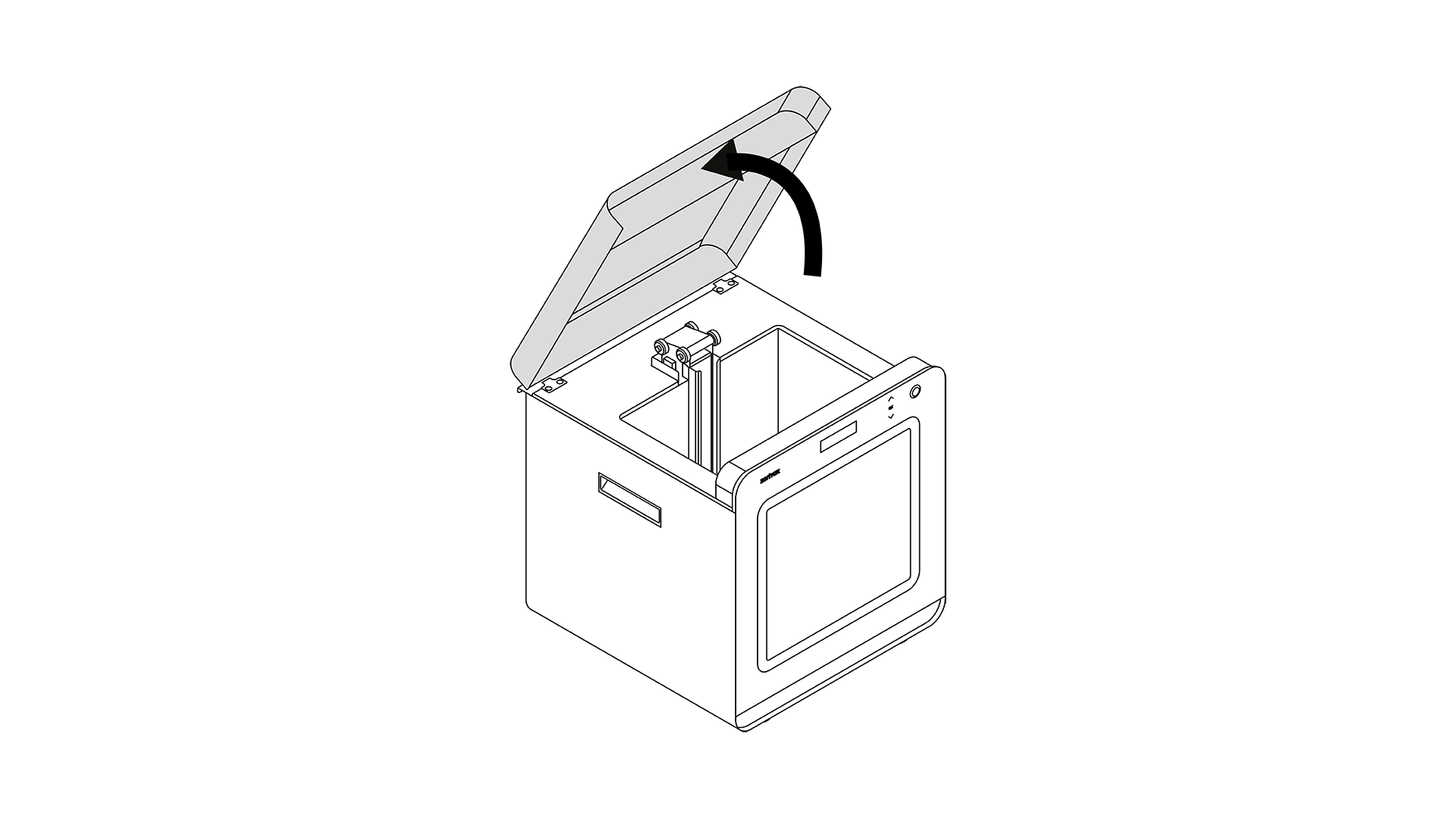

2. Place the models in the rinsing basket. Next, mount the basket on the cutout in the guide.

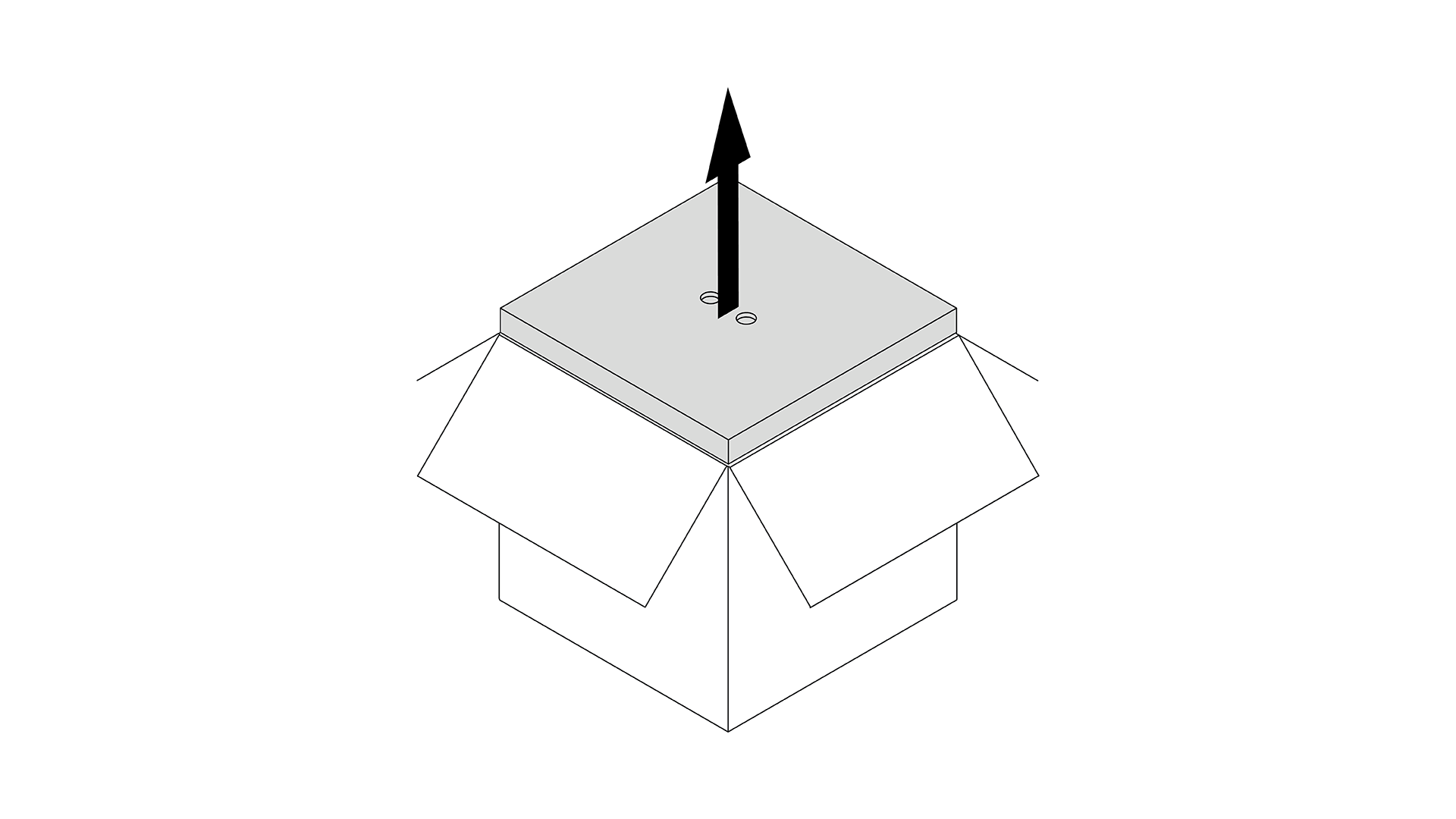

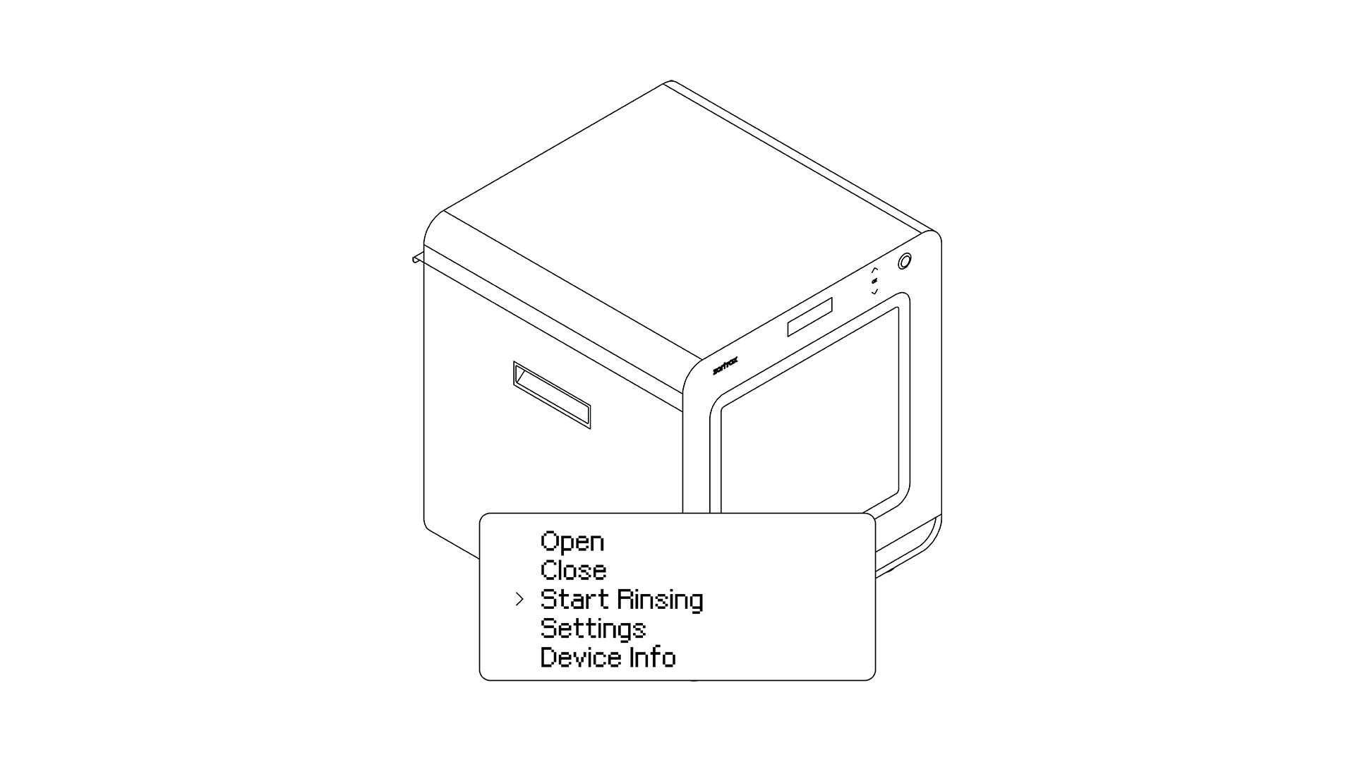

1. Run the rinsing program with appropriate time settings using the Start Rinsing option from the menu.
2. Once the process has finished, the top cover opens up automatically. Wait a few minutes for the cleaning agent to drain from the models.
