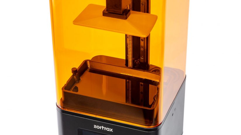

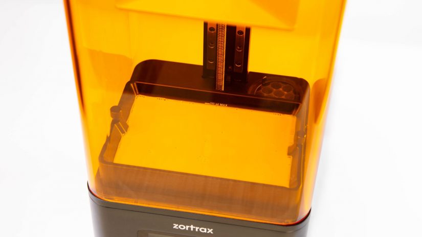

Zortrax resins require special preparation before the printing process. It mostly includes mixing the liquid by shaking the bottle before filling the tank. This especially applies to Resin PRO and Resin DENTAL MODEL as they are both prone to segmentation which can influence quality of prints. Every time you use these resins, you have to mix the liquid in the bottle and make sure that there are no air bubbles in the resin once you fill the tank. Bubbles in liquid resin can make it impossible for the device to print a full raft and, as a result, significantly lower the model’s adhesion to the platform. Follow the instructions from this manual to avoid printing problems with resins.
